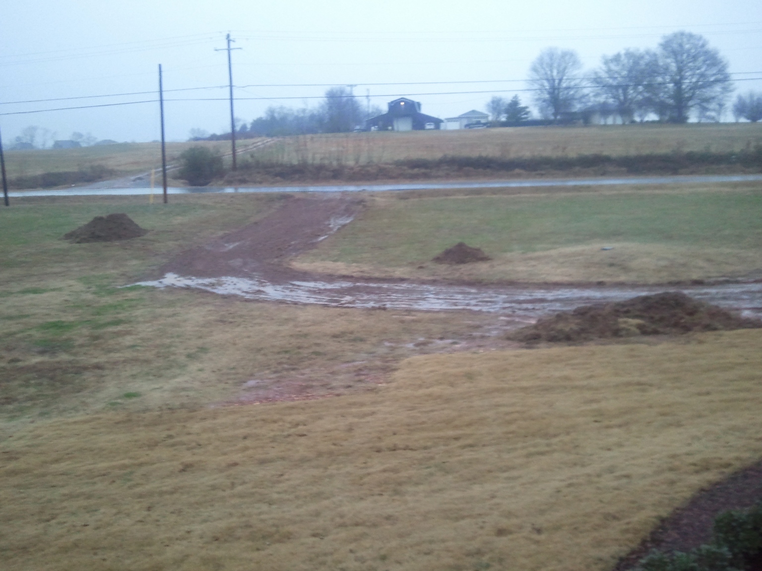

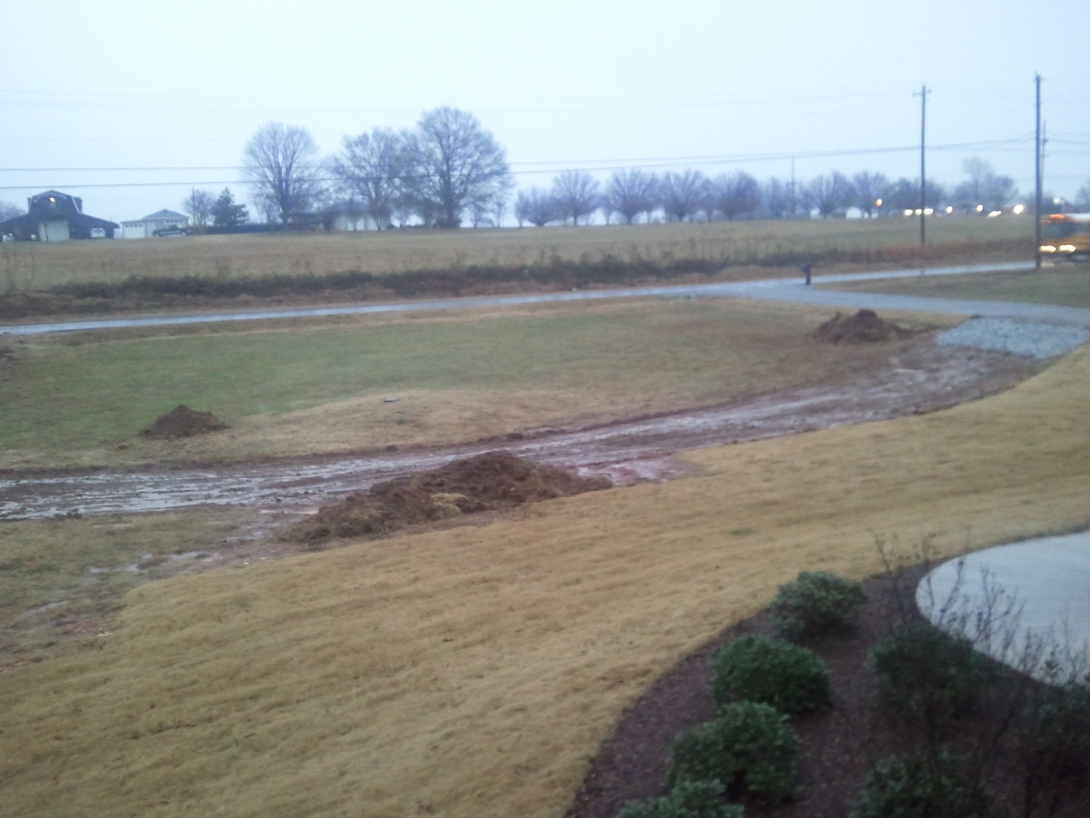

Picked up on this thread this AM, I too am putting in some additional driveway. Anyone got a brand name on this fabric or what type of retailer would carry it?? Very interested in this, and thanks!
Check with your county Soil & Water Conservation Dept. They may have recommendations and local suppliers.
Or your county road department.
