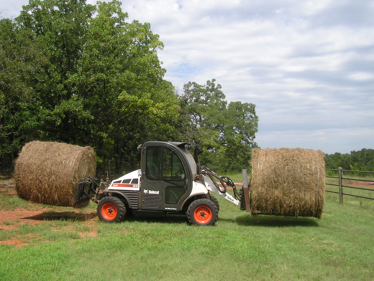

It is a Toolcat 5610, also great for moving 5x6 round bales:
