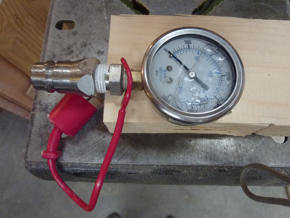

There is no reason it should not work if everything is set up right on your tractor and mower. You have exactly the same remote valve I do and I run a single acting cylinders on both my sicklebar and my dump trailer. The cylinder needs an open vent on the dead side to let air in and out as the rod extends and retracts or it will restrict the cylinder. Look in your manual and check that the hydraulic block that LeeJohn talked about is in the right position. The manual shows how it should be. But if you have a FEL and your 3-pt lift arms work it is probably set right. Get a hydraulic pressure gauge with a QC on it that is good for 3000 psi and check the pressure. ( inexpensive and useful tool) Either port should work. But the active lever direction will change depending on which port you connect to.
EDIT: Source for inexpensive test gauge
Bottom Mounted Pressure Gauges
