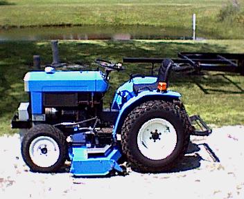

I have no idea how many were actually sold here in the US but I think they were fairly popular . They were sold here in the mid 80's . Parts are available for them but they are quite expensive . I have 2 original sales brochures but don't have a scanner to post them . I think they sold for around $5000 new. I will try to attach a photo of mine for you to get an idea what they looked like in good shape .

Thanks for the picture... What year is yours??
Mine has the big lug tires on it, no belly mower. Just out of curiosity what did the turf tires cost?? I need to put a less aggressive tire on mine.... those big lugs will make a mess out of my lawn.... will be good for the pastures though.
