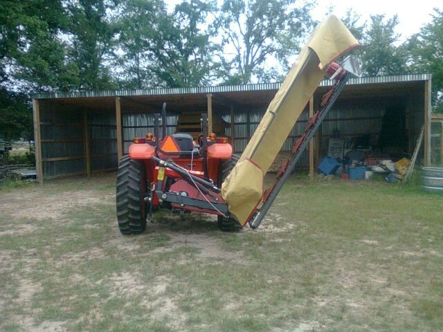

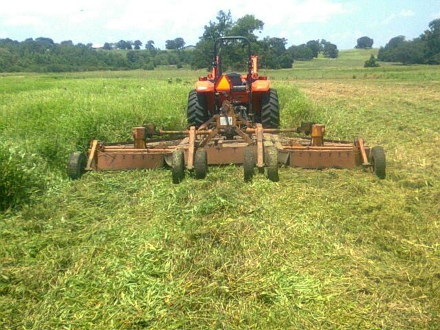

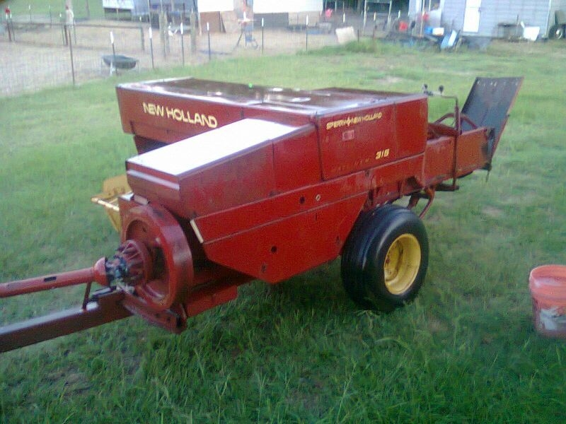

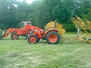

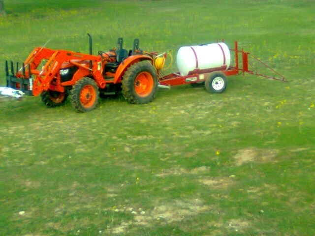

I'll have to take my 2 M's back then(M7040,M5040) haying2.JPG.... Guess it doesnt have the right gear range to pull a 15ft batwing efficiently either(M5040)mwing bottum 3.JPG or run an 8ft cutter(M5040)cutter up all the way.JPGor run the correct speed to spray(M5040)5040&sprayer top view.JPG or the baler(NH 315)squarebaler when picked up and all clean.JPG

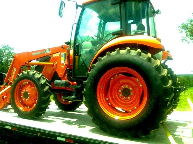

Well I traded the M5040 in today and desided to get another M for Hay tractornew 7040.JPG.
They had a L5740 there that sure was a nice tractor....

Boy that's a good lookin ride you go there. Glad to see you grabbed a cab. Besides the obvious dust and dirt, the hornets have been horrible this year in one of our alfalfa patches. It also enjoyable to hay, when your in the a/c listening to tunes. :thumbsup:
The L5740 is a great tractor! Still kinda want an M. Especially for cab room... Power... better ride... air seat... um yeah sorry. Started to wander there.
