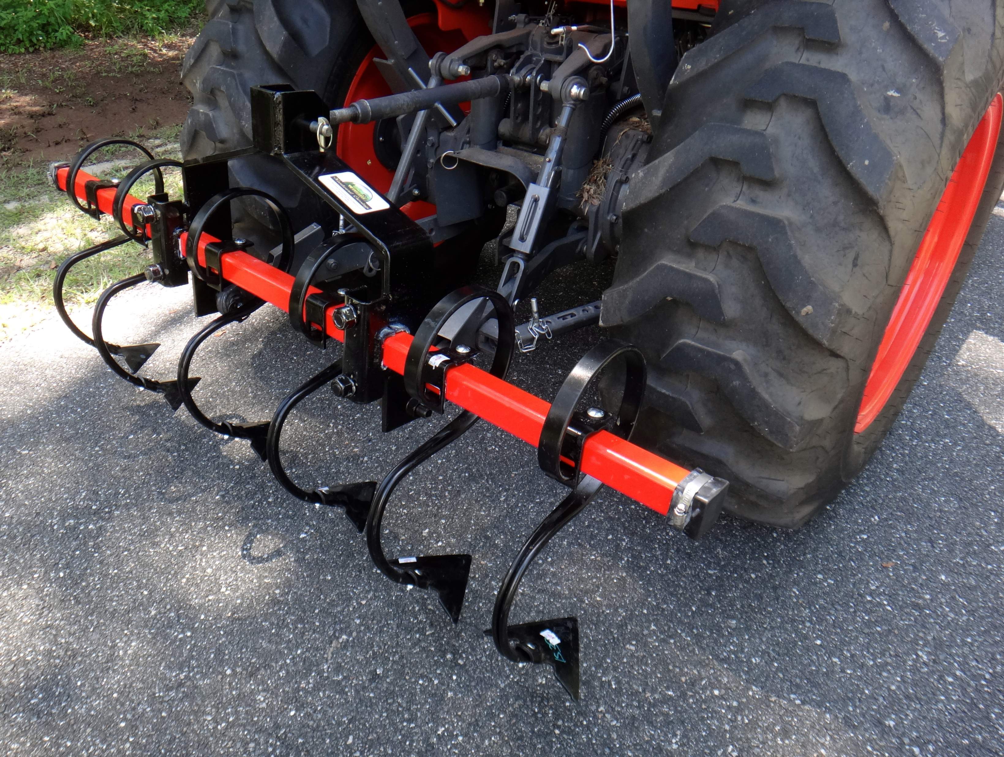

I am looking to tap into all of the knowledge and experience on this forum to help me select the right implements for my Kioti CK3510 to prepare and plant a 5 acre field and two food plot areas about .75 acres, all with red clay soil. The 5 acre field has been in hay for many years, so there will be sod to contend with initially. At first I was leaning towards getting a 60" or 72" tiller, but I am thinking that will take forever on 5 acres. My other thought is to get an S-tine field cultivator and a heavy duty box frame disc in the 5-6ft width range. What do you all think would be best for my application? I'm definitely open to other options too. Thanks in advance for the feedback!

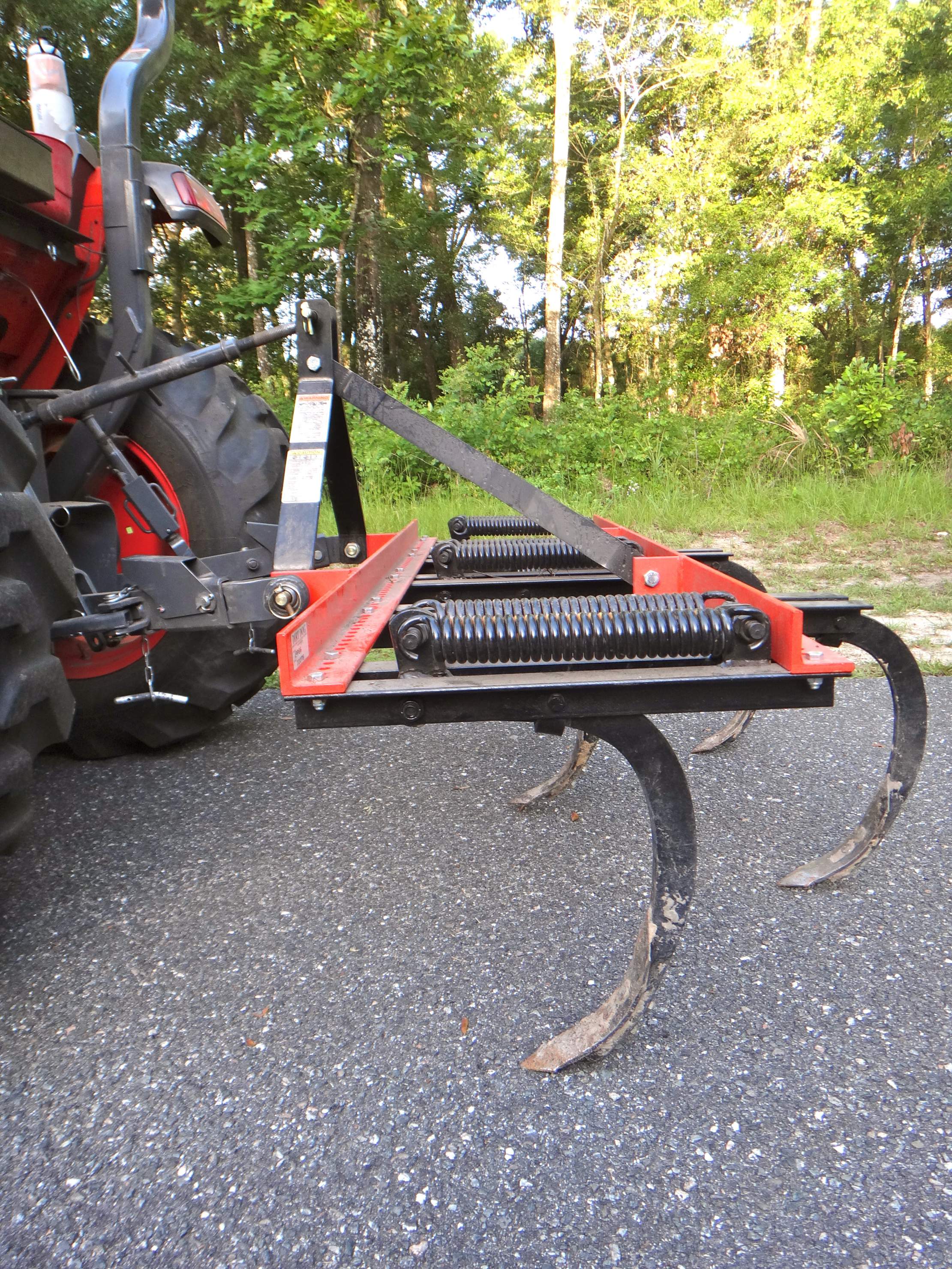

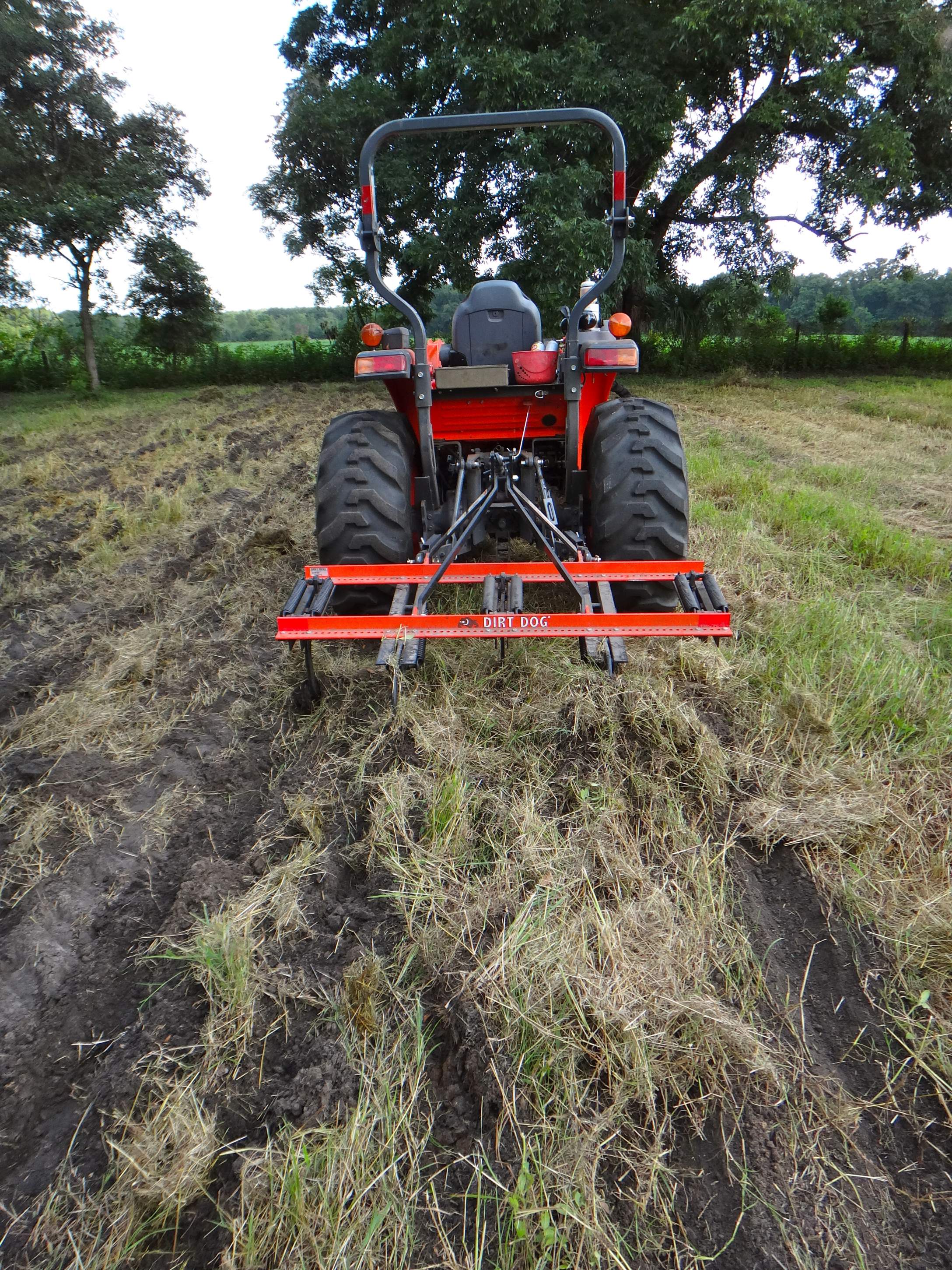

My second thought is to get an S-tine field cultivator and a heavy duty box frame disc in the 5-6ft width range.
I have years of experience with a spring-protected Dirt Dog (brand) Field Cultivator, which is orders of magnitude tougher than S-tine "Danish" cultivator, which I also use. Neither a spring-protected Field Cultivator with points (PHOTOS #1 and #2) nor an S-tine cultivator with shovels (PHOTO #3) or points will penetrate animal compacted sod in soft, Florida sandy-loam. The weaker S-tine cultivator will bend tines, break brackets or break clevis bolts in the attempt. Ask me how I know.
A spring-protected Field Cultivator with points will penetrate uncompacted, MOIST, Florida sandy-loam in grass 12". (PHOTO #2)
For a CK3510 I recommend a five tine spring-protected Field Cultivator. You may find it necessary to remove one tine the first time you cut sod to maintain traction.

CK3510 is around 3,000 pounds, bare tractor. Only enough weight to pull a box frame Tandem Disc Harrow with pans 18" in diameter which will require multiple passes over the land to scuffle the top 2" to 3".
Go for the tiller. It will do the complete job for you.
In sod the other equipment might be a little much for your tractor unless you start with a plow.
If you buy a heavy, forward rotation PTO-powered rototiller, preferably with 'C' shape rather than 'L' shape tines and wait for moist soil, it will do the job. Ample tiller weight is important as field size increases, so one pass will till to adequate depth.
As Egon states, plowing first will speed tilling. Plowing would be optimal primary tillage for your commercial field. Unnecessary for food plots. Food plot seeds are eager germinators.
PLOW VENDER: Everything Attachments 12 Inch Double Bottom Plow
