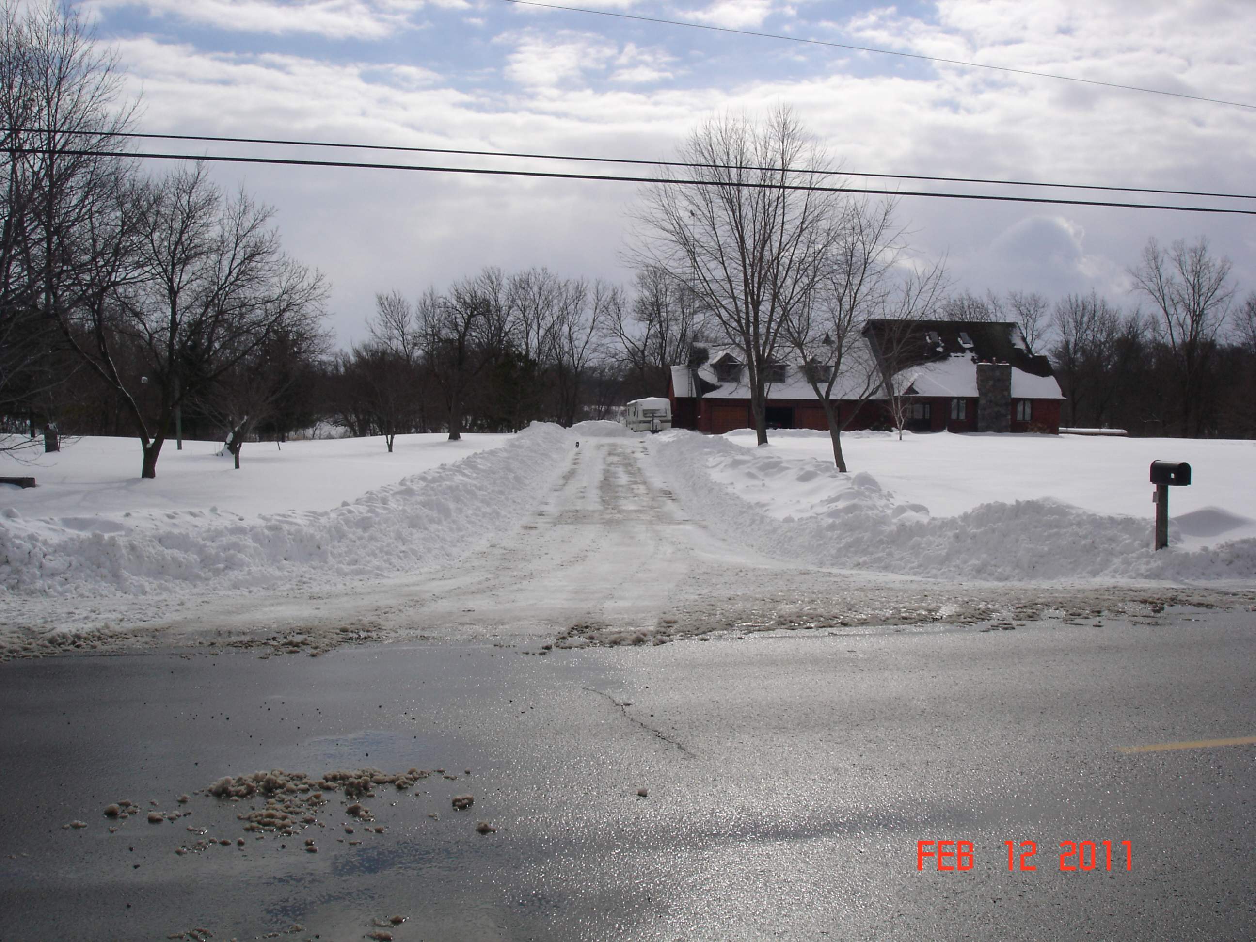

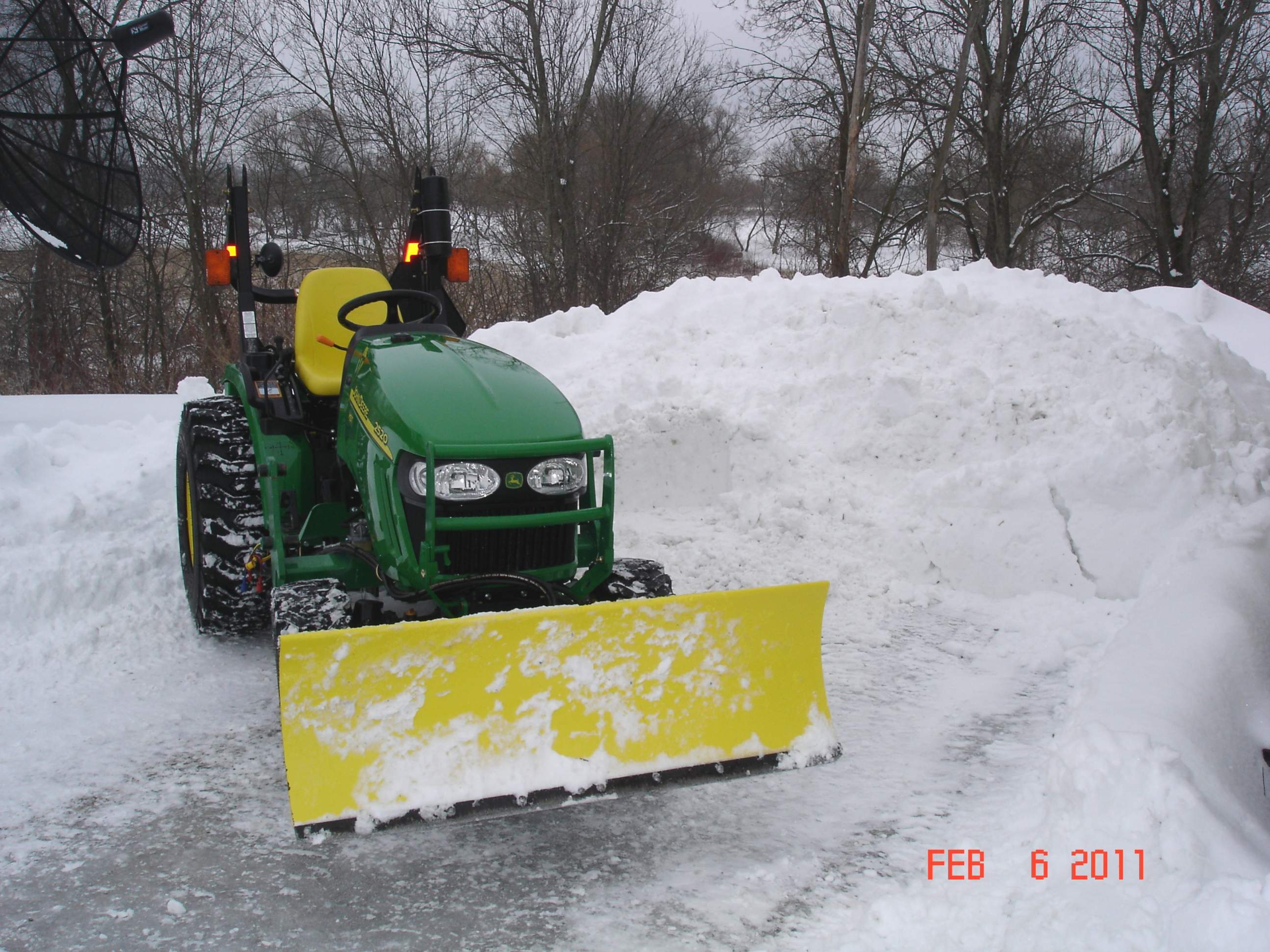

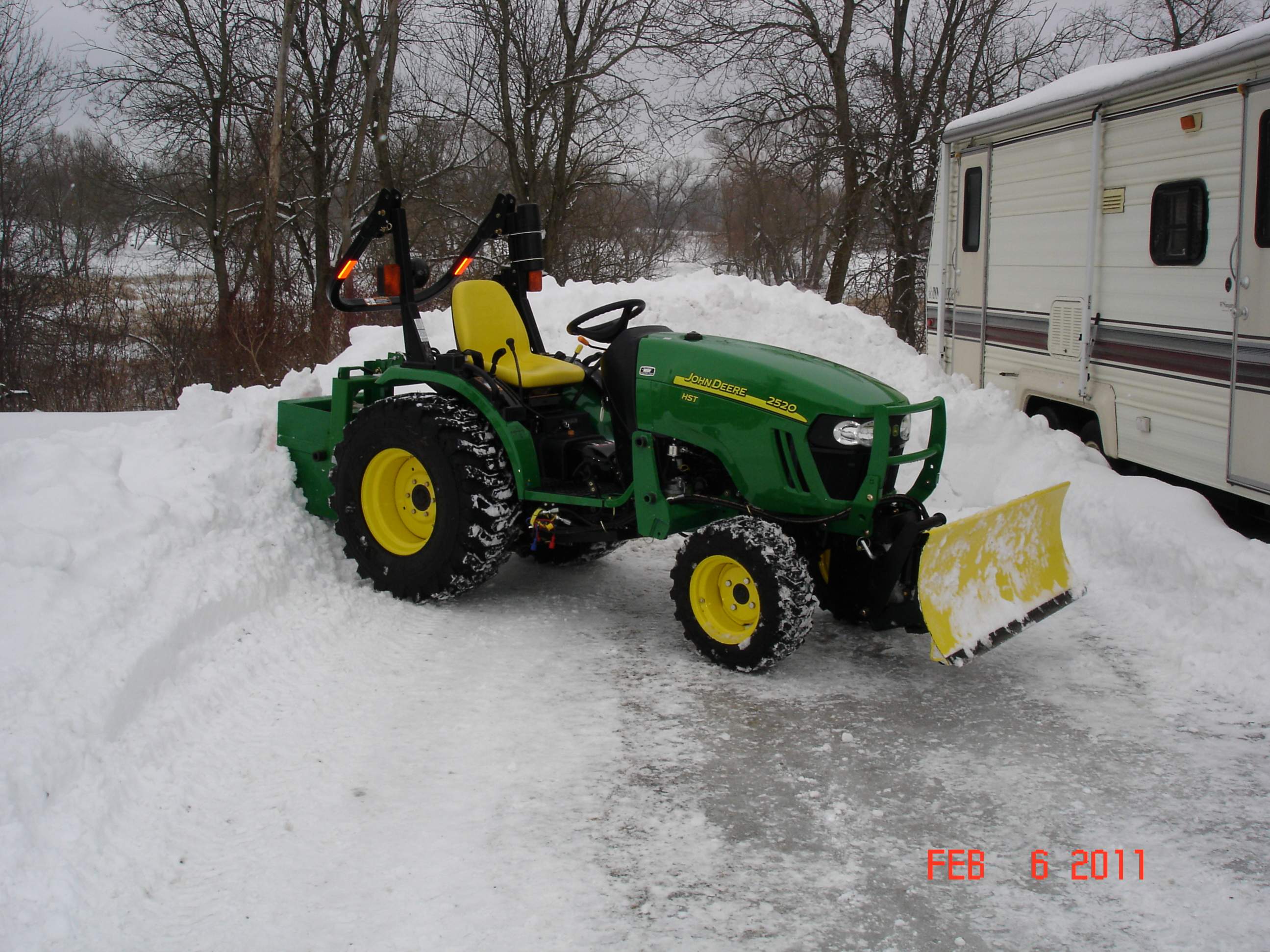

As I said in my previous post, make sure you get a ballast box for the new rig. For the couple of hundred dollars it costs, the added traction benefit when plowing snow is, in my opinion, simply amazing. I actually tried plowing the first snowfall without the BB on, and after I did put it on, I really never would have believed the difference if I hadn't seen it for myself.
Here's a couple of pics of my 2520 with the ballast box and blade, after a snowfall last year. As you can see, the banks are pretty much 5 feet high, I certainly was impressed.
