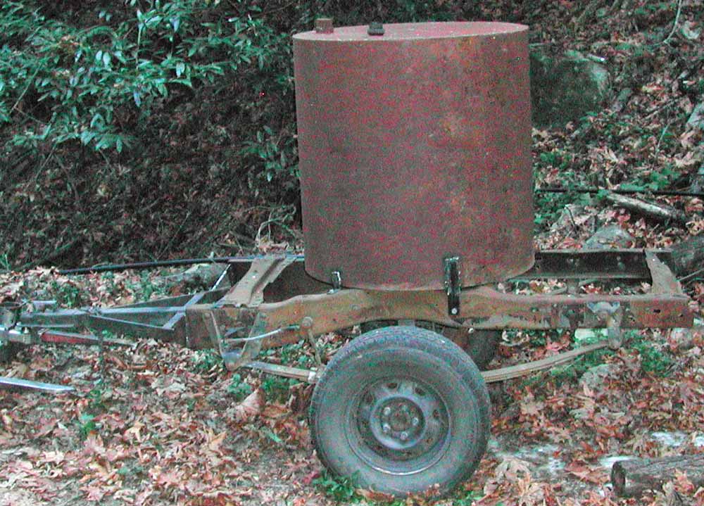

   / Help small dump trailer design: safe? #18
Will the center of gravity be too high?
Since you want to use the trailer on the road as well as the trails, maybe as fast as 55mph,
consider:
You can compensate for high COG by using sway bars, or starting with a PU truck
rear frame. Shock absorbers help here, too. Most trailers have neither. Trailer
tires work better than truck tires, too, due to the stiffer sidewalls.
My tanker trailer below has high COG, but it is built on a Ranger rear half, with the above
features. It also has brakes, but they are not connected. I know it does not dump,
but the estimated empty weight is 800#, and 150 gal of water pushes it to 2000#.
BTW, I also stole the Ranger's bed for the dump box base on my Suzuki Samurai dumptruck.
