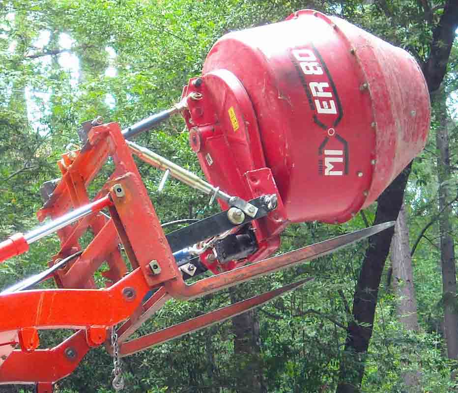

I am contemplating a remodel of my 3 pt hitch concrete mixer to mount on my FEL using a quick attach.
What size of hydraulic motor would run this if mounted as stated and ran off either the rear remotes or possible a set of add on electric remotes?
The mixer is a chain drive off the PTO shaft.
Thanks
Jeff

These charts will get you started. Need to know the hydraulic flow of you tractor. The hydraulic psi will help determine the hp/torque.
Hydraulic
If you are using a chain and sprockets, then you will need to calculate the speed based on sprocket sizes. That is another whole level of calcualtions. If your current drum is run off the pto, then you know the motor speed will be up to 540 rpm. You will probably need a variable rate flow control if you need to change the speed of the motor.Surplus Center - SAE 12 HYD FLOW CONTROL VALVE RD112-30
Something like this may work if you use a pto now. Surplus Center - 6.15 CU IN PTO DRIVE MOTOR

dfkrug; How were you able to obtain your tractors pump flow rate at idle, is is stated somewhere or is there a way of calculating it?
My mixer has a 10:1 reduction using a chain and sprocket drive off the PTO shaft input.
I plan on connecting the hydraulic motor to the mixer input shaft which is drilled for a shear pin with a collar that is keyed for the hydraulic motor output shaft and drilled for the mixer input shaft.
Thanks
Jeff
/ Help specing a hydraulic motor. #12
Jeff, your implement pump is rated at the 540 PTO engine speed, so if that is
say 2200RPM, you get half that flow rate at 1100 RPM. The relationship is
linear, so you can calculate the flow rate at any RPM, if you use the
spec for your pump.
In my case (Kioto CK30), you can only get the spec (8.3GPM) from
the service manual.
I assume you are using the Mahindra for this effort. Note that even at
idle engine speed, these PTO mixers run a bit too fast, in my experience.
You can correct that if you choose a hyd motor displacement that slows
things down a bit.

Thank you Sir, I was thinking along that line but was unsure about the gpm being linear across
the engine rpm spectrum.
So I'm looking at roughly 3 GPM at the 800 RPM idle speed of my 4110.
Again thanks.
Jeff
