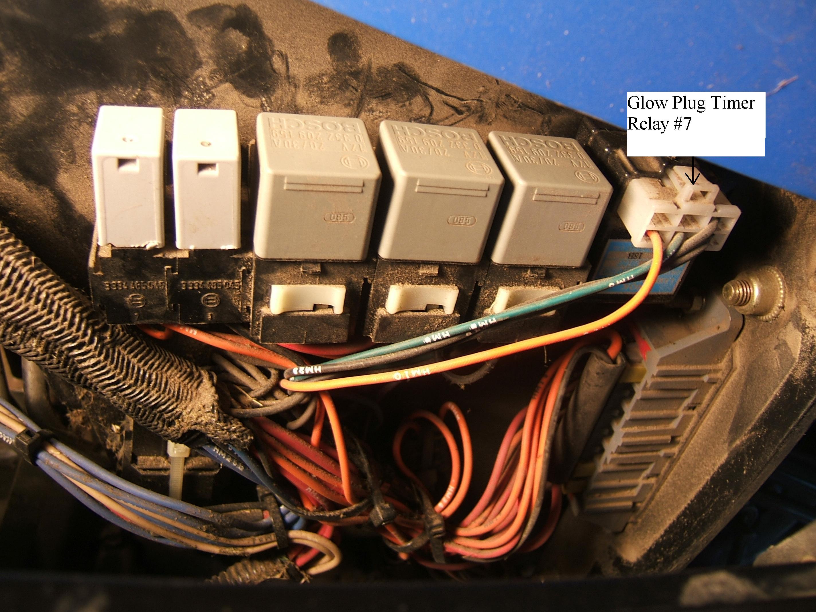

I believe I have isolated the problem to the Glow Plug Timer Relay #7. I have bench tested the relay several times now and it works fine. However, I believe the problem lies with a wire (possibly HM10) connection between it and the Glow Plug Power Relay #3. As you can see in the attached picture the wires are really being stretched from the harness to the white connector on the timer, this might be the problem. Does anyone else's wires look this tight?
I know there has never been any work done on my tractor so it must have come from the factory like this. When you first turn the key switch, the timer is supposed to come on for 5 seconds and send power to the coil of Relay #3 allowing the glow plugs to power up. I believe it's this connection between Relay #7 and #3 that is my missing issue. When you turn the key further to engage the starter the power to the coil for Relay #3 comes through the Neutral Start Relay #1.
While I will not be able to troubleshoot the problem for another week since I'll be out of town I hope to get back to it shortly. I'll let you know what I fine out.

Looks like it is time to see if that wire(s) has an internal break.. IE.. unhook it and see if it gets power when it is suposed to. if so.. try to give it some strain relief and see if that helps.. if so.. might be a contact issue witht he strain on the plug.. etc..

Well, I just wanted to give an update since I have now had another chance to work on my Glow Plug issue. I was able to loosen the wires going to the glow plug timer by disconnecting the connector and feeding it back through a few wires freeing up some space. However, once I did this I plugged it back in, turned the ignition switch to the first position and still no glow plugs. I then searched for a loose connection but cold not find anything that looked obvious so I put everything back together bolting the shrouds back on because I had to get the grass cut. Once I got everything together I go to start the tractor and what do you know, the Glow Plug light is coming on with the first turn of the ignition switch. I still intend to replace the ignition switch, but I sure wish I had been able to find the issue when the weather is nice. I can now see myself doing this all over again in about 4 months when it's 20 below and the west wind is howling at 30mph and I'm knee deep in snow.
