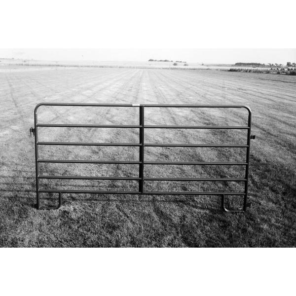

Rambler, the panels he was talking about using are the corral panels like this one from Tractor Supply. I was thinking, like you were, of using the wire feedlot panels. They cost in the $20 - $30 range in this area.

Correct, I was talking about the steel pole livestock panels at Tractor Supply, which are about $55 each, not the heavy gauge wire cattle panels which are 16ft. and $16 but need additional support to be used for my purposes. Check steel/pole prices due to China's insatiable demand and you will understand why <new> livestock panels are $60 and up now.

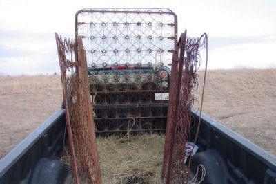

Here is a set of "Redneck Stock Racks" I used to haul goats home from Missouri (about 220 miles) in the back of my F-150. Worked pretty good and was dirt cheap! We tied the goats to the front and tied the backends of the bed springs together. Worked great!
