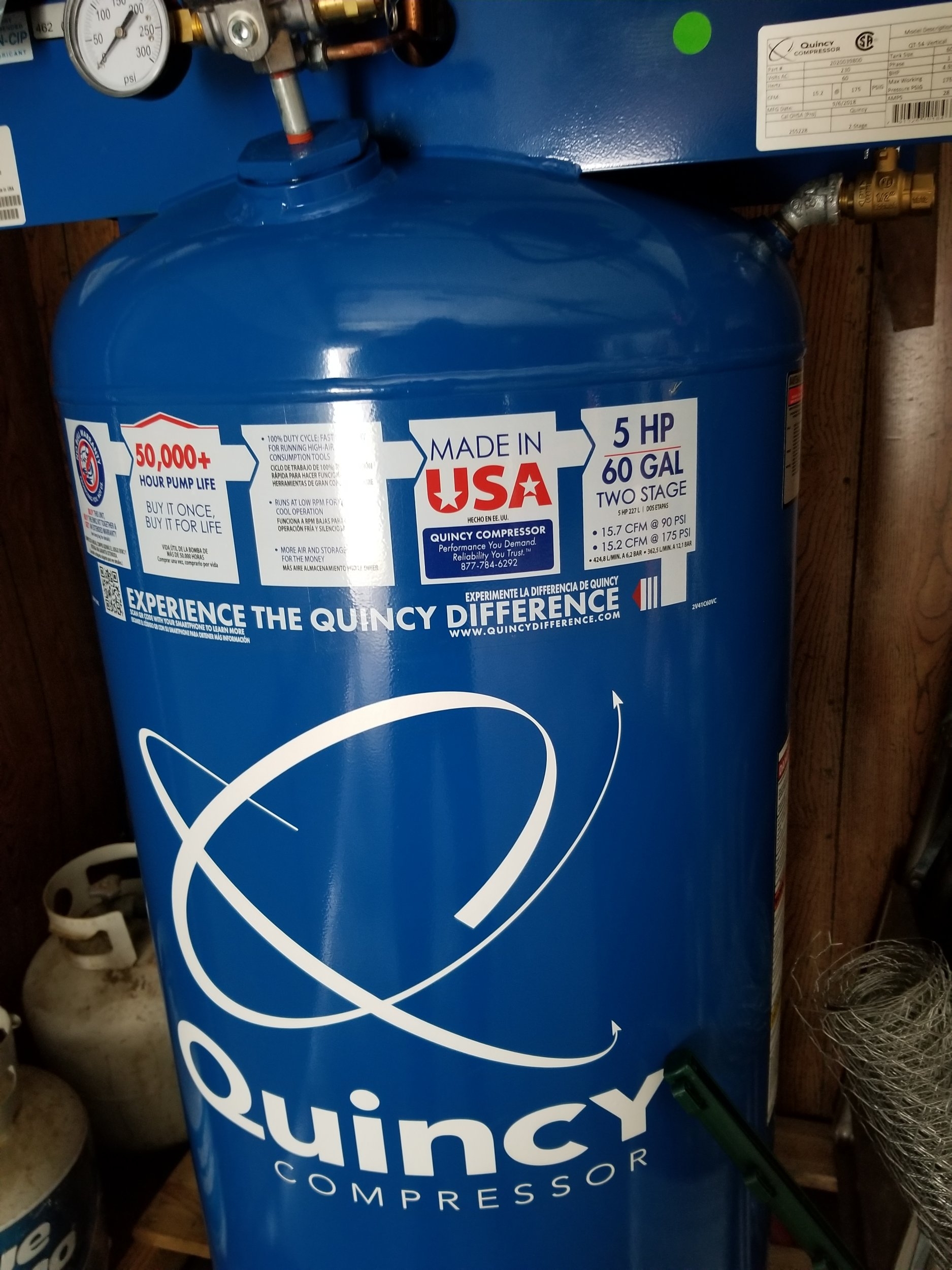

I wouldn't get too worked up over the duty cycle. If you match your compressor stats properly to the tools you intend to use on it, it won't be a problem. My Quincy (albeit, larger than what you're looking at) almost never comes on. When it does, it's not on for very long. Using a constant demand tool like an air sander, or air grinder, will be harder on a compressor than and instant demand tool, like a nail gun, or even an impact wrench (proper sized impact to the size bolt/torque you need).
When I'm sanding a large piece, then yes my compressor comes on more often. But I'm not giving the air sander any down time at all, but running it for many minutes straight. When the compressor kicks on, it overcomes the tool demand and still has enough grunt to refill the tank and kick off again.
Cfm trumps all. Psi is almost meaningless, as about any compressor can "make" psi. If your compressor will "make" 100 psi, that's usually plenty. But it's the cfm that does the work. And it needs to be the cfm at tool-needed psi. Most common tools run between 90-100 psi. So a cfm rating on a compressor at 40 psi means nothing. What is it's cfm at 90? At 100? That is what matters. It's easy for a compressor to "make" cfm at low pressure. It's much harder for a compressor to "make" cfm at tool working pressure. Cheap compressors struggle with this.
Tank size helps with constant demand tools (like sanders/grinders). The bigger tanks can go longer between needing to "call" the compressor for more air. But having a compressor rated with enough grunt (cfm) to not only fill the tank, but also run the tool at the same time, is a boon. That means you are not stopping (ever) to let the compressor "catch up" to your usage.
Love my Quincy:

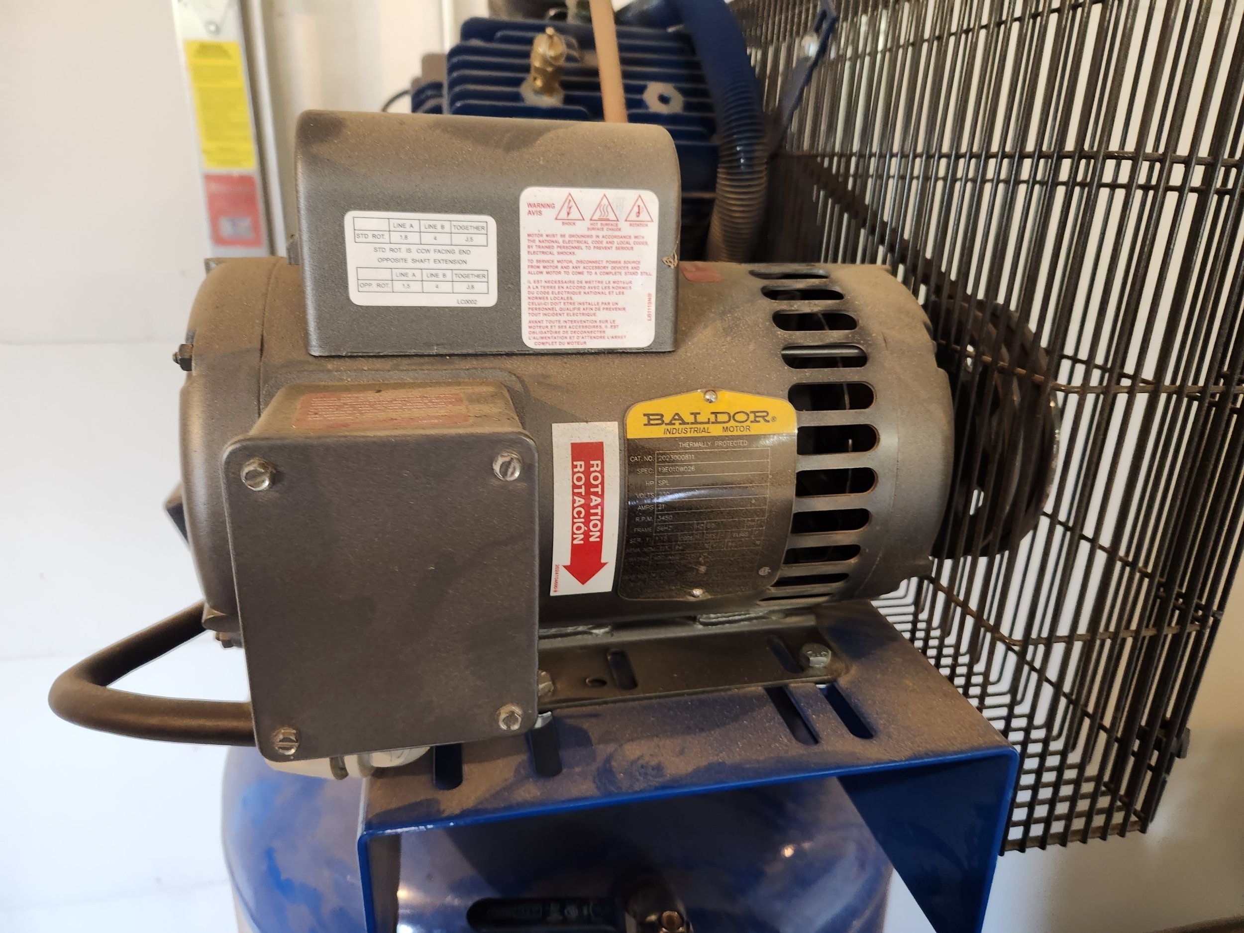

Were you lucky and got one with the Baldor before they switched?
