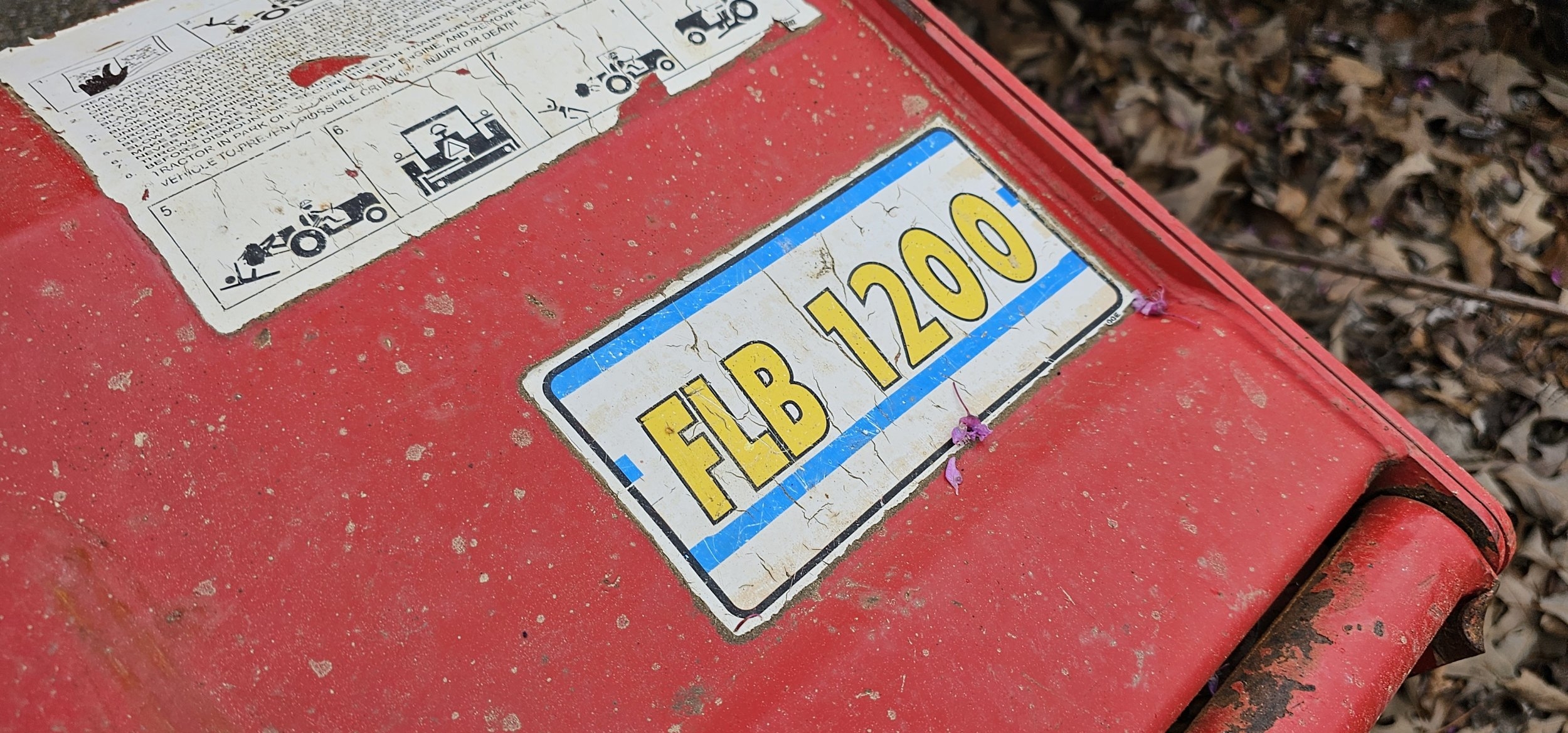

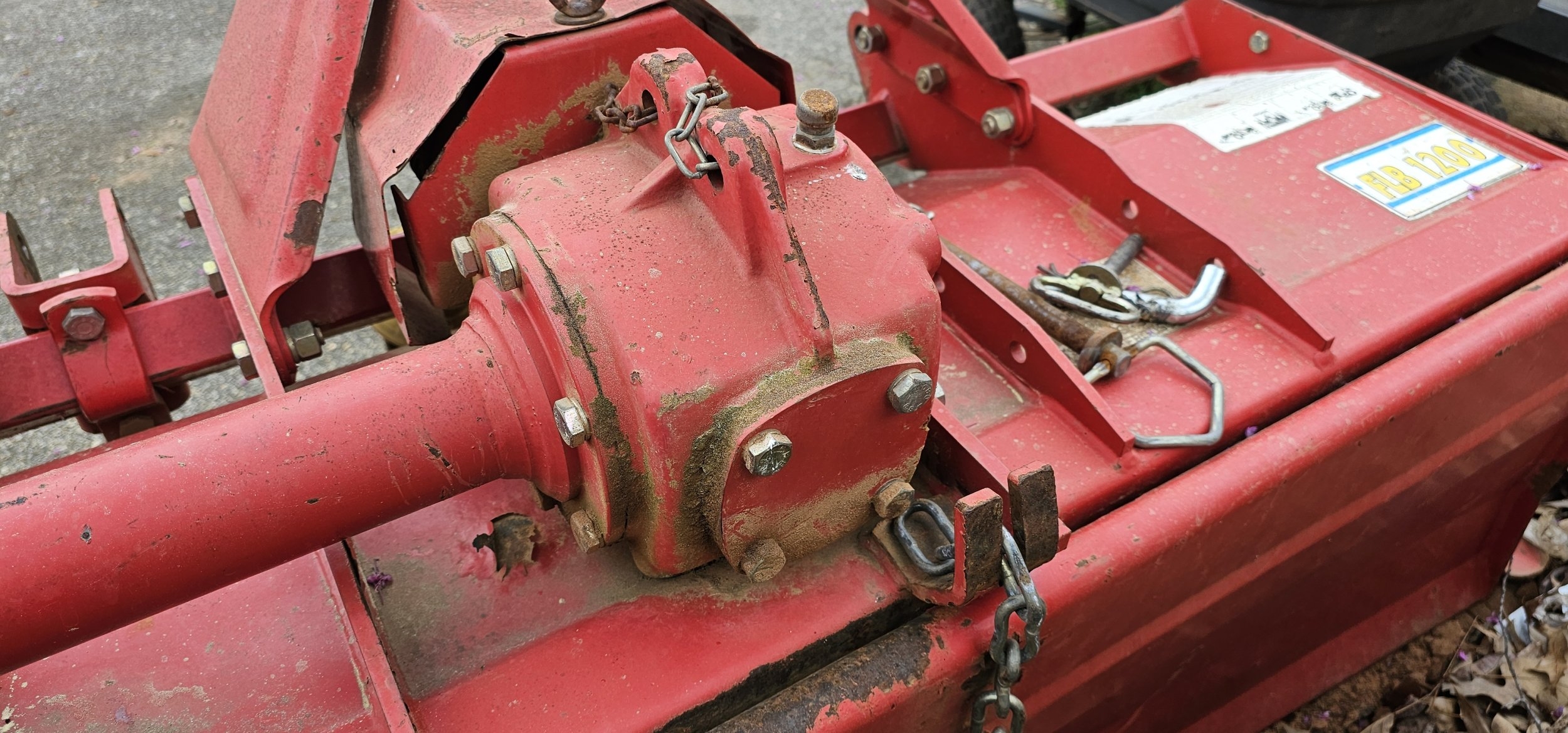

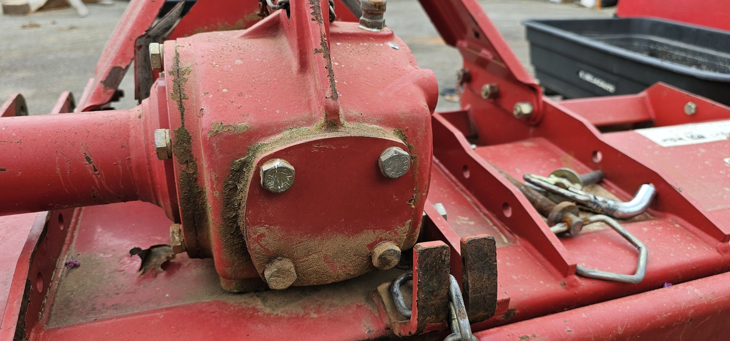

pics of my tiller (FLB 1200)

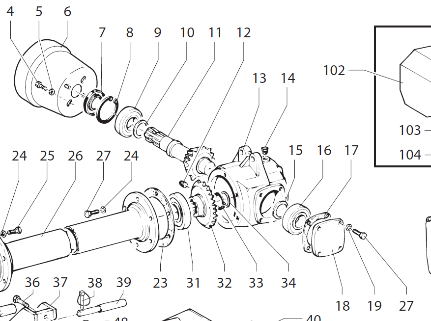

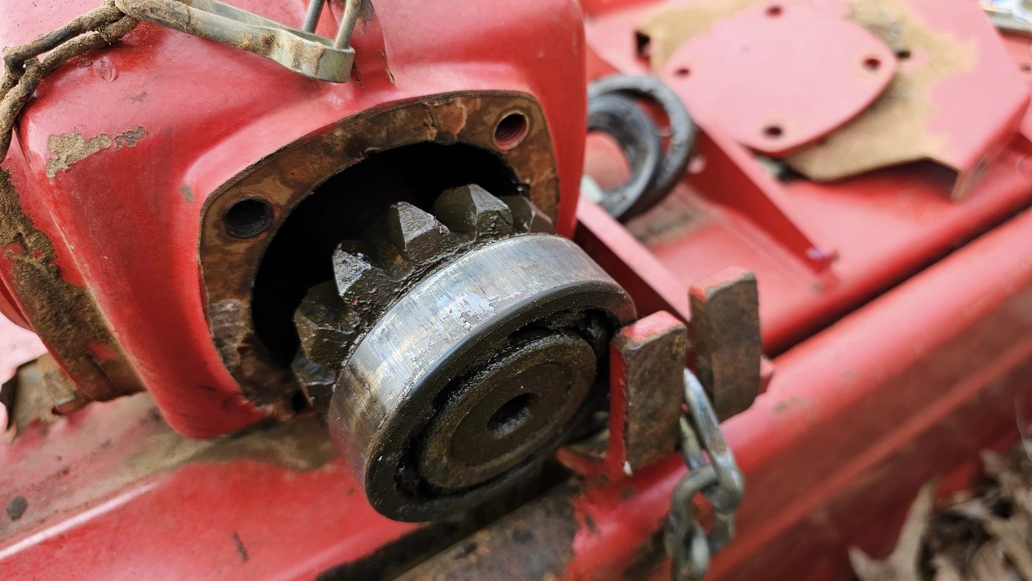

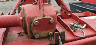

More pics, I have to replace a couple of bearings.
Diagram number
WAC Secma #
Quant
Description from Adria
Description Italian
7​
6203572​
2​
seal​
Oil seal ø 35x72x12 PP​
9​
2106207​
1​
bearing​
Bearing 6207​
10​
4138796​
1​
spacer​
Spacer ø 35​
14​
3442014​
1​
oil filler cap​
Plug M 14​
15​
4598808​
1​
spacer​
Spacer​
16​
2106307​
1​
bearing​
Bearing 6307​
17​
4788793​
1​
rear plate gasket​
Gasket​
