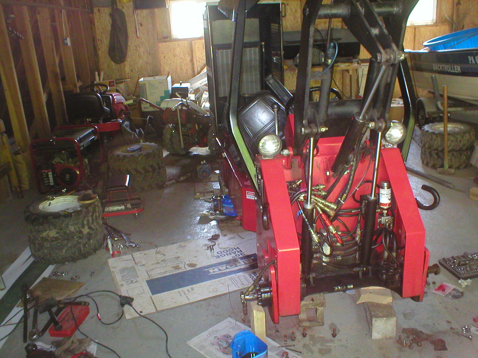

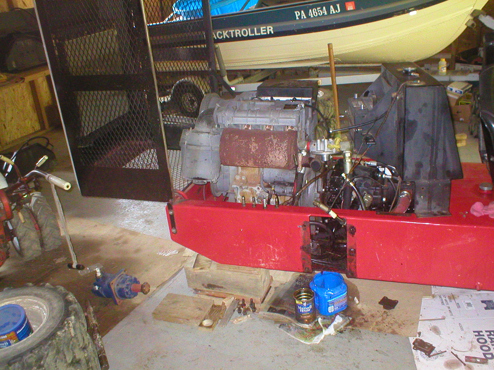

Just an update on my 1845, I removed all the hubs, took all brake pads off , removed rear wheel motor , removed brake tender and accumulator. I am planning to stop at Tazewell next week on my way home from my sons and have brake tender and accumulater checked and have seal replaced on wheel motor and picking up necessary parts. I am attaching some pictures if they work.

It looks like there is an accumulator visible in the front view. If I am correct the location on your machine is different than machines built later. On mine, built in 2002, the accumulator is located on the rear frame wall.
/ Help with 1845
#17
Yes the accumulator is located on the front right in front of the brake tender. That picture was taken before I removed the brake tender and accumulator.

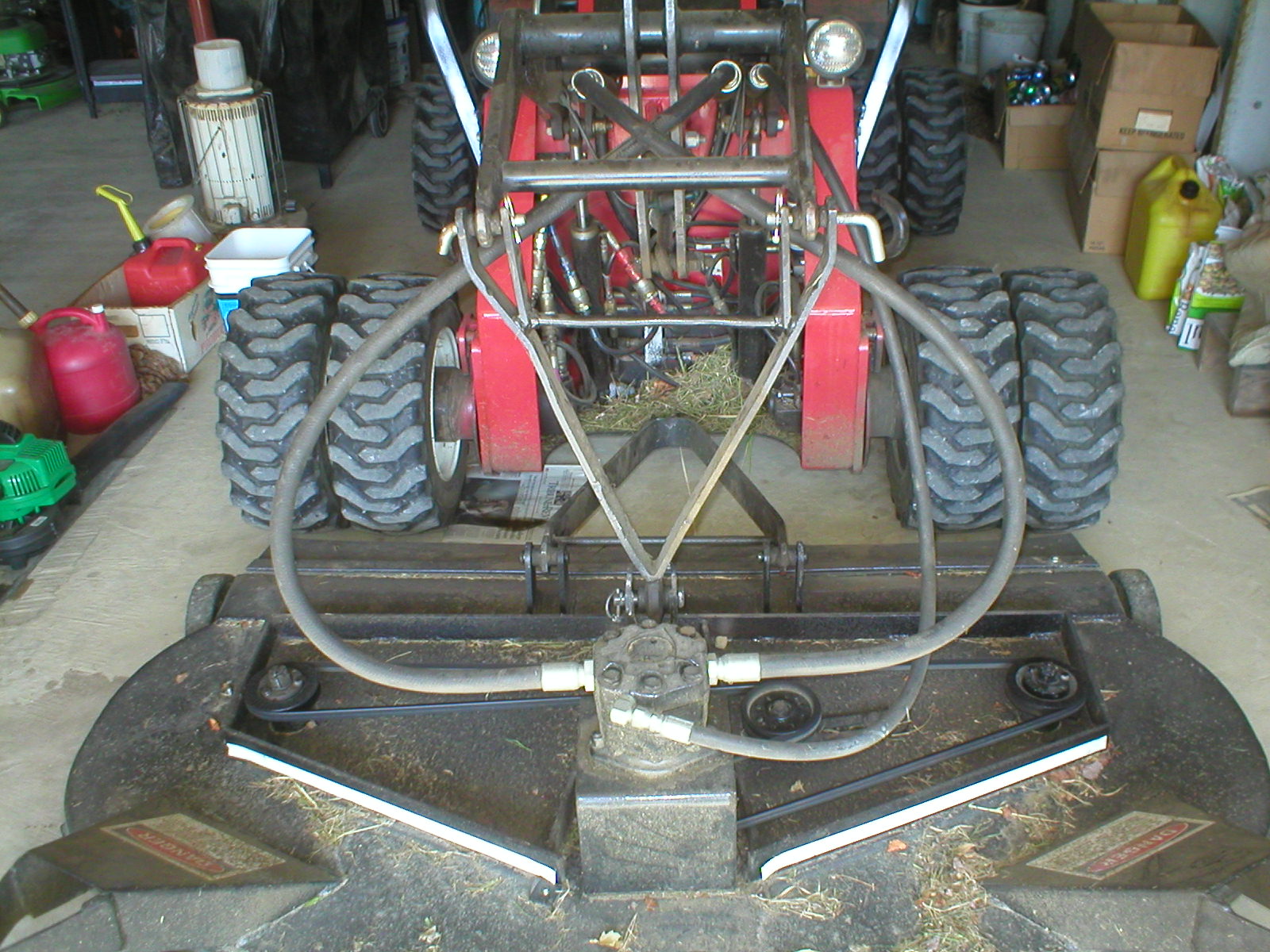

One more question about the finish mower on 1845. Is it typical for the blades to revolve slowly when the tractor is running but the pto switch is off? Mower motor has 3 hoses connected see attachment.

No.
The third hose in front is a case drain on the hydraulic motor.
All the best,
Peter
Oh, you might want to check to see if the PTO valve has some debris stuck in it, but don't overtighten it when you reassemble it.
