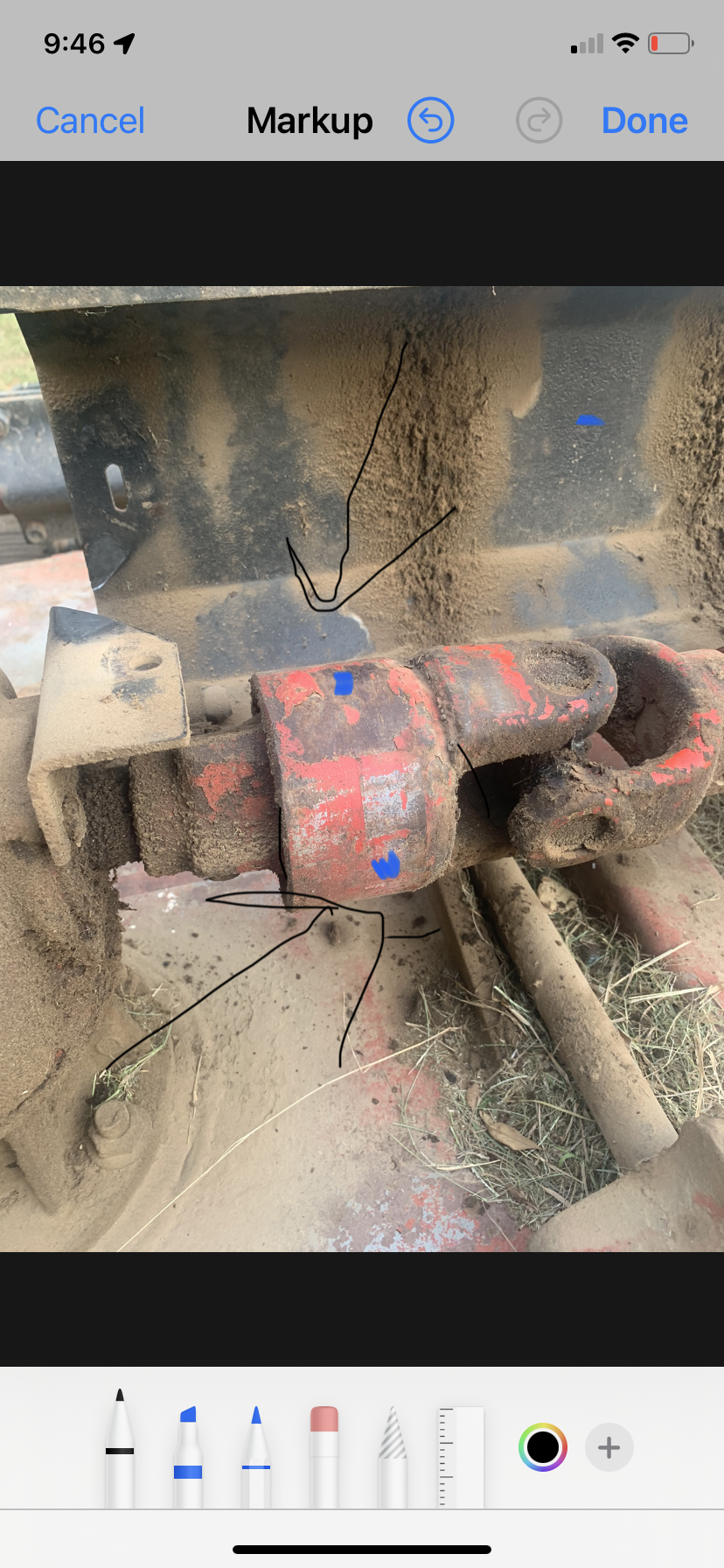

I have a 3210 and am resurrecting this thread to post a solution. The blades get out of time because the rubber coupling on the cross shaft fails and allows one blade to slip relative to the other. A new coupling is about $1100 but the complete shaft is $800. Go figure. The only solution according to Bush Hog is to remove the gearbox and put in a new shaft or coupling. First step was to re-time the blades. Again Bush Hog says take out the gearbox, remove yoke from hub and turn to correct timing and reinstall gearbox. This seemed like a lot of hard work. So, I removed both universal joint crosses, was able to save one, and with the crosses out I had enough room to pull the spline and re-time. Put u-joints back in and was good. BTW MOOG 331A is the replacement for my shaft, $20 at Advance Auto Parts. Then it got out again. Then I found the bad coupling. I tried to inject epoxy into the space. Lasted about 2 hours. I had already noticed the opposite side had a 3/8 bolt in the side of the coupling. ????. Now I know why. Got out my drill, drilled a 1/2" hole through the coupling catching the OD and inner hubs, put a 6" Grade 8 bolt and it did not budge as I finished my 60 acres of mowing. I do lose the shock absorbing of the coupling, but I have not had it for years on the other side with no problem. At the worst it fails and I buy the $800 shaft, which is where I was when I started.
   / Help with 3210 Bush Hog #23
When drilling the rubber coupler, which way did you drill the hole?
