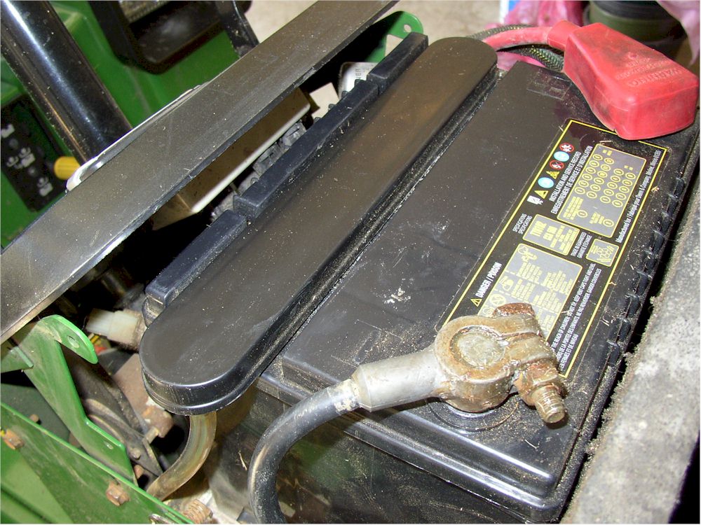

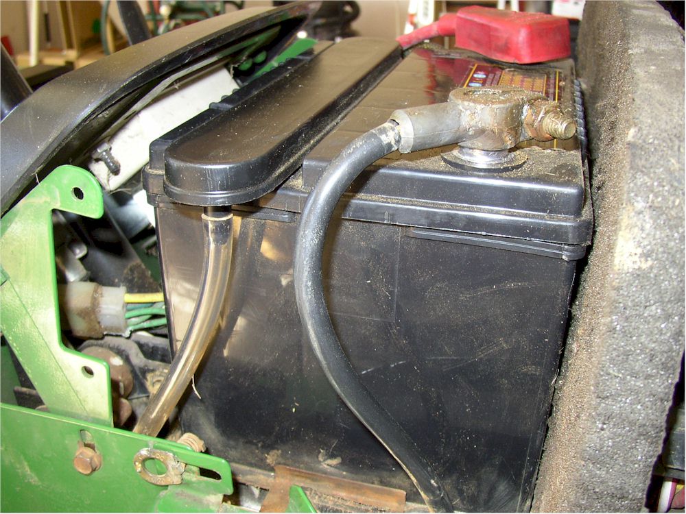

I agree with everything Sundancer268 said. The problem looks to be simply an overfilled battery. I posted a picture from the 755 manual that shows the proper battery fill level. Having said that, there is still some small loss through the vents to be expected due to the bouncing and angles of operation for a tractor. Corrosion around the battery on JD tractors is very common, and there are lots of threads here about that. I also experienced those corrosion problems, but mostly solved them several years ago by adding a vent hose. The JD TY6192 battery comes with a second vent cap that can be used with a hose. Buyers usually just throw that cap away. If you still have it just add a hose and change over to that. Of course first make sure that battery fill level is correct.
