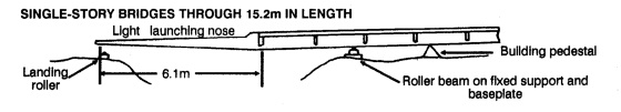

Many temporary bridges are pushed across by making a front extension that will reach across the opening before the balance point is reached, then the bridge is pushed the rest of the way across and the extension removed. You might be able to use a couple of poles fastened to the trailer.
Watch these videos to see the idea in use.
Acrow bridge build animation - YouTube
Compact 200 Modular Bridge Construction - YouTube
Regak Bridge - YouTube

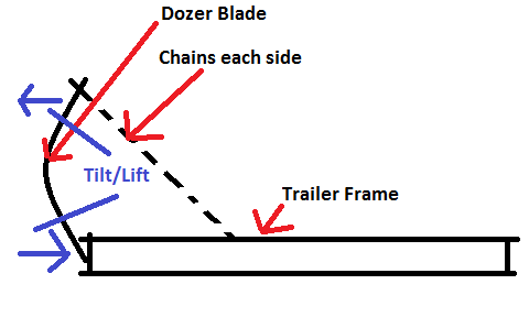

I've seen this done on a small scale. I have no idea what size/rating of chain would be necessary though for a 40' semi trailer. My sketch is obviously not to scale.
