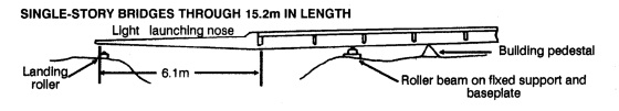

Many temporary bridges are pushed across by making a front extension that will reach across the opening before the balance point is reached, then the bridge is pushed the rest of the way across and the extension removed. You might be able to use a couple of poles fastened to the trailer.

I was thinking similarly... buy two 40' trailers.
Weld them together end to end end so the bridge is 80' long.
Put an upright in the midde about 8' high.
Run a cable from one end, up over the upright and down to the other end to provide some tension.
Push it across the 28' span. Some greased logs should provide an easy surface to slide it on.
Once its on the other side, remove the cable and uprights.
Cut it in half again.
Then you can either double stack it for a stonger bridge, or double width it for a wider bridge.

I don't know how much your M7040 weighs but in its "bare" state its within 100# of my M6040. My M6040 as its now configured weights 9700# - Rimguard, FEL, 3-point ROBB etc. A thought to consider - if your tractor or dozer deflects the finished bridge quite a bit - I would construct some type of center support for added safety. Two driven posts at the mid-point of the bridge, one on each side of the bridge with a heavy cross piece going under the bridge or something like that would considerably reduce any "pucker factor".

On both sides drive some anchors about 30' back from the bank, get some thick steel cabling (get something rated high enough to support the trailer). Drag the cables across, pull them tight, and anchor them. Put your trailer frame on the cables and slide it across. Once positioned you can loosen the tension off the cables but leave them on the anchors, then go under your trailer and attach the trailer to the cables. The weight of the trailer can set on the ground, but having the anchors tied into solid ground further away from the banks will hold it in place should there ever be a bad flood that washes the banks away and the cables also will act as a "safety net" should the trailer frame start to give.
