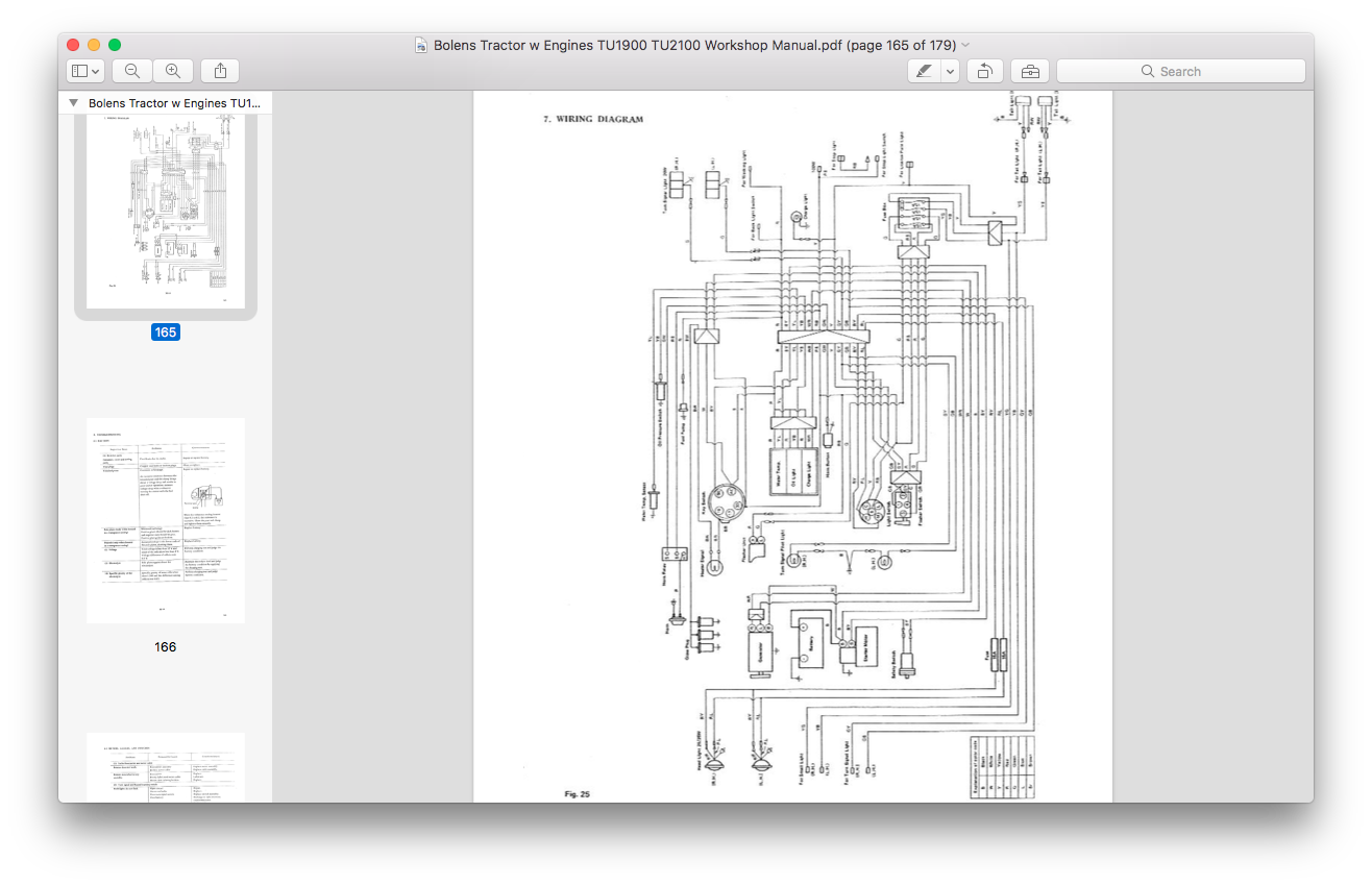

Feeling kinda foolish, I finished the rebuild on my Iseki tl230 and am almost done with the re-assembly. I labeled all my wire connections but failed to label a red wire that connects somewhere on the right side of the engine.The wire is in a bundle with the oil pressure sensor wire(yellow with black stripe) and the glow plug wire ( black with yellow stripe). From what little info I can find there's supposed to be a connection to the fuel pump but for the life of me I can't figure out where it is. Any help would be appreciated.

OK , I'm wondering now wether this wire might in fact go back up to the key switch. Contemplating the wireing diagram and there seems to be some indication that may be the case. So far nobody has chimed in so I'm guessing nobody has the answer?

Might help get an answer if you post your wiring diagram.

Thanks John. I think my warranty is long past. I wasn't thinking starter fluid but maybe a capful of diesel. I havn't tried it yet. The closest wiring diagram I have found ( a tractor that is supposed to be very similar to the Iseki ) is for a Bolens TU 2100. wire diagram.png
The branch of wire that I'm trying to figure out is the 3 wires that include the oil pressure sensor ( connected) The glow plugs (connected) and working and the red wire that in this diagram says it goes to the fuel pump. There is no electrical connection to the fuel pump on this tractor. I believe the fuel pump is mechanical.
