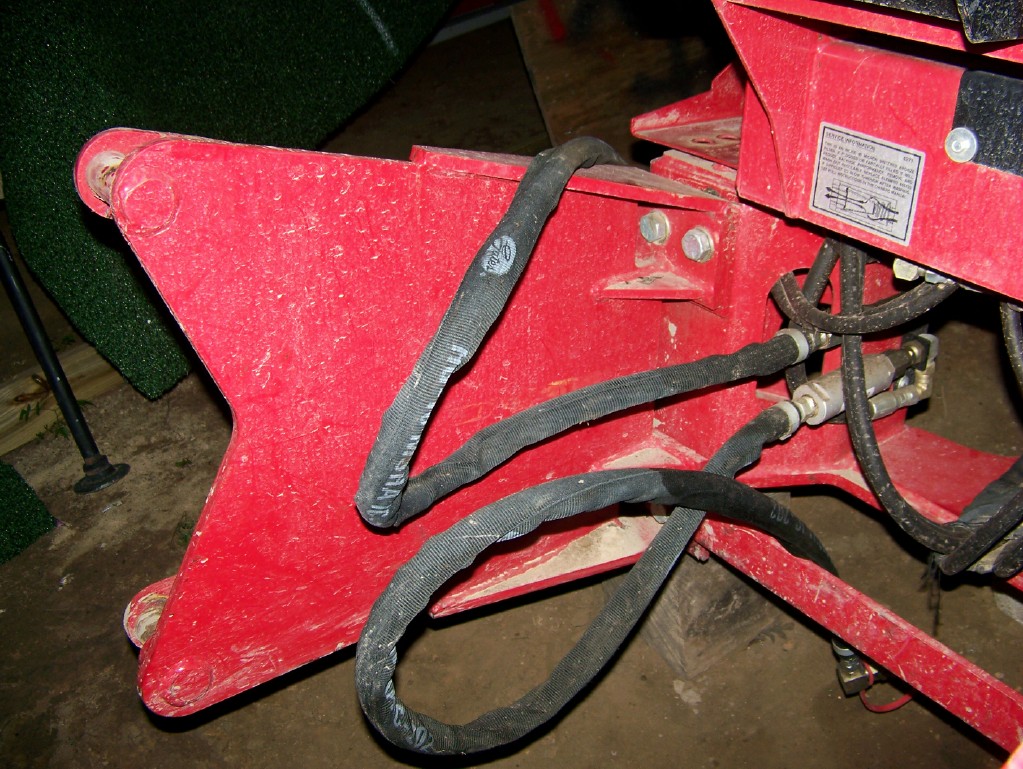

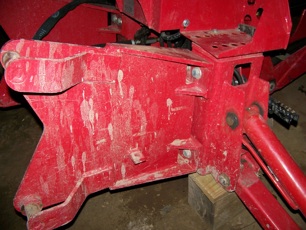

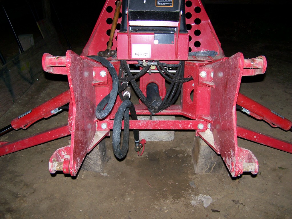

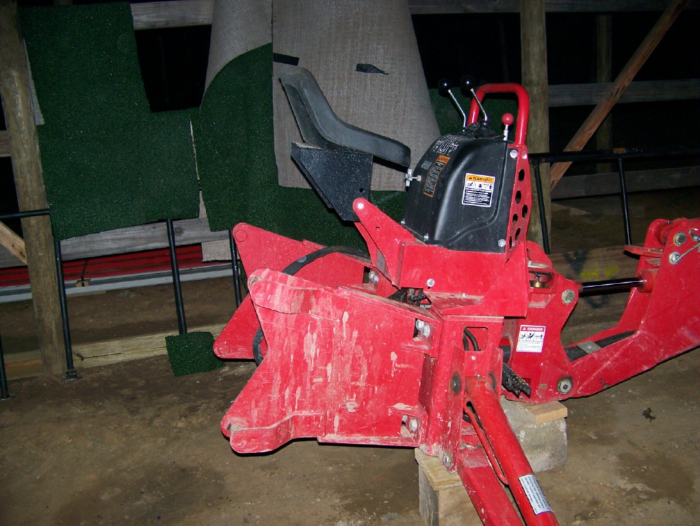

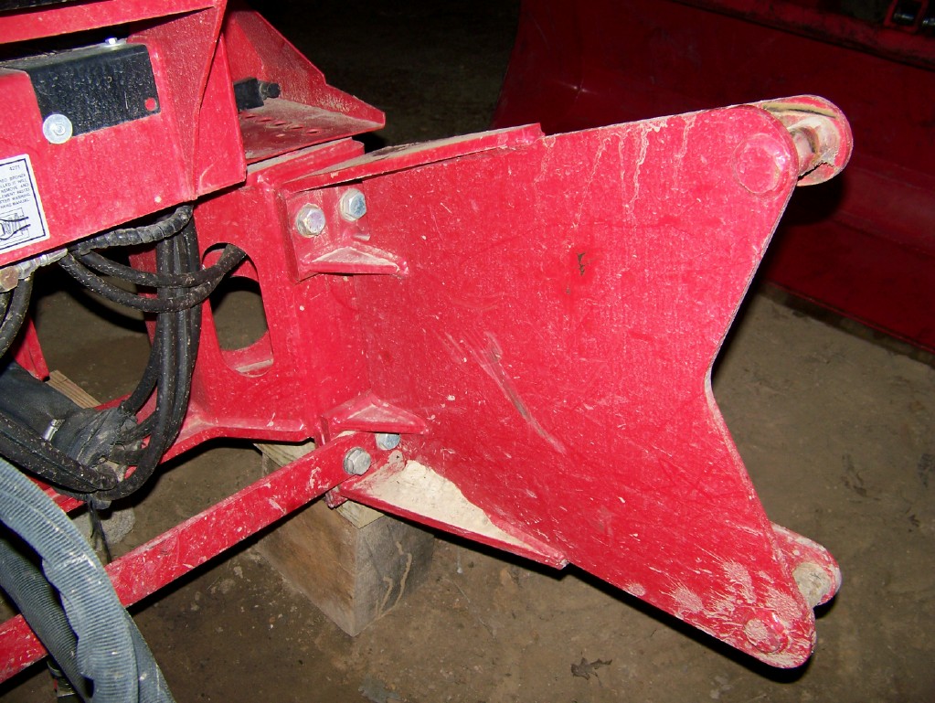

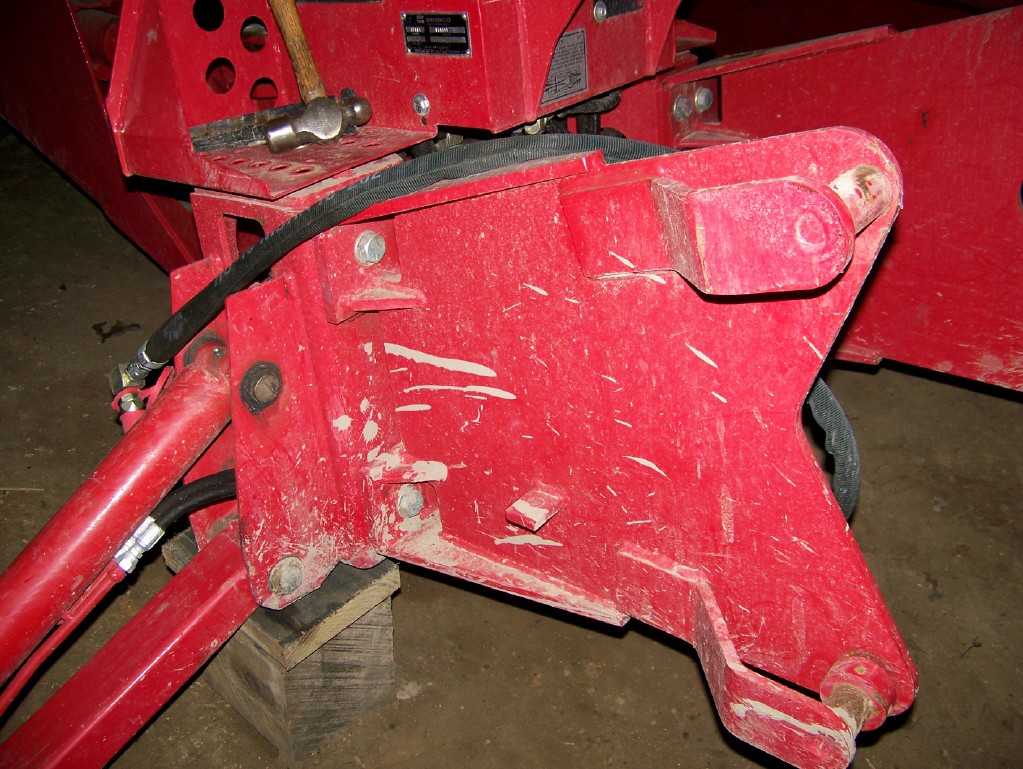

All I could find was photos of the backhoe's half of the subframe. I will try to get tractor half of the subframe later this weekend.
hugs, Brandi

Thankyou very much:).
