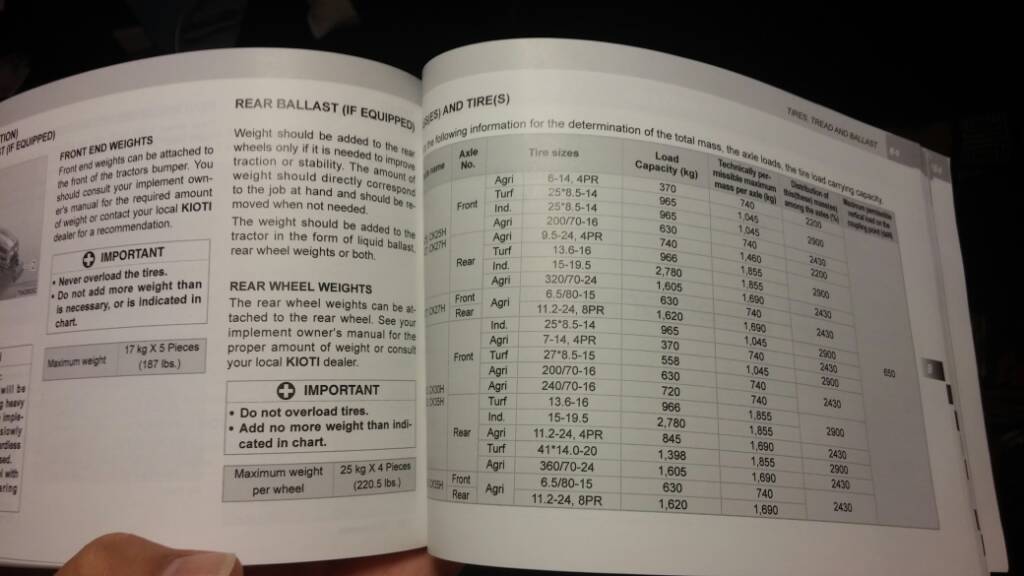

I couldn't find anything in owner's manual specific to filling tires, other than don't fill front tires and it should only be done to fit the job and removed (temporary) which I won't want to do. It does mention wheel weights max at 220 lbs each tire. Does that mean I would only fill tires to 220 lbs capacity?
Wheel weights @ 1/lb. isn't going to happen with my budget.
Not too worried about fuel. I have closed 70 hours on machine and have only filled up 4 or 5 times on a 8 gal tank.

I don't have R1, I believe I have what are called R4 or industrial tires. Definitely not turf tires. Does this mean I cannot spread the real wheels. It mentions doing this (although I'm not clear on the process) in manual I screenshotted but did not mention it being tire specific.

I don't have R1, I believe I have R4/industrial tires. Does this mean I cannot spread the real wheels? It mentions doing this (although I'm not clear on the process) in manual.
If your Kioti manual is not clear, call your Kioti dealer for specifics. Dealer will know whether or not wheel rims with R4s can be spread and will explain the process.
I am sure a Kioti CK30 owner who has previously explored this option will respond soon.
The rims on my Kubota L3560 with R4s are adjustable for width in four increments.

I called them and they didn't seem to think R4 tires could be adjusted. They're did say each tire takes about 3 gallons of rv antifreeze. It'd be $125 for them to do it. Seemed high to me.

Did you have a typo about the 3 gals per tire?
Call this number and they can see if there is a rim guard dealer close by. 866-792-3700
I used this in the rear ag tires on my Branson 4520r and the cost was around $300 total for both. It added approx. 500lbs per tire.
They should have told you 30 gallons for your 15-19.5 R4 tires. Figured 60 gallons total at a couple of bucks a gallon....$125 is pretty reasonable. That would get you somewhere north of 500lbs down low.

Yes, sorry, typo. 30 gal per tire. $125 for the fluid and then whatever labor on top of that, I think that's half hour minimum so probably another $50 to $80. So I'm probably going to look into doing it myself.
