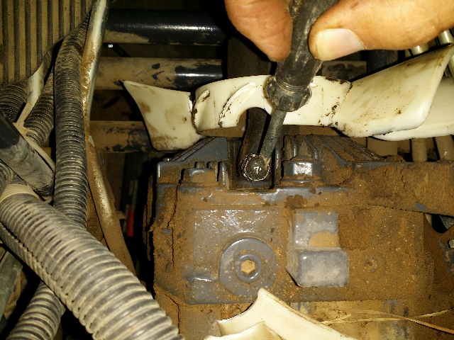

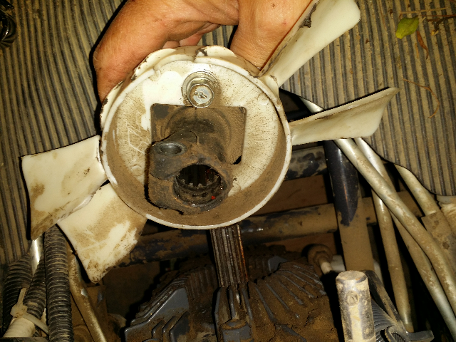

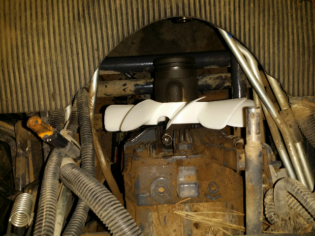

Well the new fan install has been fun but I do not want to do this again any time soon. It took longer to take it apart than it did to put it together. If Kubota just made it so we could access 1 bolt from the bottom it would be easy.
   / Help with BX25D Transmission Fan
#13
The only bolt that requires the floor pan to be removed.
The shredded fan.
The new fan!
