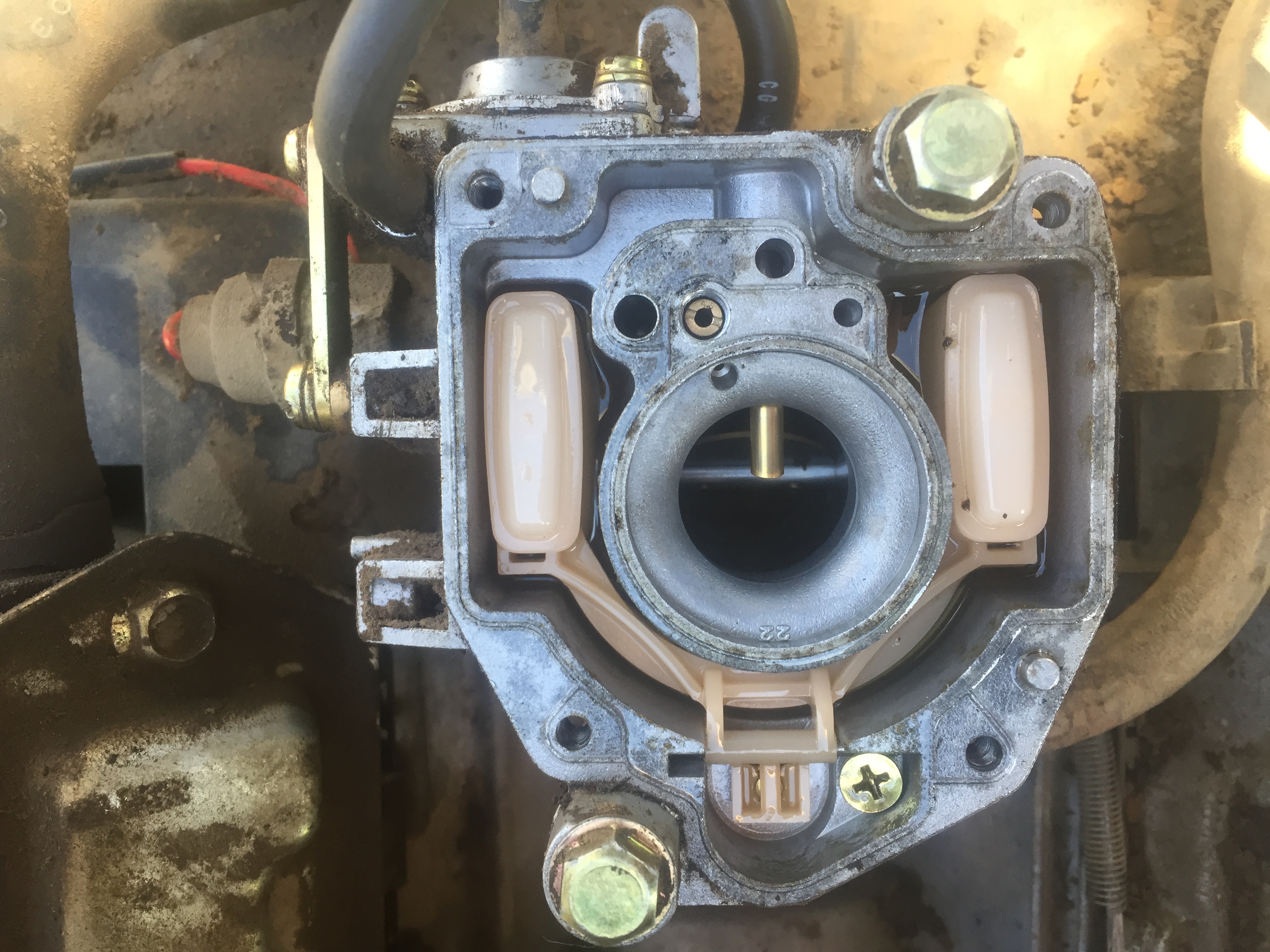

Here's a picture of the nozzle I broke off (first picture). The nozzle goes into the hole next to the slow jet in the second picture. Since its should be sealed, could this really spray gasoline into a dangerous place? I realize it might not run the best, but I'm trying to figure out if I can at least run it safely while I troubleshoot the original problem. I can't find a part number for the broken nozzle, or for the carburetor upper body. Does this mean I'll have to buy a whole new carb to fix it?
   / Help with Carburetor #15
I was thinking about another tube outside the carb. My bad.
What is broke is the emulsion tube. It is where the gas and air are mixed together. To give you an example of the importance of that tube, I one time drilled those holes a tad bigger in a race engine carb. It ran worse. So with it completely gone I wonder if it would even run at all ???
Anyway no danger of burning down the garage because of that broken tube. I guess not anyway...
Don't know if or how that tube could be replaced. Probably have to buy the whole part it's hooked to ?.

FWIW...it did run for several minutes with that tube broken off...

I see in the picture both thru bolts are still in place. That how the tube got bent maybe?
When you pull the float out to see what crud is in the float bowl and blow out the jet holes again, (watch your eyes) put a rag in the throat so when the needle falls off the float it don't decide to go down into the engine.
That will really ruin your day!
   / Help with Carburetor #18
You can download the EH72 illustrated parts manual from the Robin website. That manual has a dedicate page for the EH72 carb.
The carb upper or lower body is doesn't have a part number, so that means you have to buy the whole thing. And that jet is not a user replaceable part, apparently :(
Part Number #280-62301-30 on Jacks Small Engines: $296. Ouch!

Wanted to drop a quick update for anyone having similar issues. I haven't determined the exact problem...probably a clogged jet. But since I broke that emulsion tube, I ended up buying a new carburetor. Put it on, and the tractor is running great. Thanks again for all the help.
