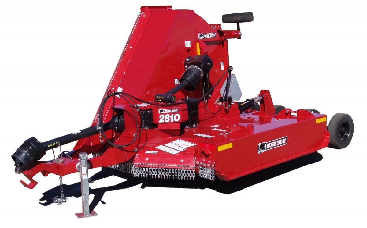

Alot of people think that if you cannot maintain 5MPH that the cutter is too big. I dont buy into that theory. As long as the cutter isnt too heavy for the machine, go as big as you can. I'd rather run a 8' cutter at 2.5MPH than a 4' cutter at 5MPH. Even though time to cut an acre is the same, going slower makes for a smoother ride. I run a 6' heavy cutter on my 29HP PTO and wish I had an 8'. I have never cut anything that required me to slow down below 3rd gear, and only in the thickest of thick, do I use 3rd gear. But there are a ton of times I have to slow down just cause the rough terrain. If they werent so heavy and unable to trailer without a permit, I'd be looking for a 10' cutter.
Here is a 10' cutter that can be hauled without a permit.
2810 Flex-Wing Rotary Cutter

I dont have remote hydraulics. And I dont think I have the heft to tow a pull behind in some of the areas I mow. I need weight from the cutter on the tractor. Not to mention I dont know how I would be able to load that on the trailer.
