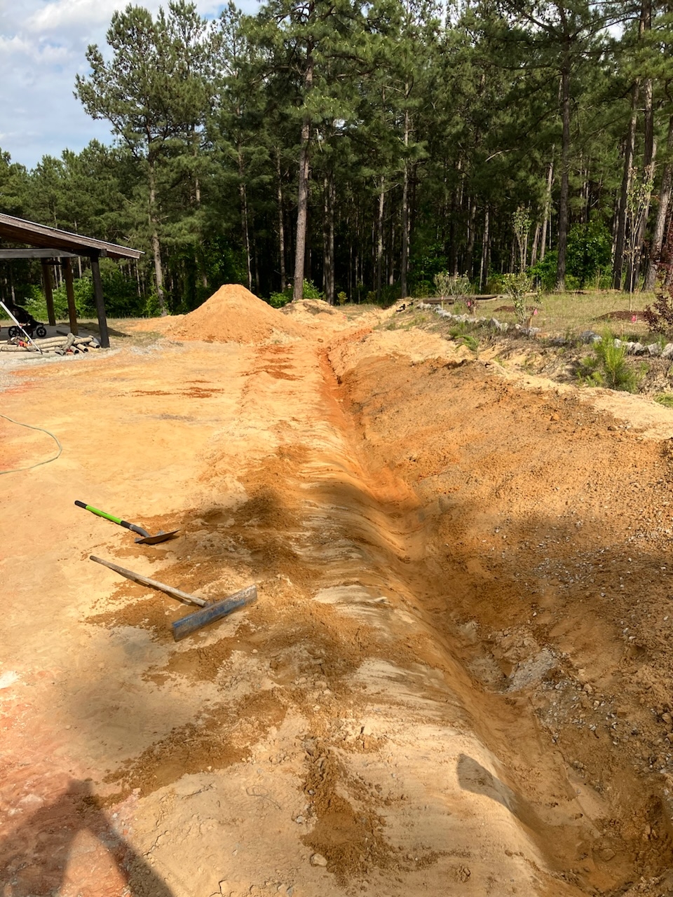

Broke ground last night. Thank you for everyone’s suggestions. I’ll post updates as it rolls along.
Step one: rough cut a small ditch and roughly level the driveway. Then, I’ll set up the rotary laser and start getting precise.

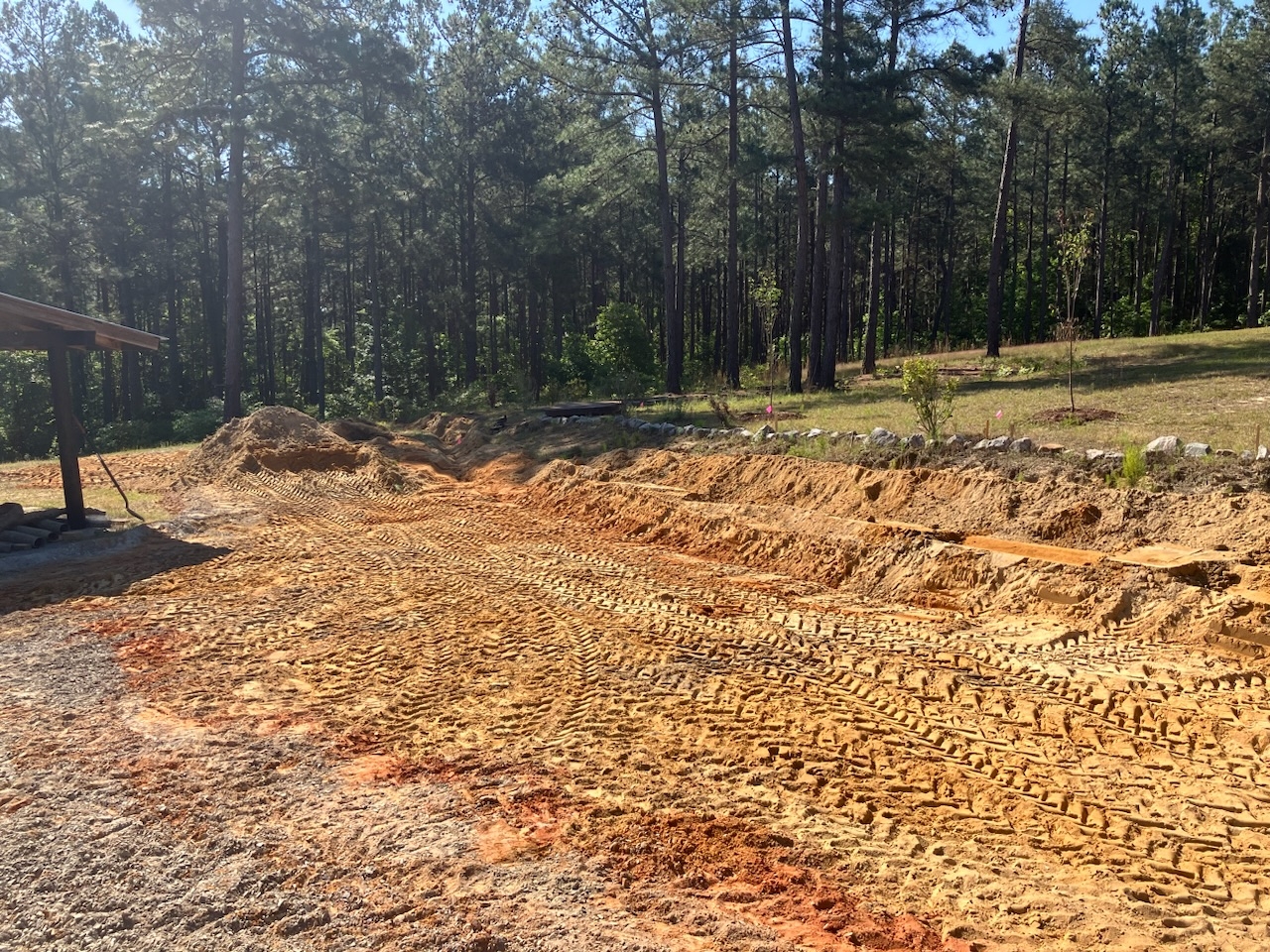

#34
Finished for the day. The driveway has gone from sloped to level-ish. Still have quite a bit of earth to move to give it a slight grade towards the trench

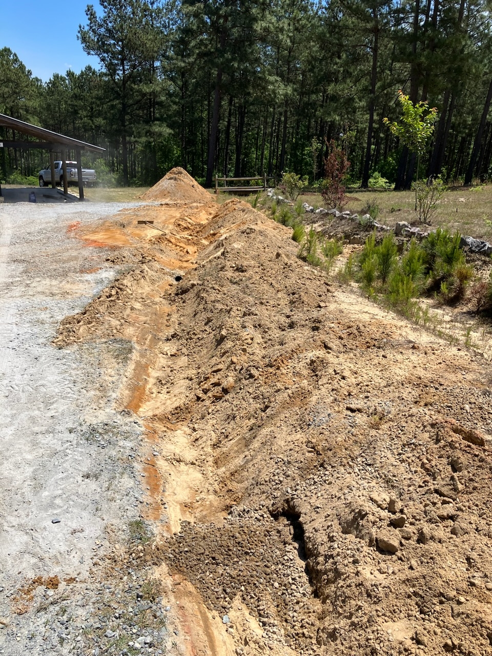

#35

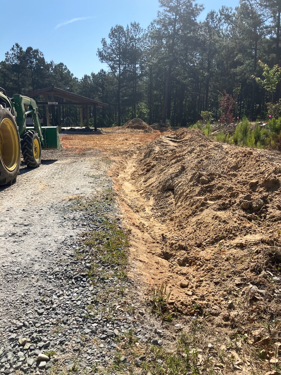

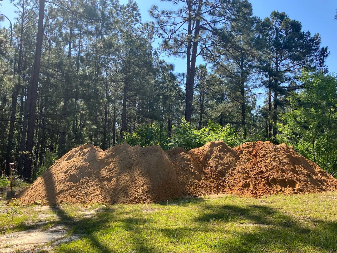

More work updates: got the grade decent. Ended up moving a massive amount of dirt! Shovel for scale in the left of the dirt pile.
Extended the rough cut into the woods about 100’ and had to use my pallet forks to move an old bridge. We may use it later so it was easier to just pick the whole thing up.
Continuing todays work will be working on the cut, smoothing out the grade on the berm to prevent erosion and allow grass to to grow, and moving more dirt.
These tractors work hard for 24.9 HP.

Doesn't look like you have large rocks in your ground. That makes a huge difference.

Yeah no big rocks at all. Really just sand and clay.

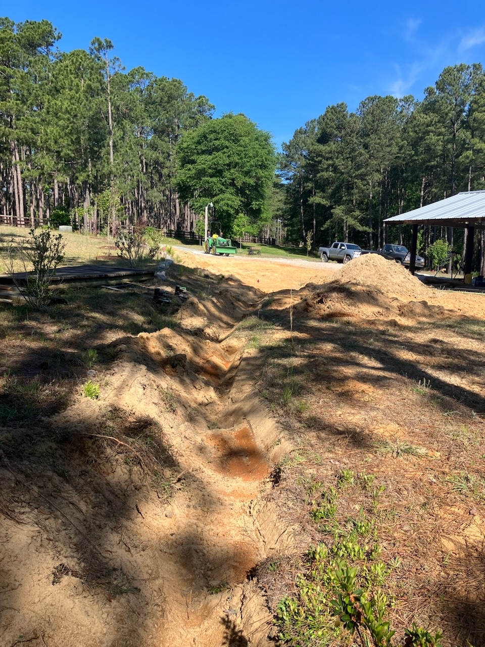

Yeah good point, I’ve been using the laser to check general slope but I did a water test today and found a few flatter spots.
Would you guys recommend laying down some landscape fabric in the cut before I put down some drainage stone?

depends whether or not you want vegetation to grow …
it is some very nice material you got there so other then slowing the vegetation growth i don’t see any advantage to put fabric down other then maybe reduce erosion

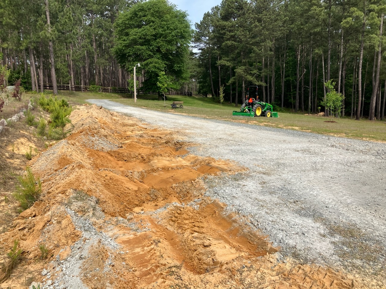

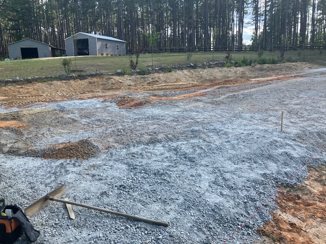

On the sloped berm next to the cut I’m planning on seeding with something that’ll do well in the summer (Bahia or Bermuda…open to suggestions but it needs to tolerate sand), and then getting some erosion control rolled fabric to lay over the top while it germinates.
Inside the cut, I’ll just do some sort of stone. I don’t necessarily care if it sinks some, as the point of the cut is to be lower than the drive. There are a lot more experienced guys on here than me, so far I’ve changed my plans a few times based off the posts here.
Edit: trench is 85% done and shaped, image below
