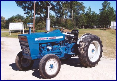

DETAILS for TRACTORS from FORD
Model = 3000
SERIAL NUMBERS
Beginning No. Year
C100000 1965
C124200 1966
C161300 1967
C190200 1968
C226000 1969
C257600 1970
C292100 1971
C327200 1972
C367300 1973
C405200 1974
C450700 1975
C490300 1976
Model = 3000
SPECIFICATIONS
Years Mfg: 1965-1976
Fuel: G
D
Engine Make: FORD 3-CYL
FORD 3-CYL
CID: 158
175
Engine HP: 37 PTO
37 PTO
Cab: NA
No.Speeds: 6/2-4/1
8/12-10/2
Weight(Pounds): 3,700
3,920
List Price: $6,350
$6,465
PRICING
Avg. Auction Price
LOW HIGH AVG
$2,100 $6,500 $3,784
Auction Results
FORD 1965 3000 $3,100.
Condition: G Auction Date: 02222002 GROOM
Comments: D CAB
FORD 1972 3000 $3,100.
Condition: F Auction Date: 02122002 ARCHBOLD
Comments: D
FORD 1972 3000 $3,500.
Condition: G Auction Date: 03122002 ARCHBOLD
Comments: G
FORD 1972 3000 $3,900.
Condition: E Auction Date: 03162002 OLD APPLETON
Comments: G
FORD 1972 3000 $4,600.
Condition: G Auction Date: 03062002 BEATTIE
Comments: G
FORD 1974 3000 $3,700.
Condition: G Auction Date: 08302002 PLAINVIEW
Comments: D
FORD 1975 3000 $1,900.
Condition: G Auction Date: 02162002 NAZARETH
FORD 1975 3000 $3,050.
Condition: G Auction Date: 06082002 UMBARGER
Comments: G WF
FORD 1984 3000 $3,300.
Condition: G Auction Date: 04052002 ELKTON
