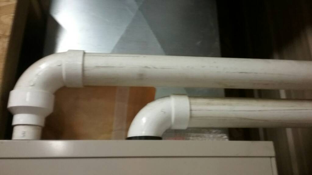

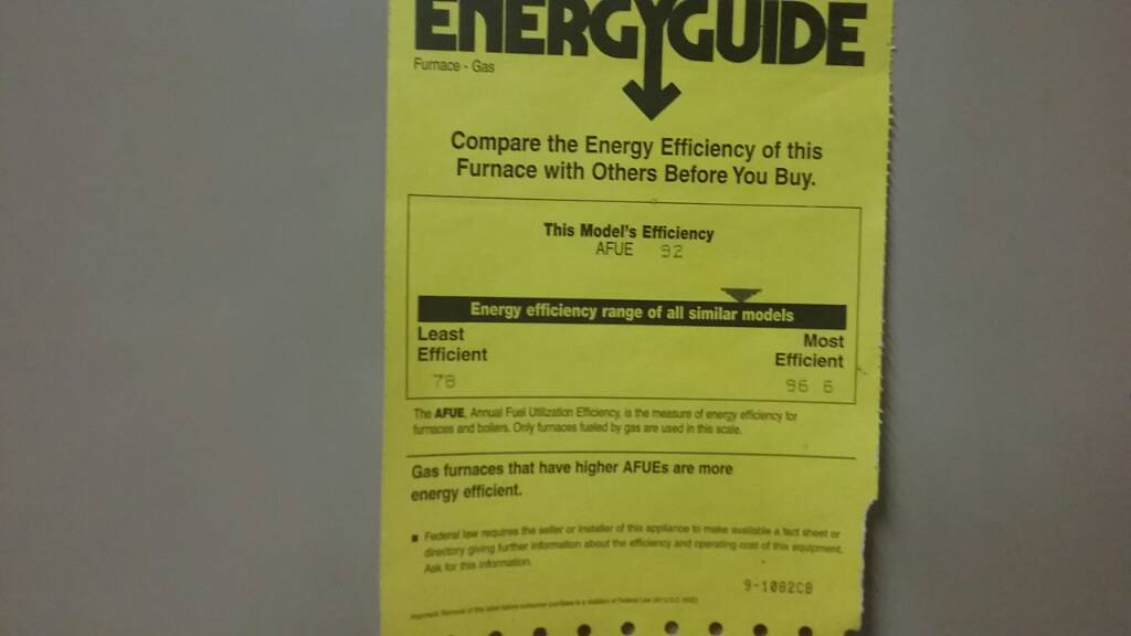

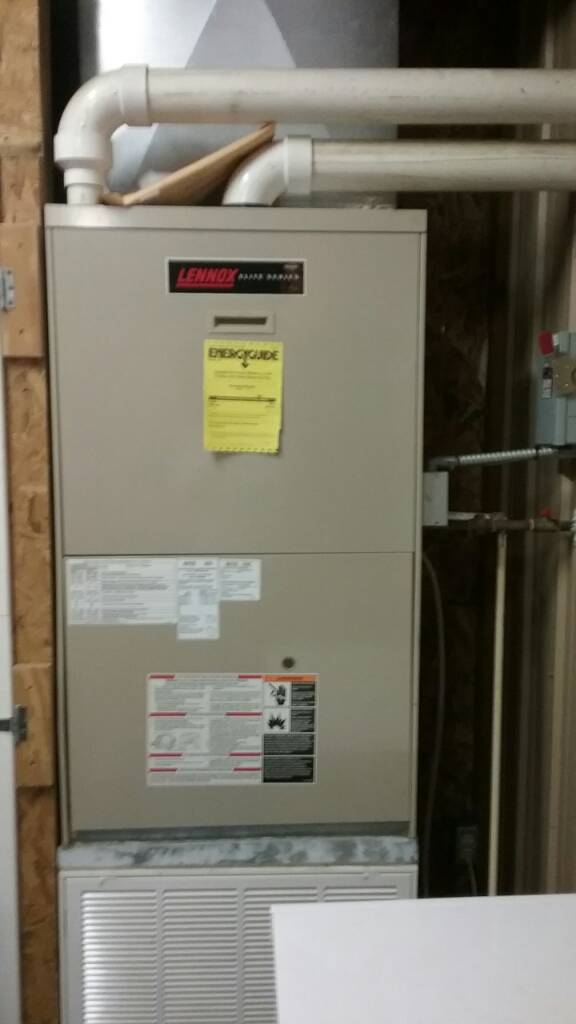

The propane furnaces are Lennox. This is the shop one, then two in the house. They all have plastic exhaust. In the dining room I have a propane Vermont Castings stove. That has the B vent double wall metal flue pipe I ran up the chimney in that room.
I just looked it up, these furnaces installed 1999. The oil furnace I took out was (my best guess) late 60s so 10 years old when I bought the house.

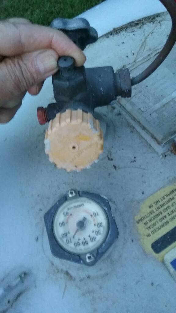

To preface in case anyone doesn't know about how they fill propane picture shows my hand is on a valve. Delivery guy fills until liquid propane comes out. Gauge has a float, mine is full although gauge reads 70. Summer heat they allow expansion, winter fill it's about 85.
About five years ago I called around and cheapest propane was "Panther Fuel" so I called them to deliver. Going to work that day I checked tank gauge and it was on 85. I had forgotten I was on autofill with my usual supplier and they just made a delivery!
When I got home that day there was an invoice on my doorknob from Panther Fuel.
Printed ticket said 90 gallons @ $1.69 and total with tax and everything it was $165.00.
I walked down to tank and gauge was on 65...and it was a warm day!!!
I called Panther the next day and they said "it takes special equipment to pump it out...we topped it off". Long story short I spoke with owner who said I didn't have to pay the $165.
I'll always believe they were trying to pull a fast one, and removed some of my propane as well.20190615_204429.jpg

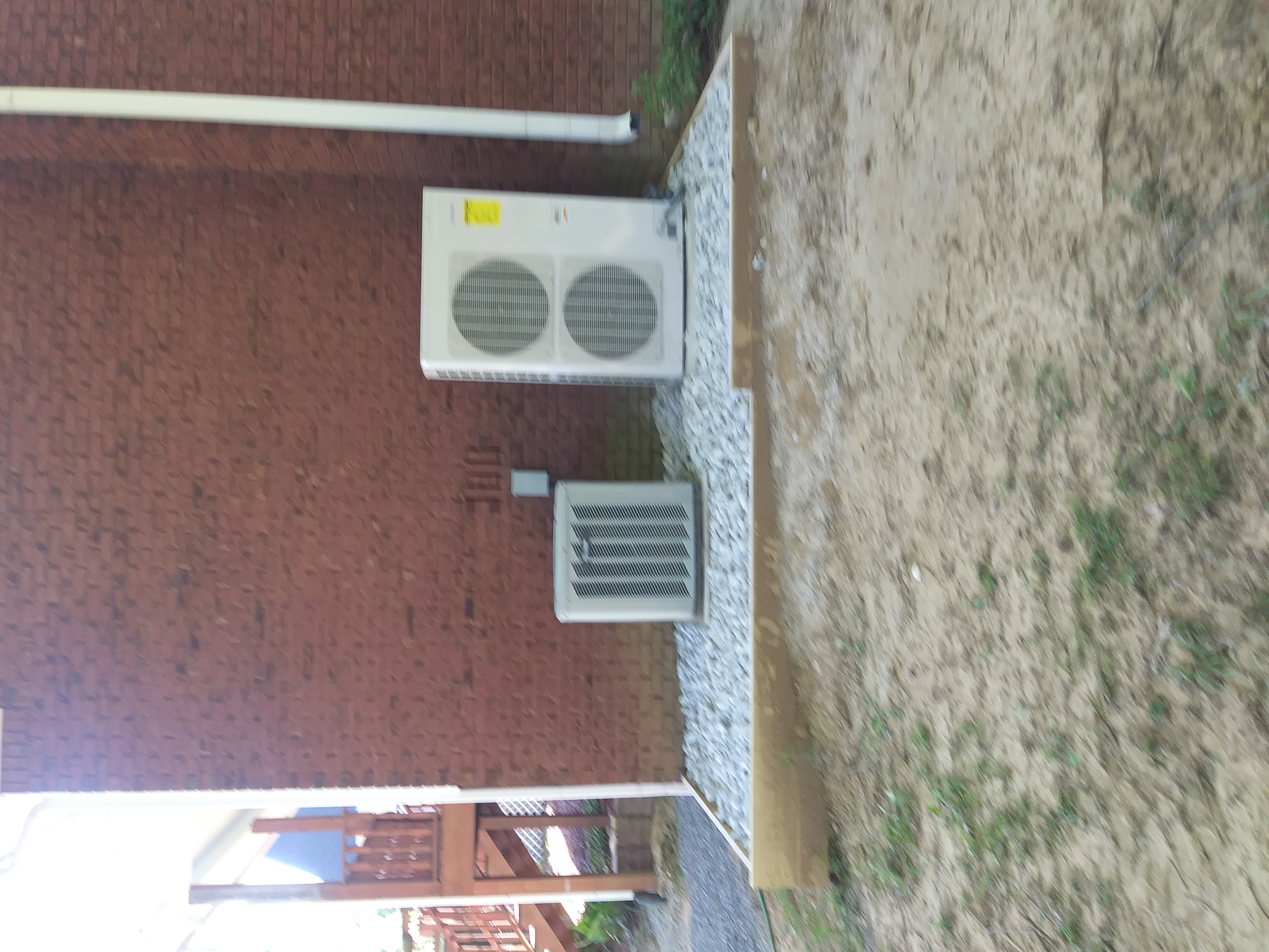

Find one of these to install... VRF,,, one to one with matching AH..It will heat down to -20 deg temps
