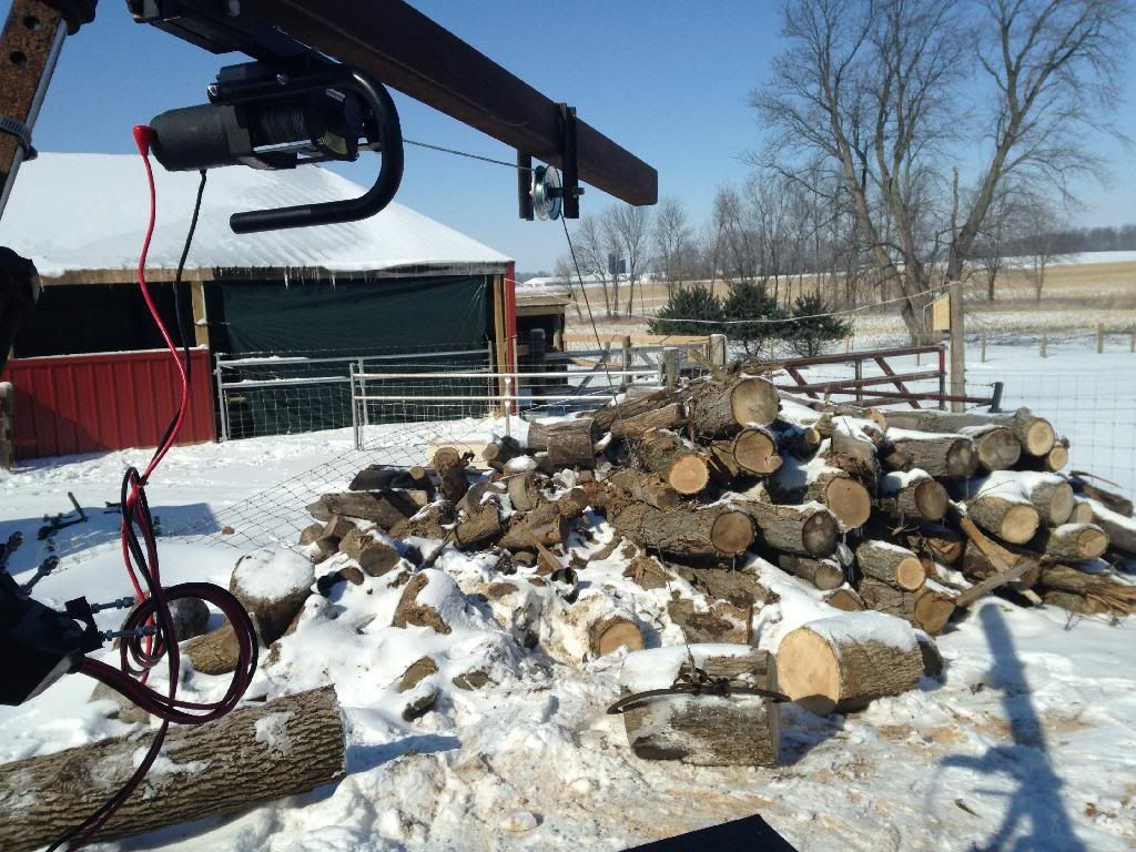

Thanks muddstopper,
I guess I figured I could run the electric valve of off the tractor easy, I would think the winch would need at least a small battery close by. I do have one of these winches on a small trailer that I just plug into the rv plug of the truck to run. I always thought it was kind slow though. I agree I don't want to be walking back n forth to run the winch. I was also looking at spring loaded tongs to help with them coming loose.
Some back ground, I haven't done much logging or firewood work. I took a bunch of trees down this year to build a fence, and put in an outdoor burner last week. I have about 10acres of woods that were logged two years ago so there are a lot of tops back there to cut up. Also have a excavator and have been cleaning up fence rows around the farm fields. So I am planning to haul logs in to cut up and take it back in the woods to split what's back there.
-Jeff

You can still get your 12v power for a winch off the tractors charging system. I would suggest a battery mounted on the splitter somewhere and let the tractor keep the battery charged. If you decide to put a gas engine on the splitter, get one with electric start and you can keep the battery charged as well as not have to run the tractor while you are splitting wood. Plenty of old riding mowers you can get a cheap engine off of.

Well I think i will be going hydraulic on the winch. I hooked up an electric and it works well, but it is slow. Still better then nothing. Split about a cord this afternoon.
Then pulled some more logs out of the woods before it thaws tomorrow.
