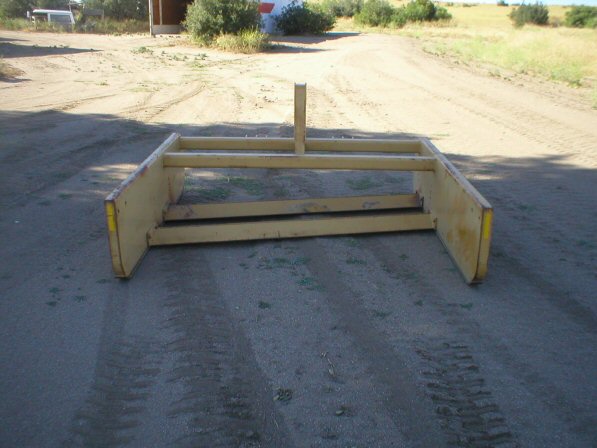

Piston, the land plane grader blade (LPGB) that we had been talking about is now sold to another TBN member dutchhenerybrown. It made a 7' cut was actually 90" wide and 96" long and weighed in at about 1400lbs.
One of the best units available IMO is a Road Boss, but they are big money. I believe that the RB units have the longest sides of all the units built today. Second would be GradeMaster, and they have 3 different levels. Not as long on the sides, but would probably be my second choice.
I would not go any wider than a 7 footer with your tractor and try to get a unit that is close to 1,000lbs at the minimum. ;)

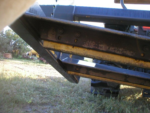

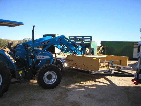

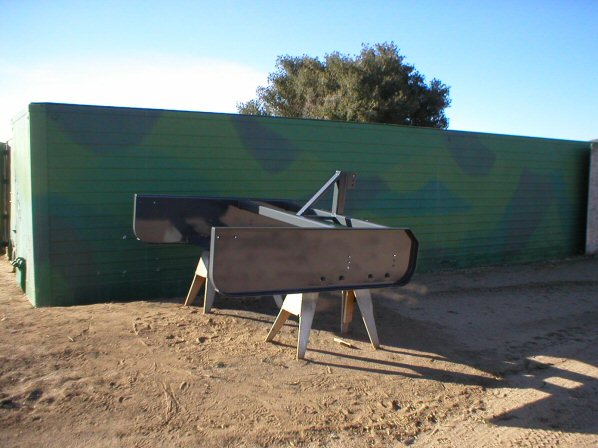

Here ya go.;) You can see in the one pic from underneath that there are another set of holes to drop the blade down after it wears. Maybe after another 10 years I will need those. :laughing: If I remember right, Road boss has the longest runners as I had mentioned and I think that on a 7 footer, that the sides are 6 foot long. The Road Boss blades are built to weigh at or more than 200lbs per foot width. We are back to weight again, and the heavier the better when it comes to grading.
