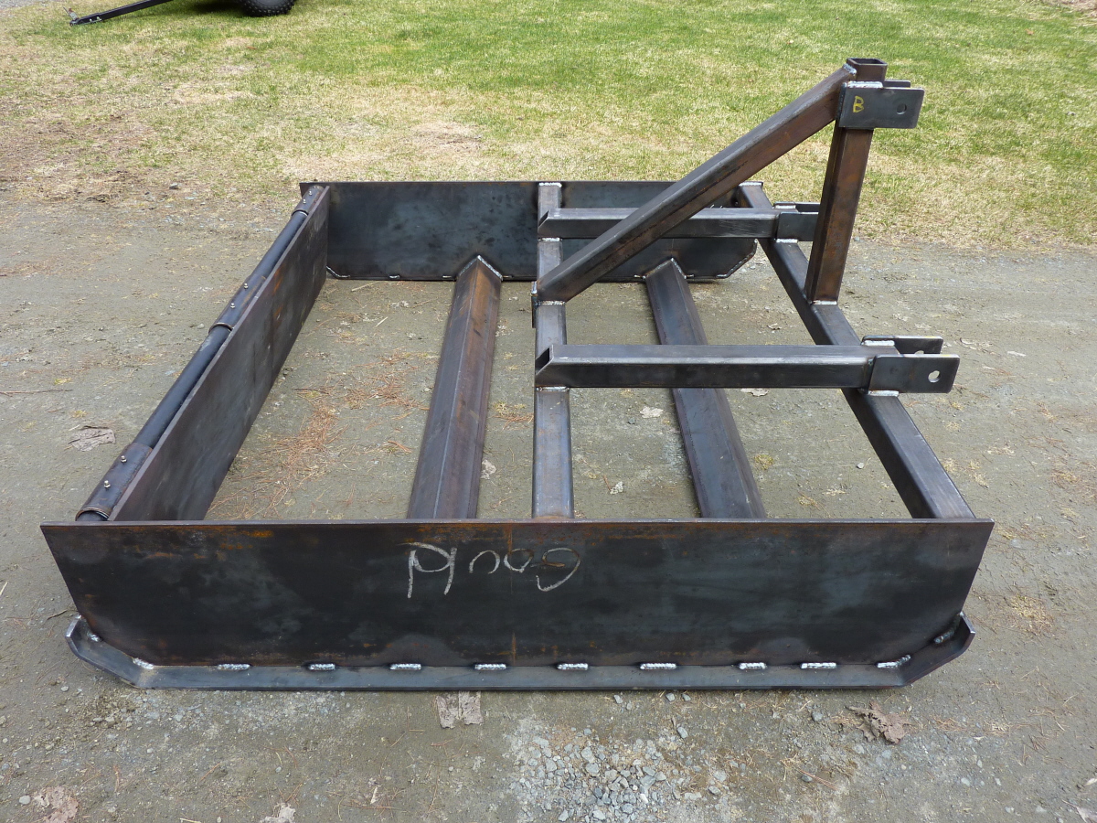

Thanks - land plane grader makes it easy. Yes it is homemade. A picture before paint and cutting edges.
Grader 4'-6" long, 5' wide ( inside) 575 lbs
Notes
Lift Arm Braces 28" center to center
Upper Cross Braces 2' apart
Blade Mounts 2' apart, first blade mounted 10" back, front of Blade Mounts are 3/4" below runners
3" X 3" triangles cut from bottom corners of sides for runner angles
1/2" Grade 8 bolts and extra long nuts for tail gate stop pins
swinging tailgate up and forward to hang insde against stops is like box blade ( sort of )
swinging tailgate up and back to hang behind stops allows use like push blade in reverse
Steel
Standard lengths - Bought and picked up at steel supply house, They make one cut at no charge
3/8" X 12" steel plate 20' (2/10') $210
2 sides, 6pcs 6" X 3" for hitch clevises, tail gate
3/8" X 2" steel bar 10' $25
2 runners
2 1/2" X 1/4" Square tube 24' (2/12') $115
2 upper cross members, top link verticle and angle braces, 2 lift arm braces
4" X 4" X 3/8" angle 10' $69
2 cutting blade mounts
1 1/2" schedule 80 blk iron pipe 10' $46
hinge pin for tail gate ( used 3 short pieces of 2" sched 40 I had for hinges )
Total Steel $465
Figure on another $250 or so for a pair of heavy duty cutting edges.
I copied this quote from another thread, I keep referring back to this thread when thinking about making a land plane, this way I'll have a good pic of Gordon's pretty plane in my notes :thumbsup:
Thanks Gordon. (if you want to post any details/pics I would love to know more :D)
