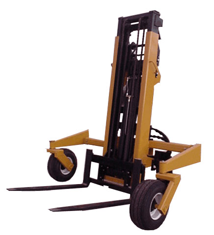

Should be able to power a fork lift mast.
http://www.tractorbynet.com/forums/...04105455-3-pt-forklift-3pt-hitch-forklift.jpg
2008 Other 3pt forklift attachment Construction Equipment & Forklifts - John Deere MachineFinder
Here are the hyd specs for the IH 2400
Hydraulics:
Type: open center
Capacity: -unknown-
Pressure: 2500 psi [172.4 bar]
Valve flow: 12 gpm [45.4 lpm]
Total flow: 12 gpm [45.4 lpm]
17 gpm [64.3 lpm] (reverser/hydro)
Steering flow: 2.5 gpm [9.5 lpm]
yes, I later saw that was not just my idea because I later have seen 2 at farm auctions that others made. What I did not know (in your second link) is that they are also commercially manufactured. One thing I don't understand is what use they are unless you had them supported by wheels since a forlift lifts much more than a 3 point can handle. The mast itself is pretty heavy.

Well then, how about this.
http://youtu.be/kgUlHVuhYtQ
http://www.forkster.com/fullgallery.asp
Extension Boom Product Specifications
Berlon Forkster Skid Steer Attachment
Load-stabilizing wheels designed to maintain stability and prevent tipping
Applies only minimal stress to the skidloader arms
Adjustable arm width to handle many different lengths of materials
Sturdy tread tires that turn easily on any terrain
15コ of tilt in both directions
3 stage mast
16 foot height
Pressure down safety valve
Optional truss boom available
Lift Height: 15.2 ft
Max Lifting Capacity: 3,300 lbs @ 7 ft, 2,500 lbs @ 12 ft, 1,200 lbs @ 16 ft
Tire Size: 20.5 x 8-10
Tire Rating: 4-Ply Sidewall, 5-Ply Tread, 90 PSI
Wheel: 10 x 7.5 with 5 x 4.5 Bolt Circle
Clearance Height: 101" With Forks Lowered
Clearance Width: 93" Outside tires (innermost position), Up to 136" Extended
Hydraulic Spec: Minimum Pressure: 1,500 PSI, Minimum Flow: 6 GPM
Weight:1850 lbs without forks

You could obtain a used mast assemble from a forklift place and add wheels that would support the weight you expect to lift.
   / Help with Loader Valve IH 2400 and Cross SBA22
#55
I have a 40's or 50's clark forklift that was used at a small airport. It is extremely nice condition and works excellent after I fixed a couple small things. I bought it at auction for only 450.00 because they didn't try to start it. It's actually an indoor type but gasoline engine. I'd rather find a rusty junker sometime to use for that. A mast that someone was using for a 3 point went for 90.00 but I missed out. Another mast I was bidding on, the other idiot was the kind that just liked to win no matter what. It got to some crazy high price and I quit.
