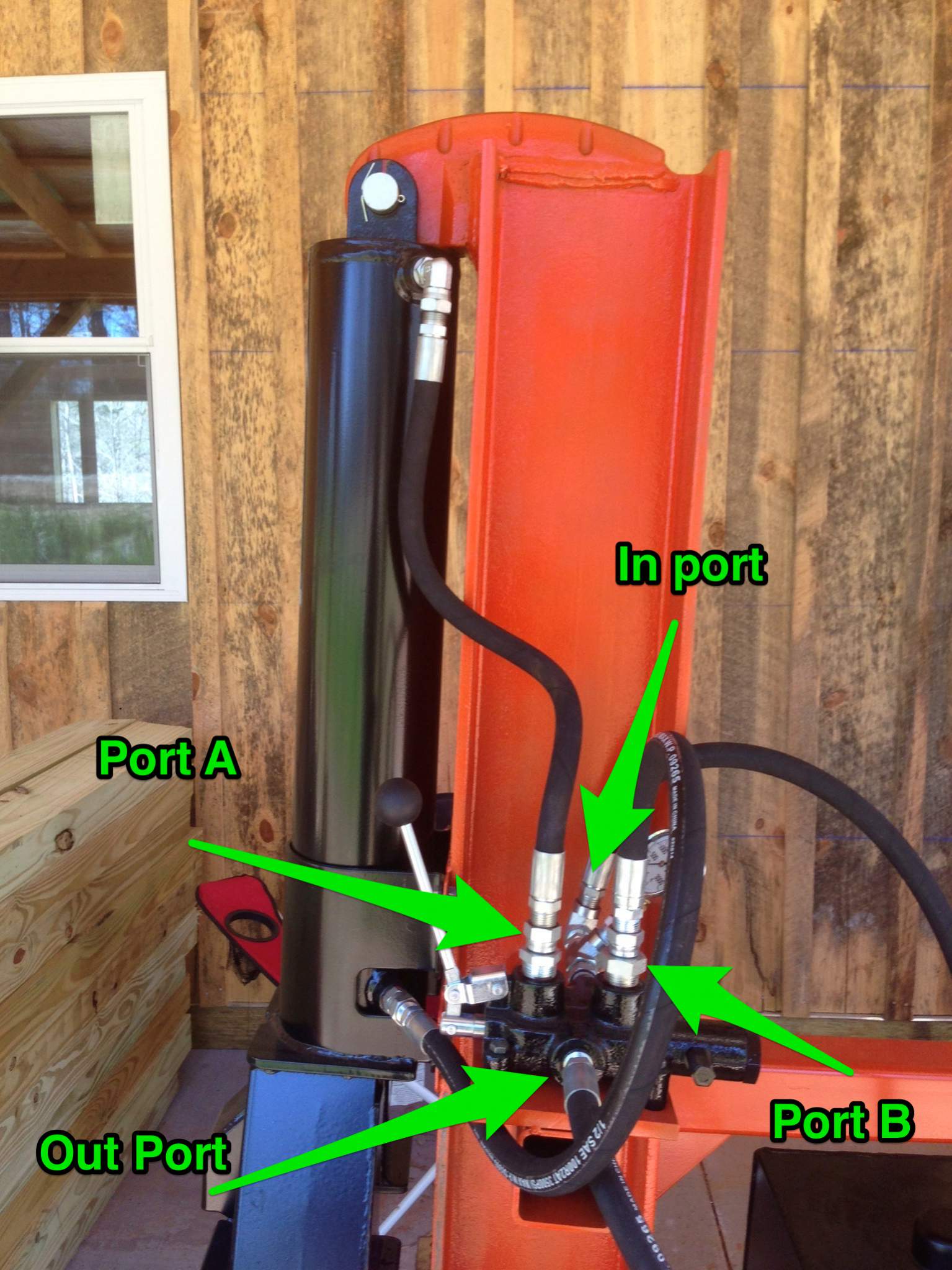

I built a three point hitch log splitter, the detent is supposed to operate the B Port. I have the B port hooked up to the lower part of the cylinder, which should cause it to retract, but instead it causes it to extend. The other issue is the valve is supposed to have a rapid extend feature, but when I try to engage that the ram sputters, like it can't decide if it should move up or down.
I've gone over the hookups but can't see an issue. I've attached some pictures to show the hookups. Any ideas on ways to troubleshoot?

It sounds like the hoses are hooked up backwards.
Unless the documentation is wrong, I don't see how I have it hooked up wrong, this is the hydraulic circuit below:
Pressure Release Detent:
This feature provides a pressure release detent for the pool 'out' (handle in) position. When the spool is manually placed in the detent positron oil is directed to the 'B' work port (the port away from the handle). When the pressure in the 'B' port reaches a preset level the detent will release and the spool will center.
/ Help with log splitter #4
The IN hose and OUT hose are reversed.
/ Help with log splitter #5
The port is labeled B as the one away from the handle on the top, the in port is labeled to the left of the handle looking at it from the top. I don't think I have those reversed.

The picture of your splitter control valve shows the hoses the opposite of what the illustration shows.

JJ not following you, the LSR-3060-3 is the same port configuration, this is from page 18, port B is away from the handle
JJ not following you, the LSR-3060-3 is the same port configuration, this is from page 18, port B is away from the handle. It does look like they show port A and B going to different ends of the cylinder though. Maybe I'm confused on which direction the fluid flowing would make the cylinder move, I assumed fluid going in to the end near the rod would cause the cylinder to retract

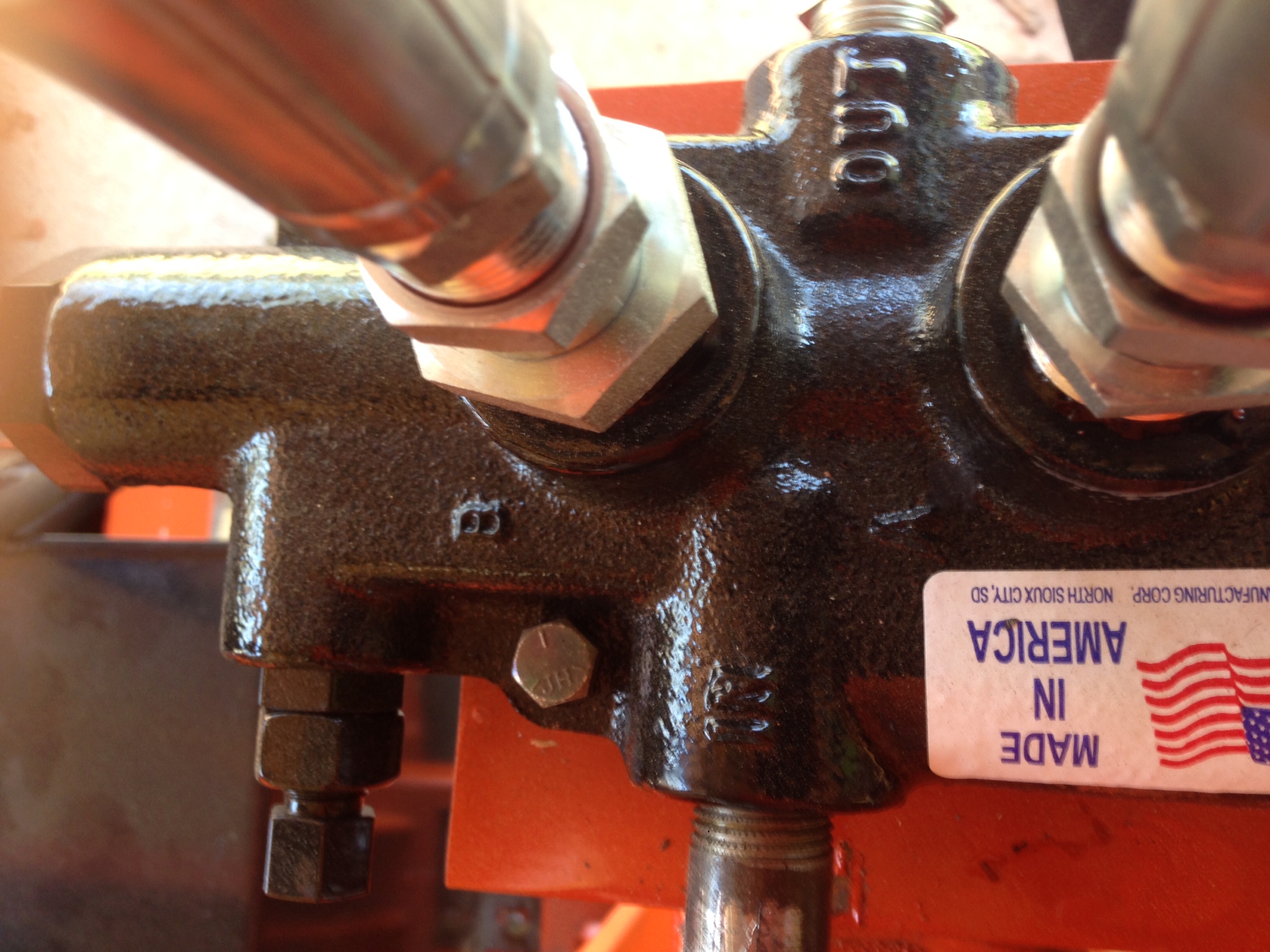

Here are some more pictures of the hookup, It looks like I do have the A and B ports reversed because for the LSR-3060-3 it says the detent valve feeds the A port.
Thanks for your help
/ Help with log splitter #13
Are those water pipe nipples in the IN port of the valve, if so I would not recommend that setup.
You really should get a regular log splitter valve for that pump.

Yes, I have one piece of black pipe going into the valve, I couldn't find a hydraulic fitting at the time, but intend on fixing it. I guess the danger is the pressure?
The valve has a regen mode and regular mode, I'm running it in regular mode right now, so I think it's the same as a normal log splitter port in that mode.
When you say my tractor pump, you are saying using something like a power beyond port? I do not have a power beyond port that I know of.
No ... the danger is that it could explode like a hand grenade ...
The pressure (and using the incorrect fitting) is just what causes the danger ...
It would be one thing to use a pipe fitting on the (oversize) return line ... quite another to place it on the pressure side.

For Iron Pipe 1/2 Standard - STD - Sch. 40
the Bursting Pressure is 10380 (psi)
the Working Pressure 1300 (psi)
Wrought Steel Pipes - Bursting Pressure
so the working pressure is less than it should be but the valve would relieve the pressure before it got close to the bursting pressure.
I do plan on replacing it with a steel hydraulic fitting though to be safe.
