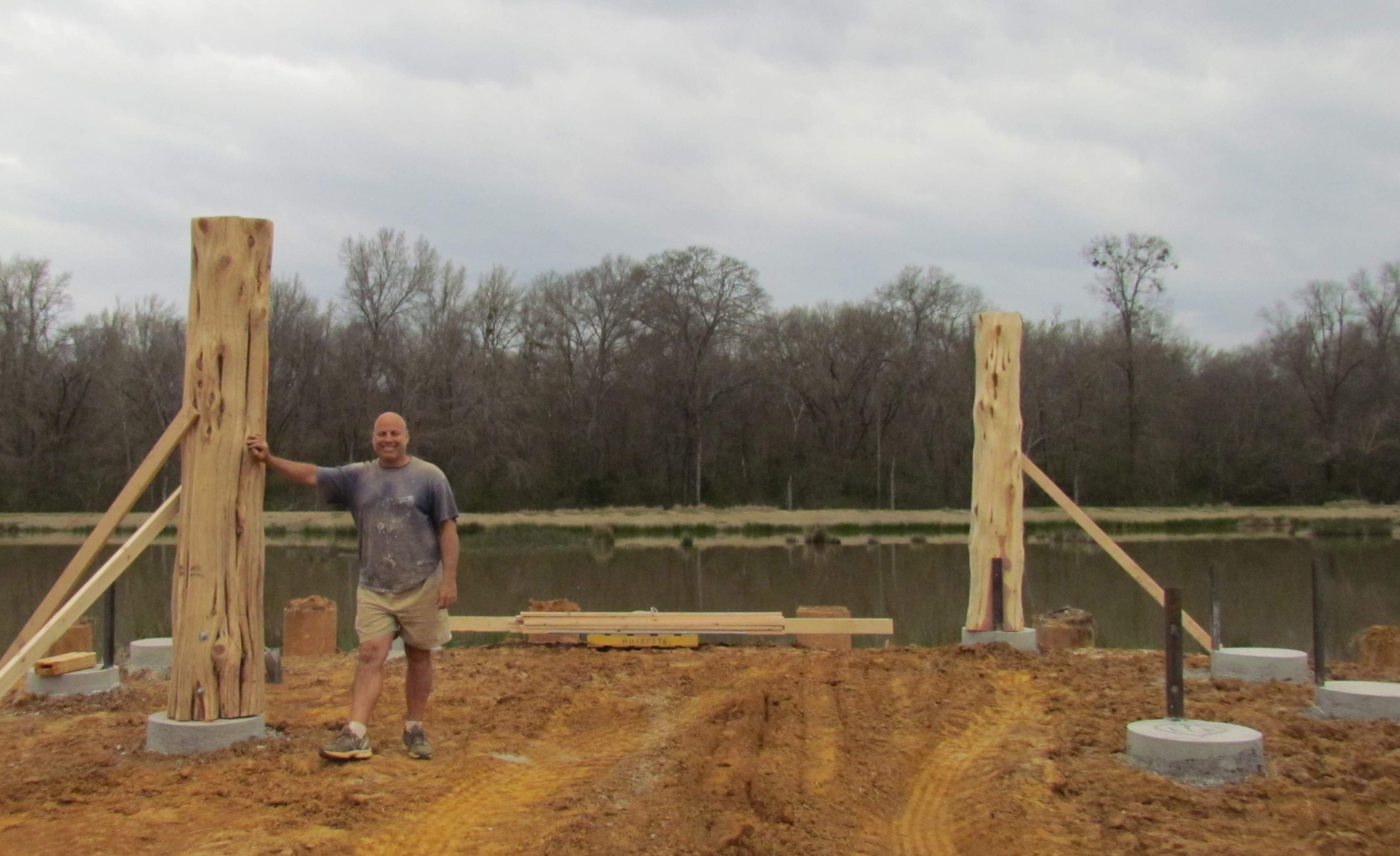

Great info, thank you!!!! I'm going with LED for sure, and wont know until I finish building the gazebo how many I want or where they will go. I'm hesitant on using lights shining up from the ground because they seem to get damaged the most and if they are in the flowerbeds, the plants sometimes get in the way. I want to light up each post and the cupola. I have a picture in my head of what it's going to look like, but until I build it, I really wont know what I want to do with the lights. This is just to show off the gazebo, and not for anything on the inside.
Eddie

As an example let's say you wanted to run some of those 50-watt equivalent Malibu lights. From the pic it looks like you have 6 posts and you want to light each post. They use 11 watts each for a total of 66 watts.
Amps = Watts/Volts so Amps = 66/12 or 5.5 amps.
So each hour the lights are on you are using 5.5 ampere-hours. A good Group27 deep cycle has about 100 ampere-hours but you don't want to go below 50% charge so 50/5.5 means you can run those lights about 9 hours. That is assuming your battery is at 100% charge at the end of each day.
Which brings up charging your batteries. You would need to figure out your average hours of sunlight, how much your panel location will get and then set up the correct amount of solar panels and a charge controller to be able to bring your batteries back to 100% charge each day. The deeper you discharge the batteries and the more often you cycle them (daily it sounds like) the more you will need to check them to add water etc. Summer heat will cause water loss as well so you may have to check them pretty often in the summer until you get a feel for how often they need to be serviced.
