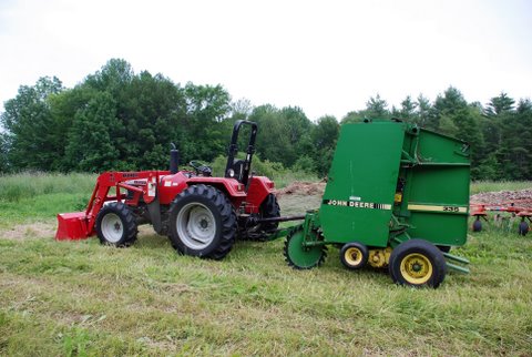

Yes it is a beast. For me bells and whistles aren't important. I've had mine for going on 4 years now. No issues. It will do everything I ask it to do. Not sure what you are planning for uses, it would help to know. As far as loading the tires mine aren't. If i need a little more weight, I hook my counterweight to the 3ph. If you do alot of road travel you will feel a little needy. I used mine for two years doing hay. Pulled an old IH mower conditioner, NH 315 baler with hay wagon on the back, never had issues. I have since bought a 95 hp Massey to take over mowing and baling, just didn't want to wear the Mahindra out before it's time. Last year I was in a bind and needed to get hay up before the rain. Borrowed a friends round baler. The Mahindra did just fine. I do believe that I found the limits that day though. The round baler was just border line of being too much. At the end of the day I wish I had opted for dual remotes. Lets say I spent more time switching hoses than baling.

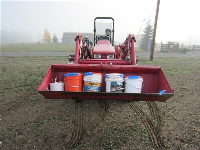

My 2008 Mahindra 5525 (54 hp engine, 45 hp pto, 2WD, power steering, gear tranny 8F/2R, triple rear hydraulic remotes) is a nice, basic, affordable machine. With the ML250 FEL (6-ft wide bucket, 2950 lb lift to 10.5 ft height, 3 chain hooks on the bucket, skid steer quick attach) the weight is about 6200 lb. Cost: ~$19K new.
