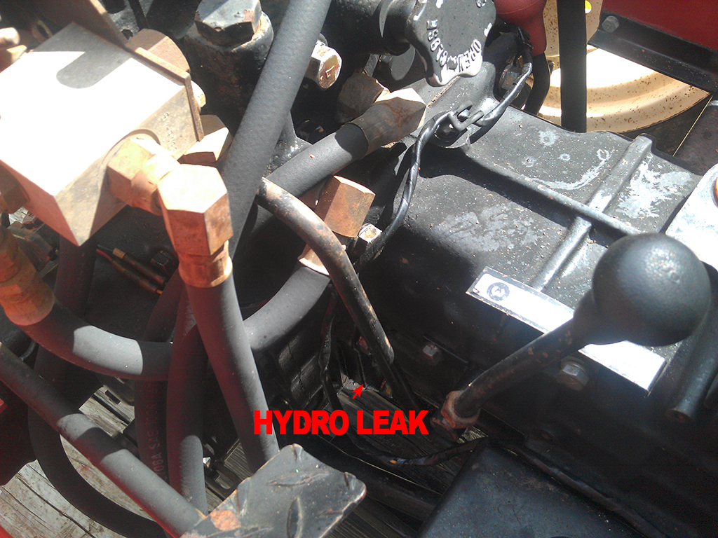

Hi everyone,
I went out and bought another yanmar this weekend, got a good deal on it but it needs a few things repaired.
I attached the pictures for reference and hoping someone can give me some advice / experience with this.

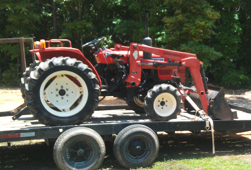

Tractor is a YM226D with Yanmar FL800 loader, US model with power steering.

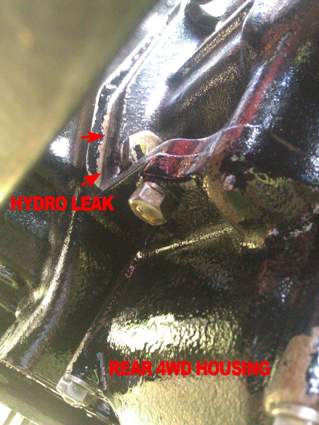

1. It has a pretty steady hydraulic leak in rear where the entire rear section of tractor connects to the transmission area, it has 6 #7 bolts holding the rear to the mid section? (I guess I'm describing it right). It appears the tractor needs to be split back there to replace a seal but I do not know what the part is called, anyone help me out with what the proper repair is called for that area?

Check the Hyd. Vent. Sould be a U shape tube under the seat. That would be a good place to start... On your Solenoid use a test light on the Terminals and check for power to it when you turn the key on. My bet it's bad
/ Help with new ym226D purchase #3
If I am understanding correctly about your leak I don't believe it has anything to do with a seal leak. Everything in that area should be filled with transmission fluid. Looks like a gasket leak to me. Have you tried snugging up on the bolts just making sure they are not a little loose? If the bolts are not loose I would probably shop around for some kind of a sealer, clean the area, apply the sealer and see what happens.

Does anyone know what the part number is for that gasket? I don't see it on Hoye.
a parts manual in pdf form would make my day,,if anyone has it
Also, as a temporary fix, any recommendation on what the best product/sealant is for use on the exterior to seal that crack?
Fluid drips even when the tractor is parked. just a steady drip every 20 or so seconds.

Click on the first item on this google page and you can download your parts manual. lozeman yanmar 220 - Google Search
If your gasket is reference #31 on figure 40 of the parts manual (194420-24120) here is the gasket. http://www.hoyetractor.com/mm5/merchant.mvc? I may be in the wrong place, you can determine that.
Well copying that part number didn't work. You can just type in that part number in the Hoyes part "search" field and it will bring it up for you.

It is a cylinder, so likely added later..I have no way of knowing. works nice though
Thanks for the parts manual link! and yes that is the exact gasket that is leaking...any chance you got info on how to make that repair?
Now what about sealing it on the outside with a sealer? bad idea?

I don't know whether it is a bad idea or not. I do know I would try it before taking all that apart. I am not familiar with all the different sealants. Maybe someone at the auto parts counter could give good advice on that? Did you double check the bolts just to make sure they hadn't loosened a little?

I did check the bolts, hard to get to but they feel tight to me..I would have to remove some things to get good torque on them..
That gasket is a $4 part..haha but that Labor is likely a whole day...
/ Help with new ym226D purchase #13
Sealing from the outside wont hurt anythng.
I would use RTV black or Grey (my personal preference) and use carb cleaner or brake clean and spray the area clean after you have drained the fluid and it stops dripping. I would spray clean then let dry then spray and wipe clean then spray clean one more time. If its stopped dripping, go around the mating area of the gasket with a thin bead that you hand spread to above the fluid line on the split surfaces. It wont look pretty but should stop a leak, for a period of time.

If I was going to try and seal it w/o splitting it I would drain it and clean it super good with brakekleen and air and make sure all the bolts were tight as has been mentioned and use high temp gray just because that's what I have on hand always.
Let it sit overnite with the cap off so there isn't any pressure. I have sealed a/c and radiators with glue and we usually put them under a vacuum and that theoretically pulls the sealer or glue into the crack whatever but it does work. Good luck on the nice new tractor!
I suppose if that fails it could be drained and split a fraction of an inch and sealer put in place and tightened all back up in that case I would use anaerobic. just my .002
