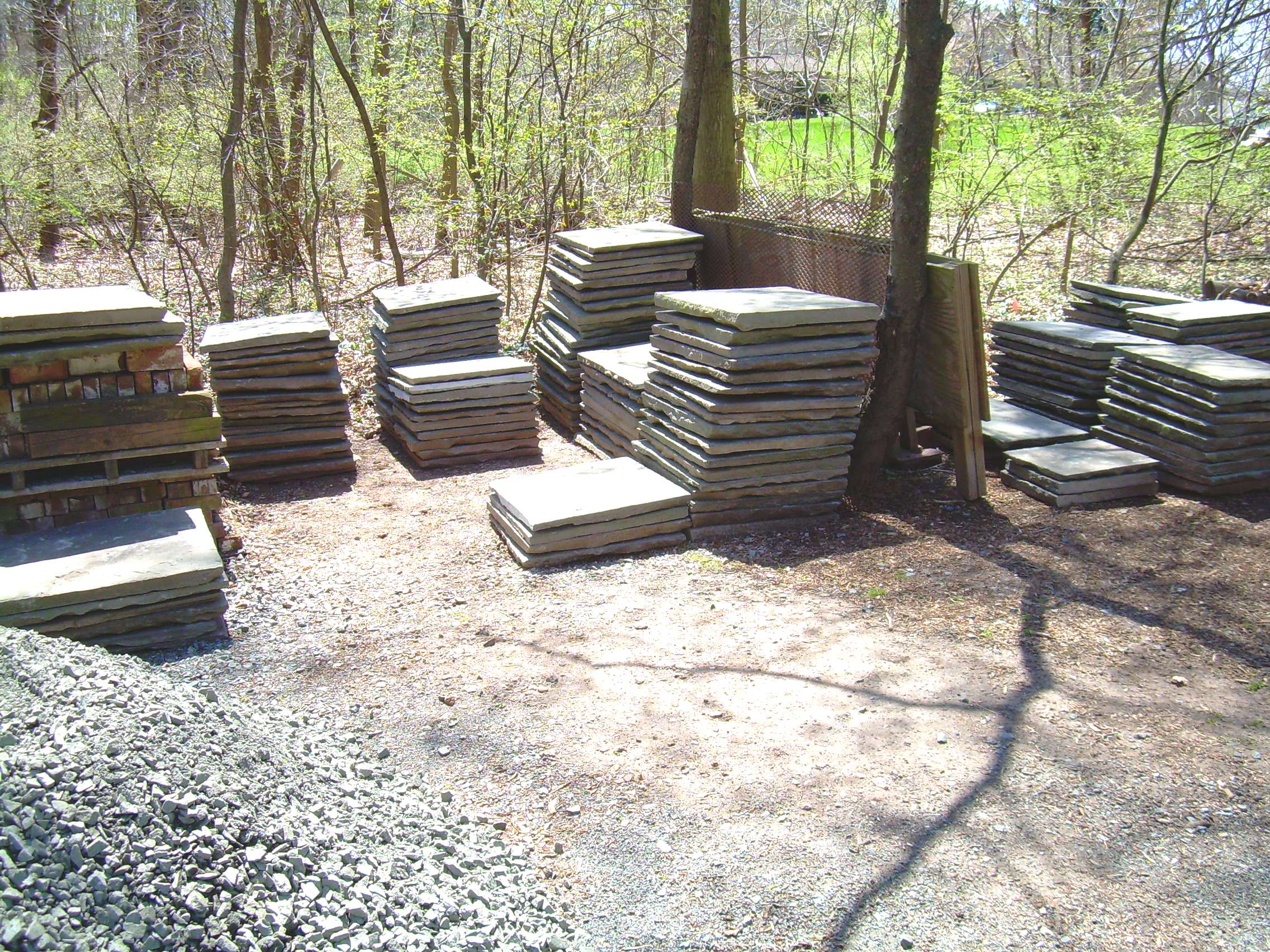

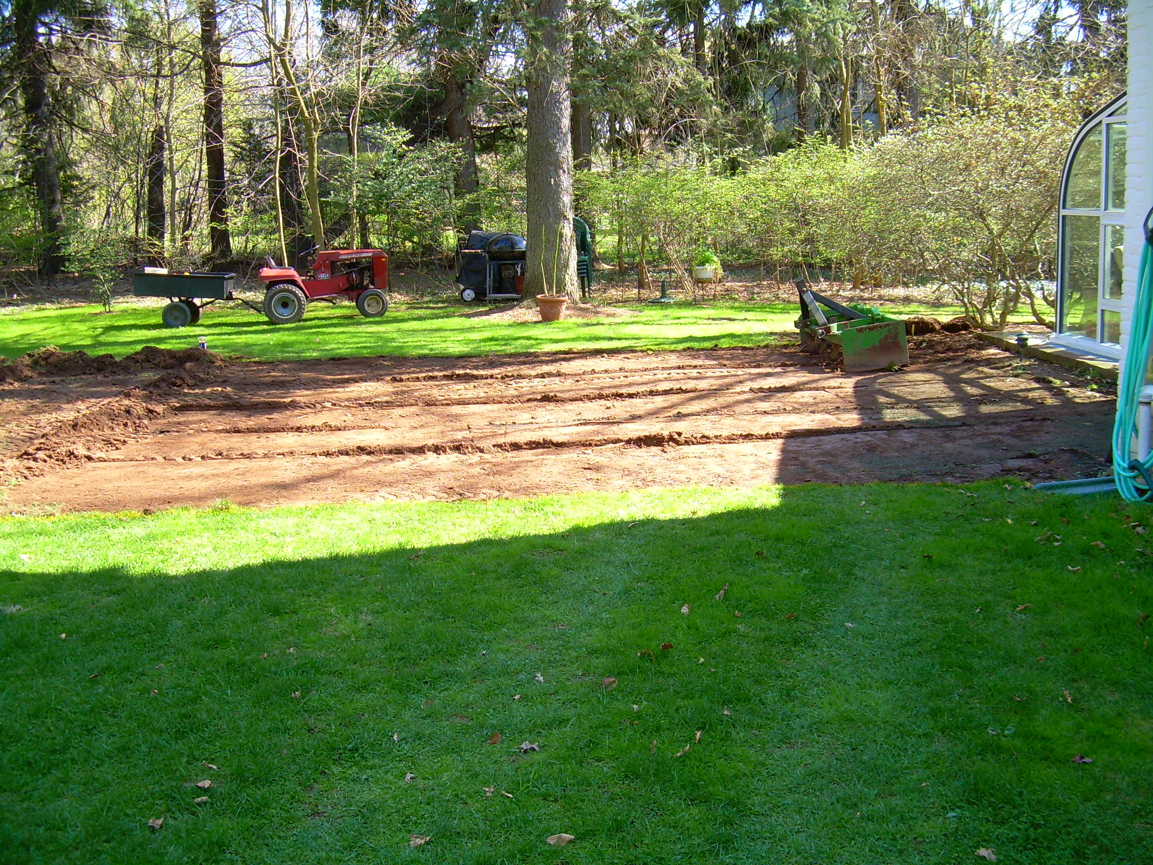

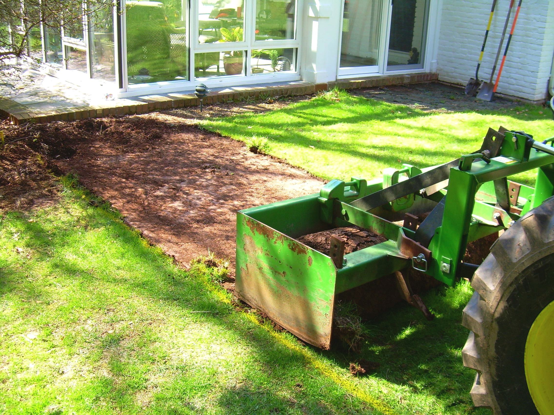

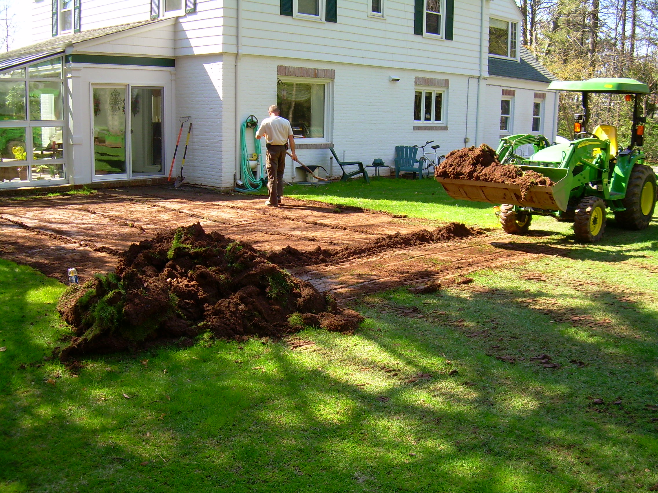

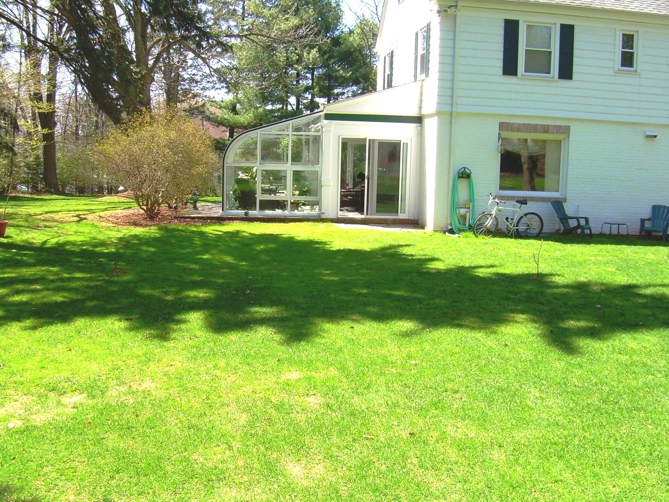

Well I started prepping the site,
Thanks for the replies :)
I haven't decided for sure, but am leaning towards just doing straight lines, these stone are all 24" wide so I would have a straight joint every 2 feet, the lengths vary so there would be some random look to it. I've seen many stone patio pics and am kinda getting tired of that style, I know that is the standard but I think I'll try something different. prepping an area 20ft x 24ft.
Riptides,
I would like to see pics of yours, maybe I'll get some ideas.
Yeah my stones are all different thickness, I'm sure that's gonna be fun, they vary from about 1.25 - 2.5.
I'm digging down 8 inches, I'll put about 4 inches of compacted process road base, then stone dust to bed the patio stones.
I'm thinking of running a course up both sides then filling in between the with the courses perpendicular to the sides, this way I can stretch a string between the sides to help with setting the stones level.
JB.

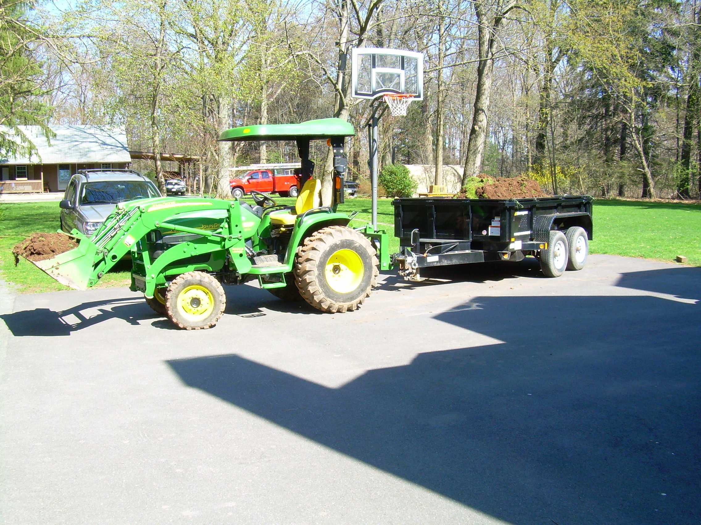

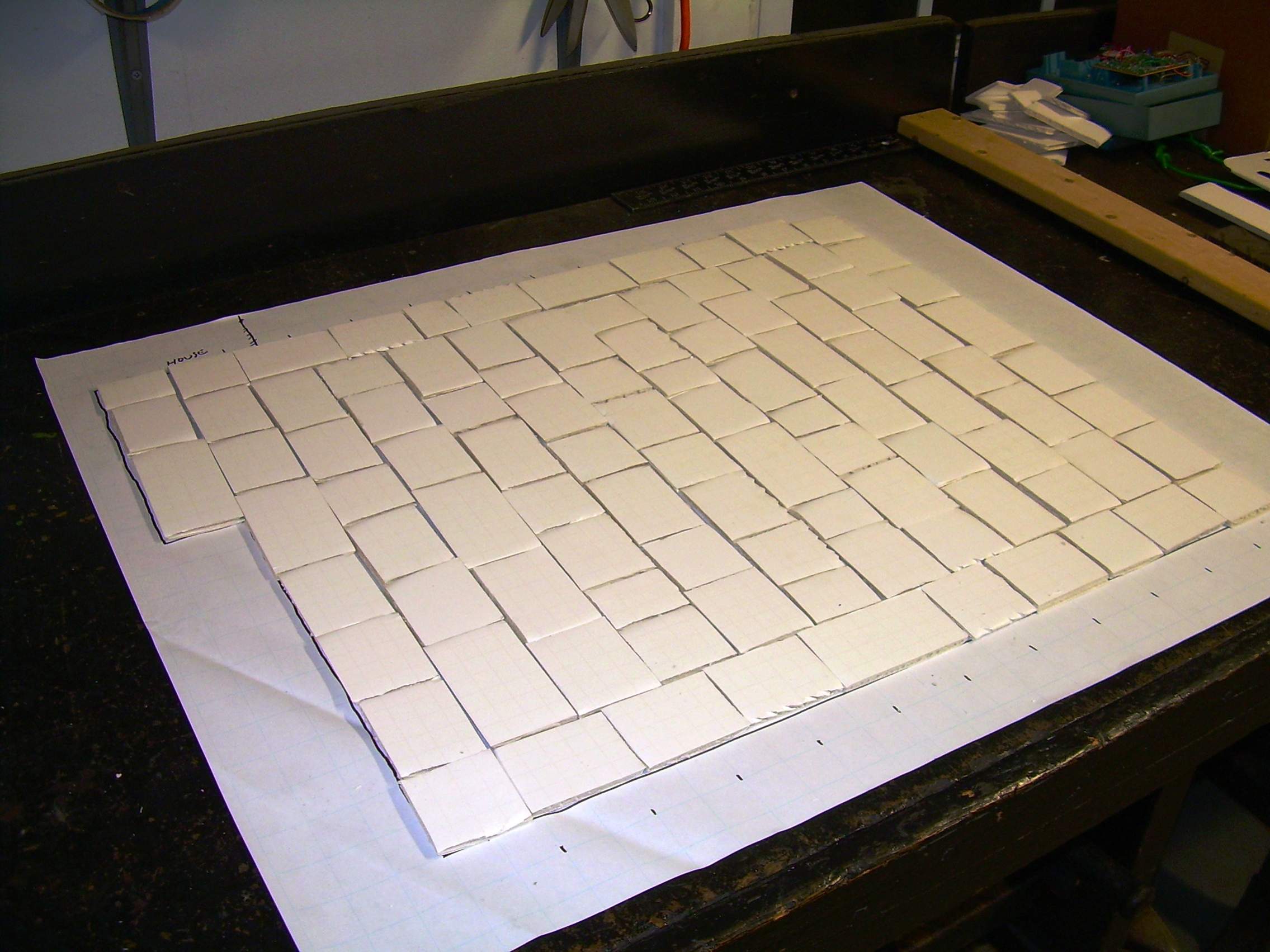

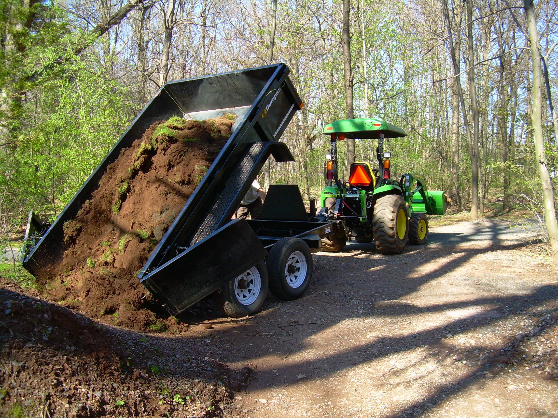

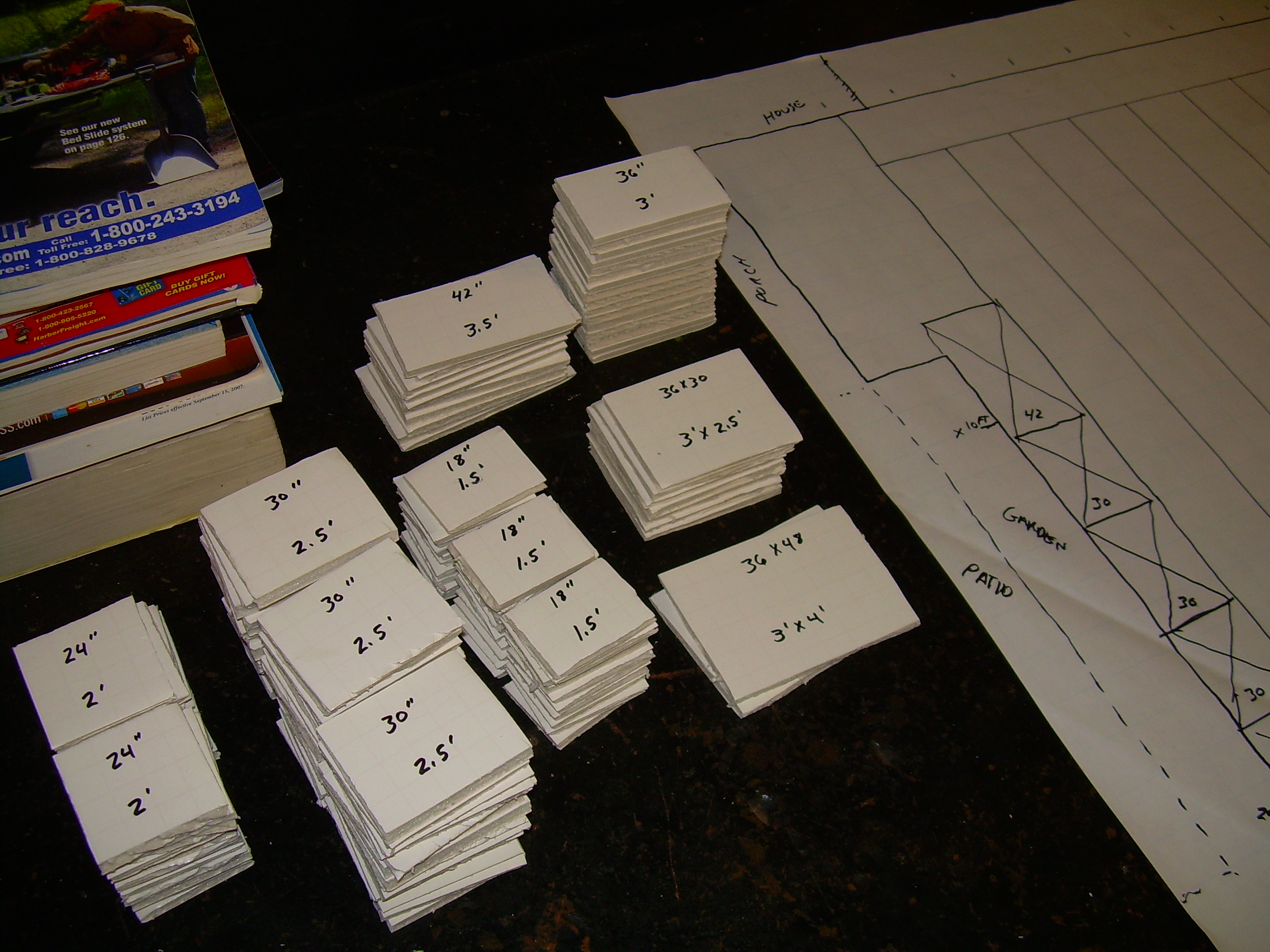

Yeah I gave up on the drawing program, I fooled around with Sketch Up, but ended up going back to my cave man roots, I took the paper doll concept a step further and cut 1/4" foam board to scale and got some oversize graph paper where 1" equals 1 foot.
It was a PITN cutting all those pieces but they are alot easier to move around than the stone! Once I get it where I want I'll pick up the piece and mark the graph paper and then I'll basically have a blue print and wont have to think what the next stone size or location will be.

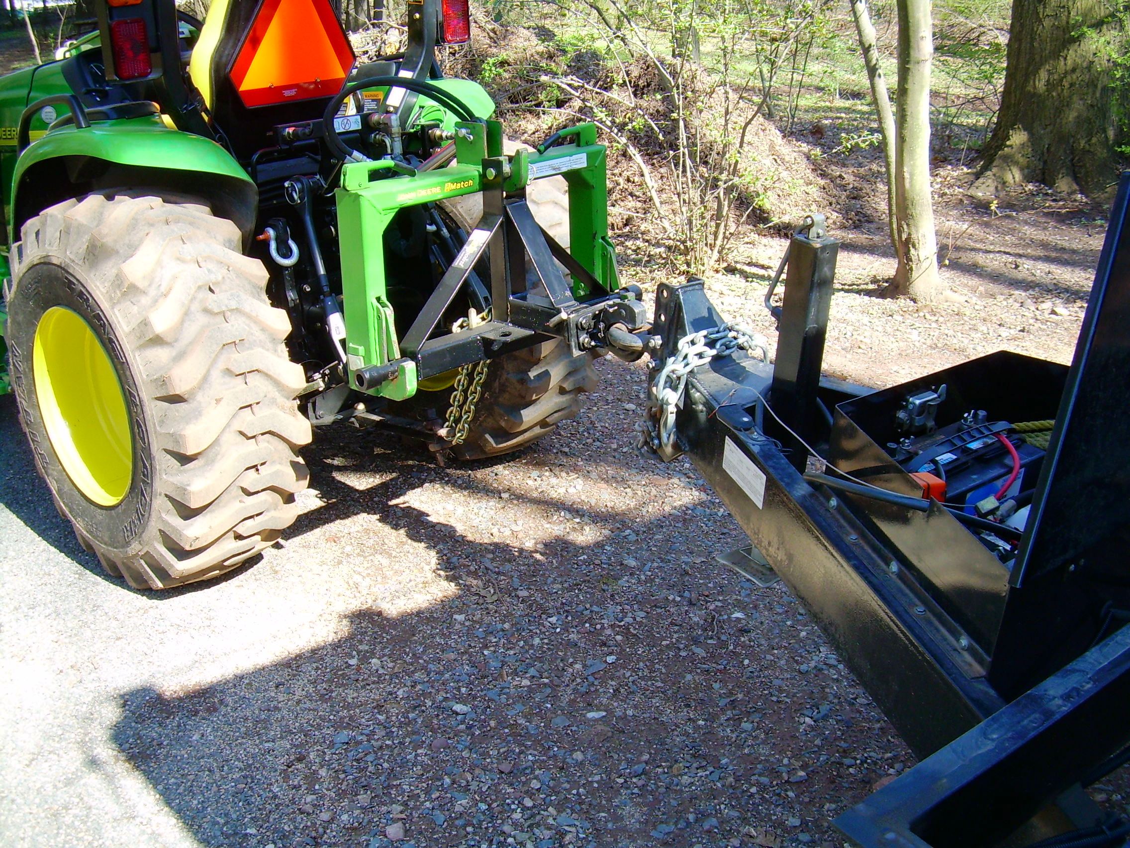

The HTL controlled 5 ft boxblade is making the prep easier, also using the dump trailer to bring the spoil out to the far backyard. Having the quick hitch makes it easy to drop the box and throw the receiver adaptor on.
JB.
