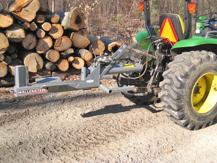

Thanks for the guidance, got it hooked up and running today. Works great, now We went through almost 5 cords this winter, now its time to stock up for next year. I just need to keep those boys working on the woodpile and keep their fingers away from the nasty bits of the splitter! I really like this set up since I can lower the 3ph to roll big logs on that are too heavy to lift.
