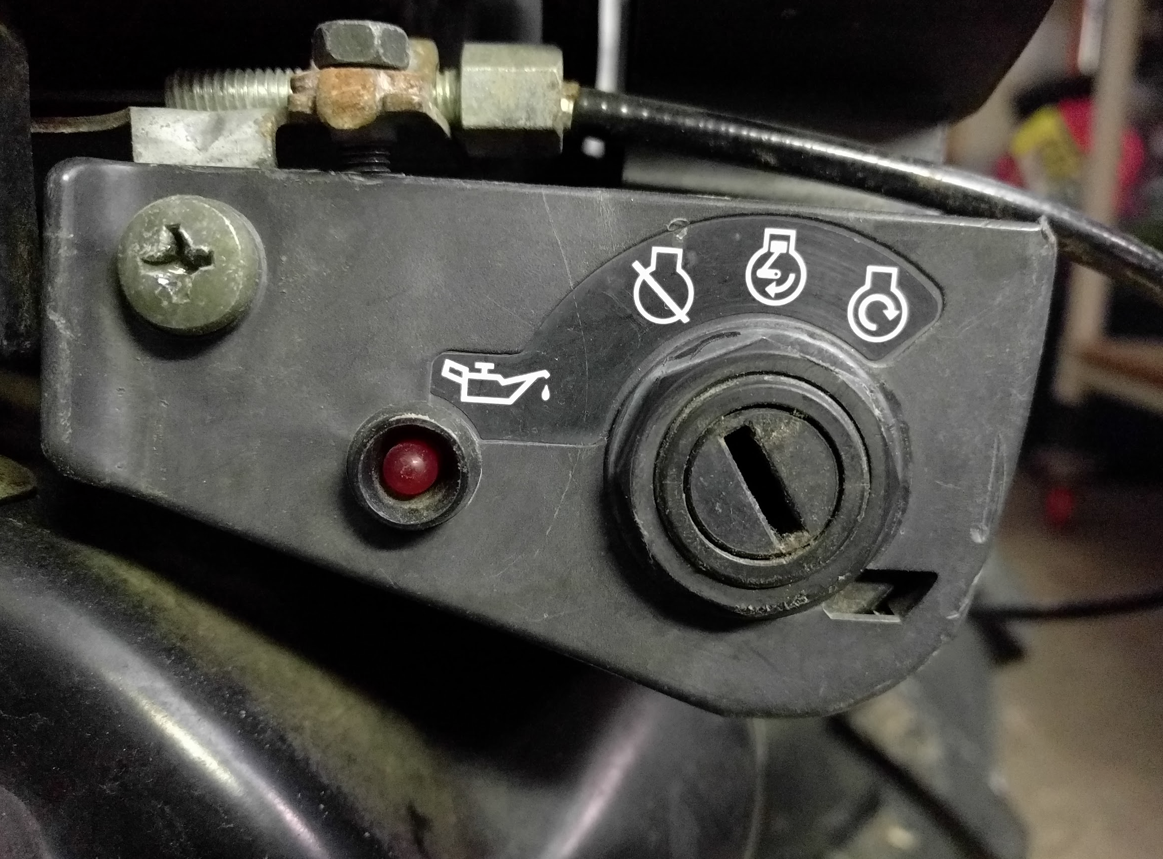

I picked up the BCS this morning. It was not repowered according to them.
However, it does not have an ignition key. I believe this is the replacement part - BCS America Part 58.4586, KEY FLAT COBO 1418 | PartsTree.com
Also, I found out that the machine came with an additional implement - a water pump.
Thanks for the help to everyone in this thread.
   / Help with pricing a BCS 850 with attachments
#16
However, it does not have an ignition key. I believe this is the replacement part - BCS America Part 58.4586, KEY FLAT COBO 141918 | PartsTree.com
It appears that key may not work, that part I think is for a diesel engine. So far I've just found this guide... http://www.earthtoolsbcs.com/pdf/LOMBARDINI_keys.pdf
I am having trouble locating the proper key for this switch... any ideas? Picture below.
   / Help with pricing a BCS 850 with attachments #17
My guess is it's a generic "Equipment" key. I'd contact Earth Tools or take it to a trusted local Kohler dealer.
#18
Thanks Bill. I took out the switch and will be bringing it around to local dealers to try my luck with local stock first.
