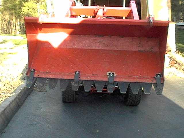

   / Help with sapling puller? #26
I made my teeth bar to get rid of all the honeysuckle shrubs on my property. It's made out of 5/16 plate and I havent bent anything yet. It also makes stripping sod a lot easier.
