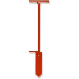

Rick is that called a dibble bar? I have used those on pines that were a year old.
Yes dibble bars are made for tree planting but I was guessing most of us did not have one and did have a digging bar which works as well or it did for me.

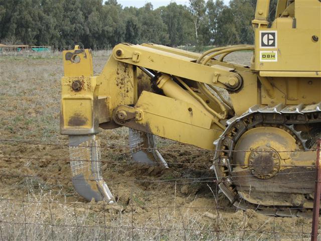

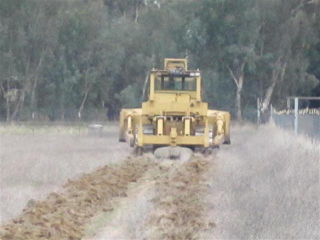

You can rent tree auger rigs from places like Home Depot and dig those 100 holes in a day.
I'd dig a small trench with your TLB and locate the depth of any hardpan layer. This will give you an idea of the depth you need to go with the auger.
Around here we have thousands of acres of orchard. Generally the ground has to be ripped using Cat bulldozers with 4-ft long shanks to break up the hardpan. My neighbor recently planted 8 acres of English walnut after running a big D8 Cat over the field to rip the hardpan.
Don't say you have to go to this extreme, but checking the hardpan depth is a good thing to do before planting that number of trees.
Good luck.
