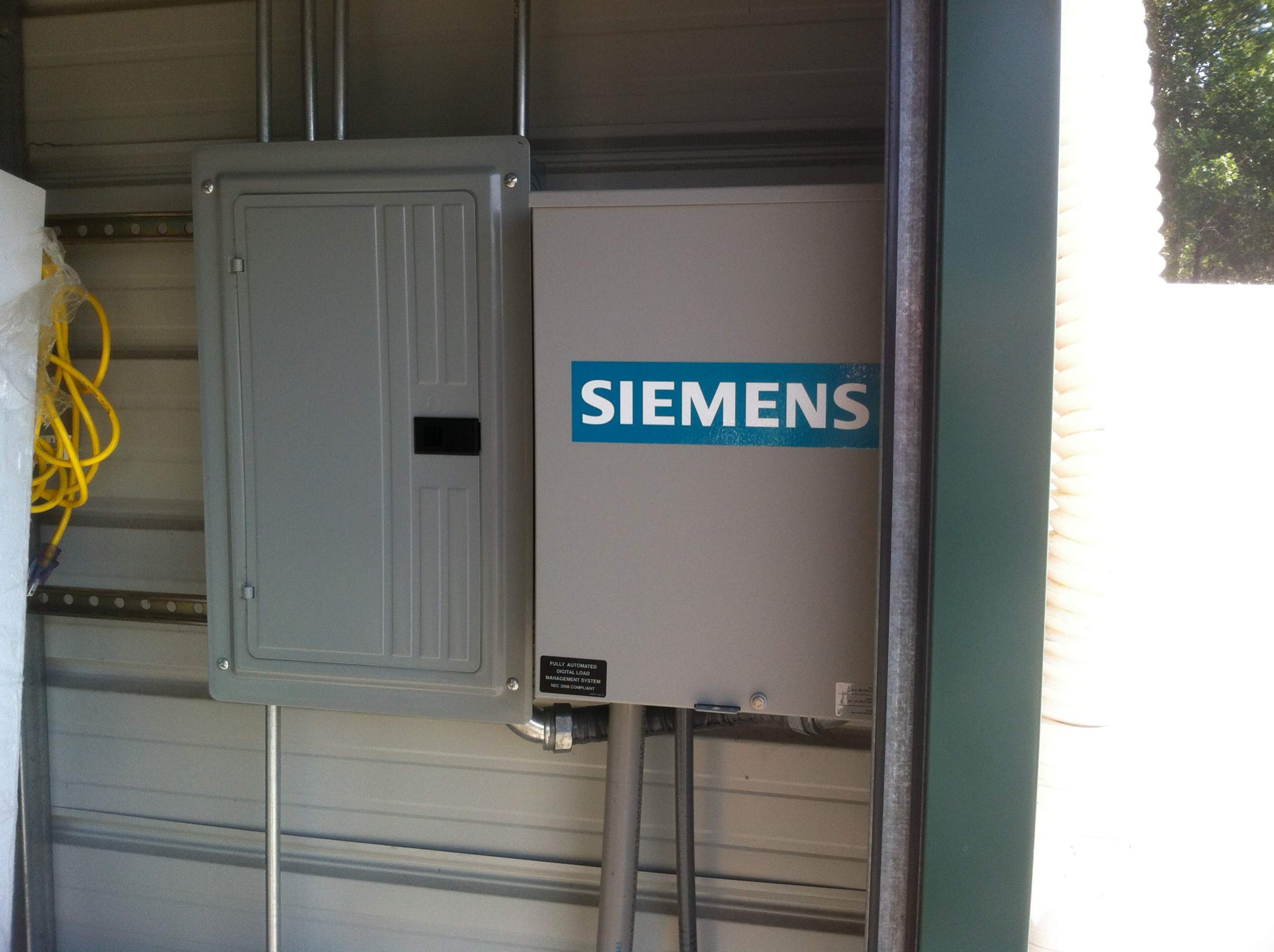

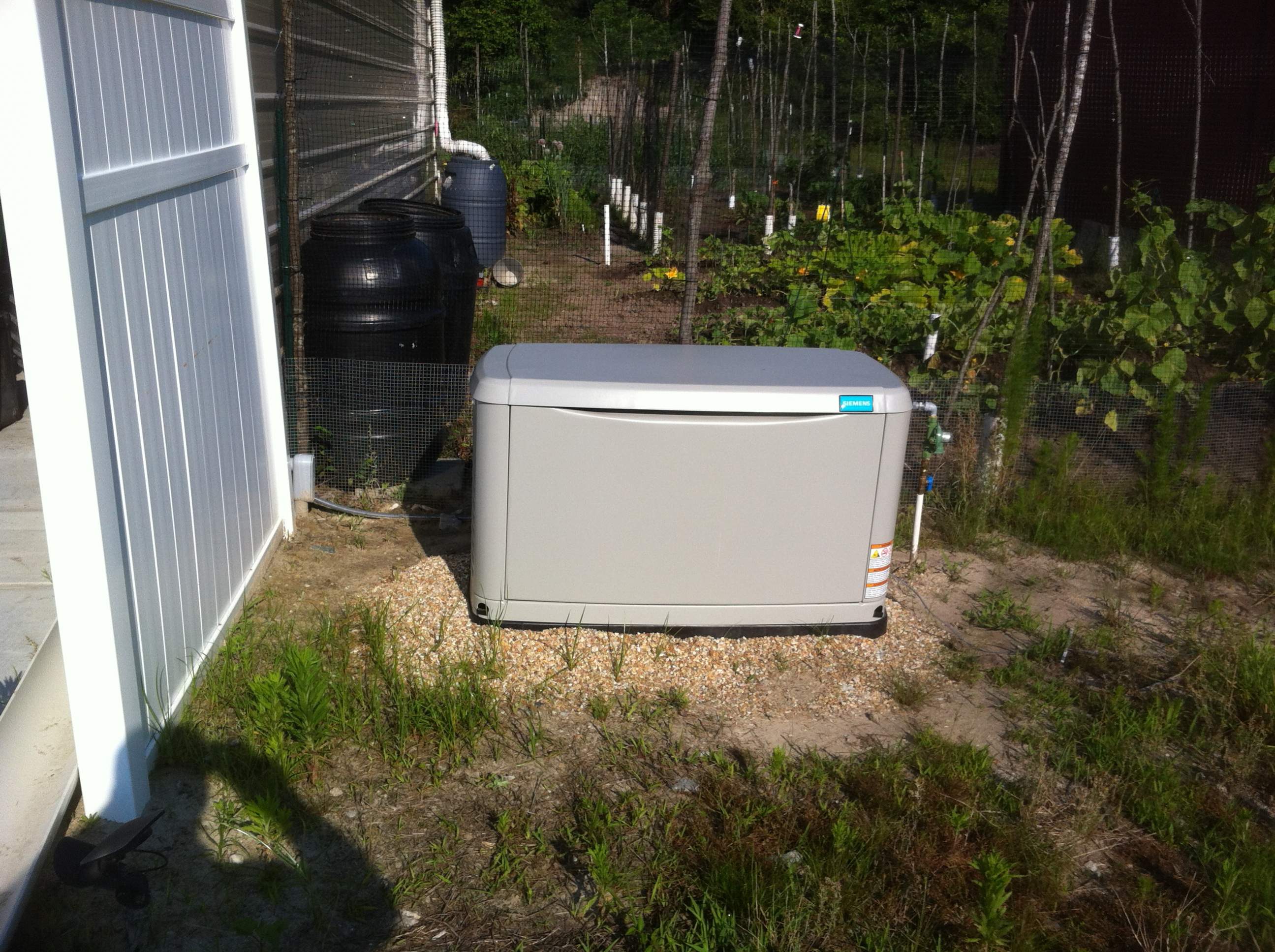

I know I am causing my own problem, but hoping someone can help me overcome!
We have no utility provided electricity on our land and desire none due slightly to cost, but mainly because we would have to deed a rather wide and long right of way to the utility company.
I had a Siemens (Generac) 14Kw (ASKN014RBS) generator installed to be run by propane under manual start. We had the building and lean to wired like a home with a breaker panel and the Siemens Automatic Transfer switch panel. We had to have the Transfer switch panel because the generator pulls the current to charge the battery through the Transfer switch. In our case when the generator is running it recharges.

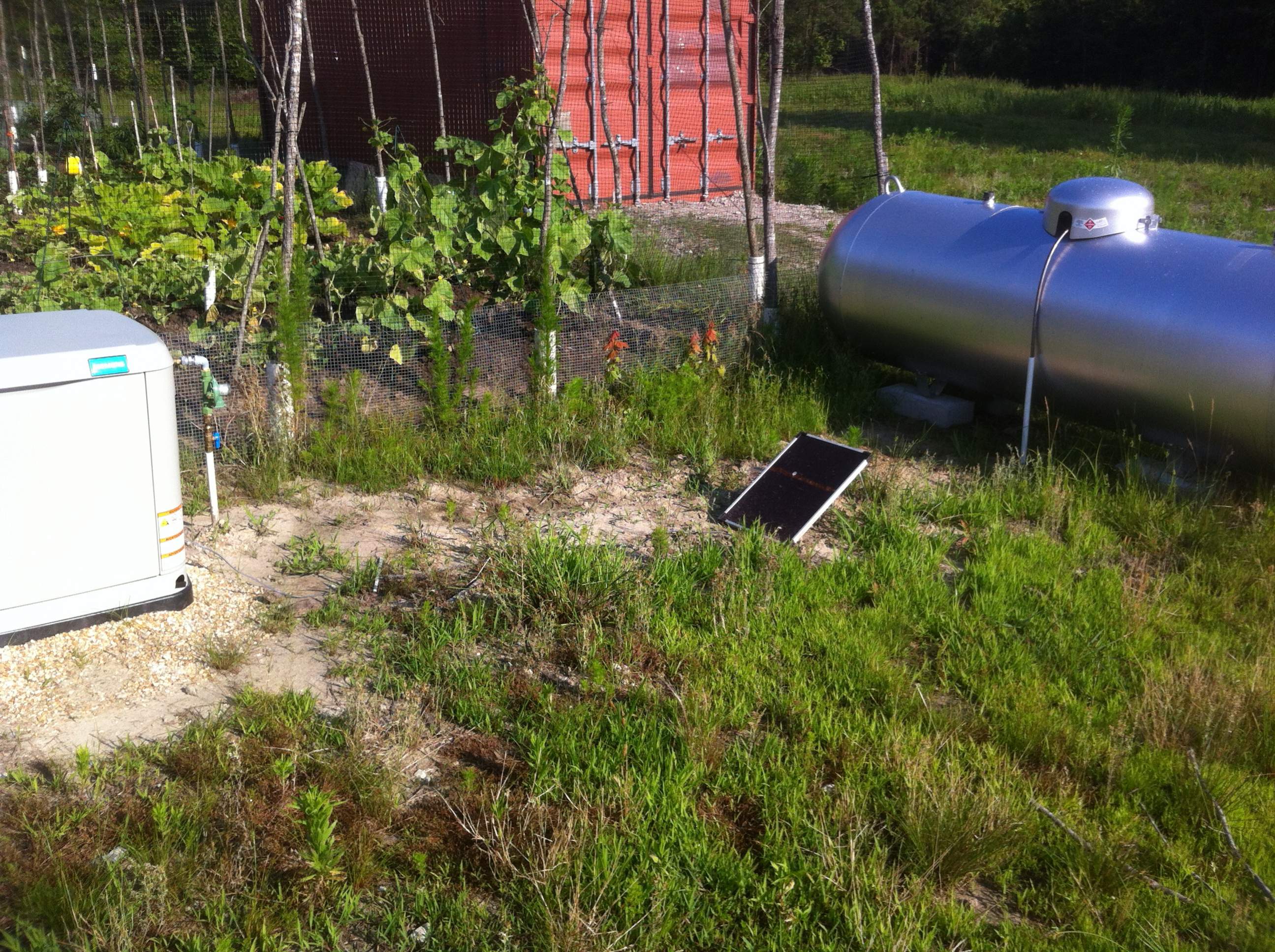

Our problem is that the unit has a digital display and many functions that run 24/7as safety and maintenance checks. Thus when we are not at our land for several days the battery is completely drawn down. I brought a 5W Solar battery charger from Harbor Freight, not realizing it needed a diode or fuse to prevent the power provided by the solar panel from drawing back into the solar unit at night.
I have since ordered another panel with the diode that prevents the flow back.
My question: Could anyone provide a link to the generator wiring diagram and do you think we could disconnect the digital display and the functions? I have the Transfer Switch diagram URL.
That said, I worry that without the function checks, there may be a maintenance or safety issue and I would not know until it occurs. Voiding warranty is not an issue as Generac voided the warranty as soon as I put the generator in as it can not be the Prime utility provided.
Photos are attached. We use the generator for lighting, well, compressor, portable generator and future items such as a trailer. Thank you, Jim

Before doing much with the small solar panel, I'd measure what the current draw is on the battery when the genset is shut down. Only that way will you know how much power must be replaced to keep up with the current draw.
Secondly, what do you intend to do with the small panel shown in the first pic? Surely you don't intend to leave it where it is. Also something need to be done to address the problem of snow in the winter.
Lastly, don't know how large your propane tank is and it does look like you're pulling off the top of the tank. The rate that propane can vaporize is dependent on temp and surface area of the liquid propane. From data I saw on the Yanmar site, a 450 gal tank can just barely handle a 7kw genset @ 20ー F. Better approach is to pull the propane off a wet leg and have the propane vaporized in the genset enclosure where it is a lot warmer.

ES and Mickey. I should have thought about it, but I did not check to see what the monitor function power draw is. I had hoped getting the small 5W Solar panel would keep the battery with a balanced charged. I ordered another with a diode to replace the one on the ground. I understand that at night I could loose the solar power provided without a diode to prevent the flow back.
I put the panel where it is until I could mount it, or another one, perpendicular to the sun. The electrician connected the leads from the panel direct to the generator battery.
The propane tank is a 350 gal tank and they put 285 gallons in the tank. Local code said the tank had to be where it is (10 feet from the generator). I see Mickey's point about the propane and solar panel, plus ES, what I think you are getting to, which is no inverter.

You don't need an inverter unless you are trying to run your house from a battery. In your case you just have a little starter battery for the genset and the solar panel you bought will be fine. By the way you could also have added a diode to your first panel instead of buying a whole new panel but either way you should be good.
   / Help with standby generator as prime utility provider #8
If you are not on the grid I don't understand why you need a transfer switch. You said it was for the battery charging circuit. Couldn't you just hook up the battery charging circuit to a breaker? When the generator is on the battery would be charging. As far as the digital readout goes it's for the transfer switch that I don't thing you really need since you start your generator manually. It's not monitoring anything if the generator is not running except the state of your starting battery which it will tell you its dead after it runs it down. I may missing the whole concept here so let me know your thoughts on the transfer switch.

As far as I know the only thing the monitor system does when the genny isnt running is auto start it every 7 days..... They do this because as backup power it might go years without running, not good for an engine.
Not sure how often you are there but if you are there every month or two, running it you shouldnt need to run it every 7 days.
My guardian has two small fuses on the panel that can be pulled to kill all power to the electronics.
Or you could just disconnect the battery when you are not there.
JMHO
   / Help with standby generator as prime utility provider #10
If all your doing is starting the unit daily for power, let the charging circuit on the gen. set take care of the battery.
If your only starting it occasionally, set the exerciser timer for weekly for 2 hrs. and let it run.
