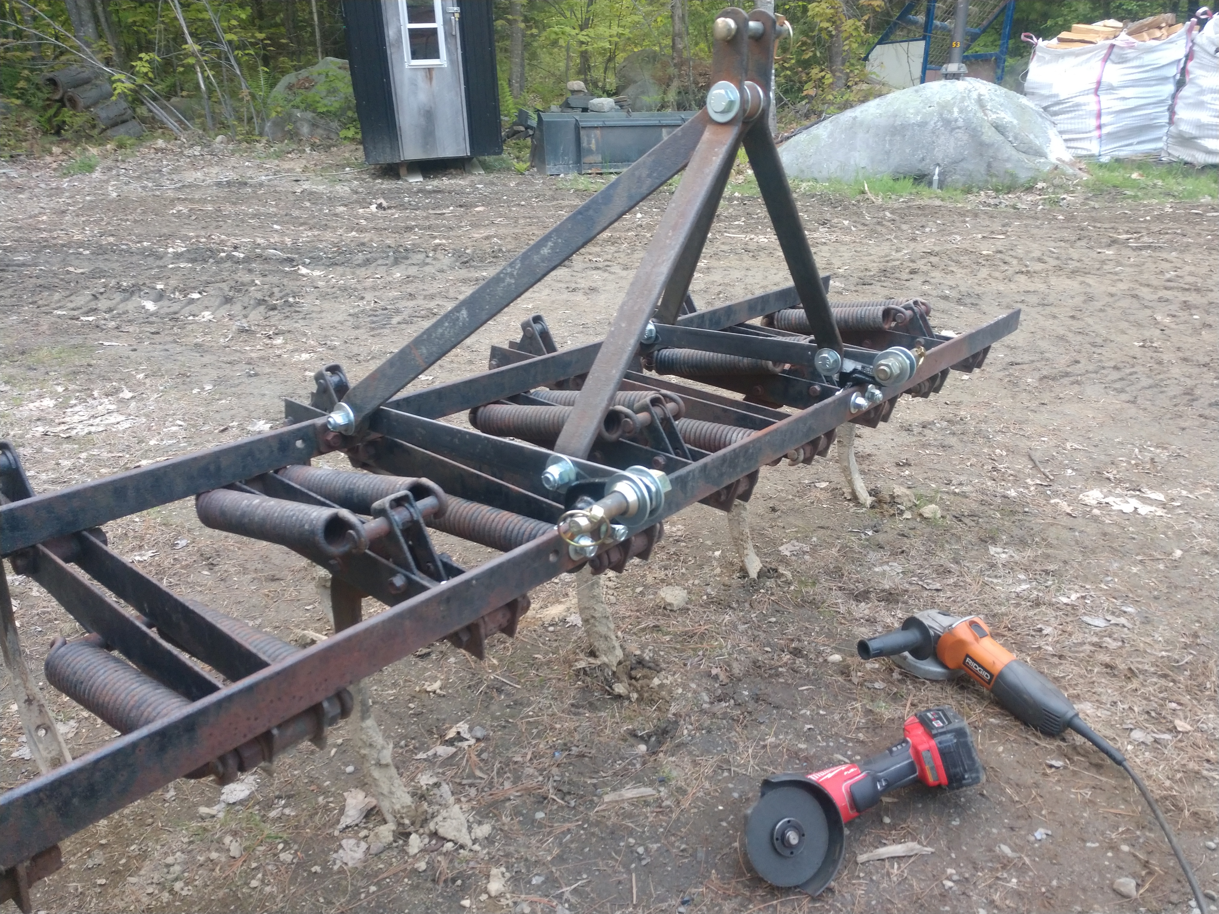

Looks like to me the arm with orange arrows are on the wrong side of angle bar, that angle bar top lip needs to be cut off or replace with 3/8" flat bar, and the front arm needs to be on same front pin bolt.
I think if I follow correctly everything you said is correct, but I only had angle to work with, I will probably swap it out but I haven't had time to get to the steel store. Either way it doesn't move where the pin is located and the tool bar and lift arm are what interfere with each other, I will mount it up and get some pictures today.
   / Help with this old cultivator!
#12
Spent some time with the grinder and modified the bracket so they would fit backwards. Also got some flat steel and changed out the angle. Now I just gotta get it mounted and test the fit.
   / Help with this old cultivator! #13
Well it looks better, should work and you'll know for sure when it's hooked up.
