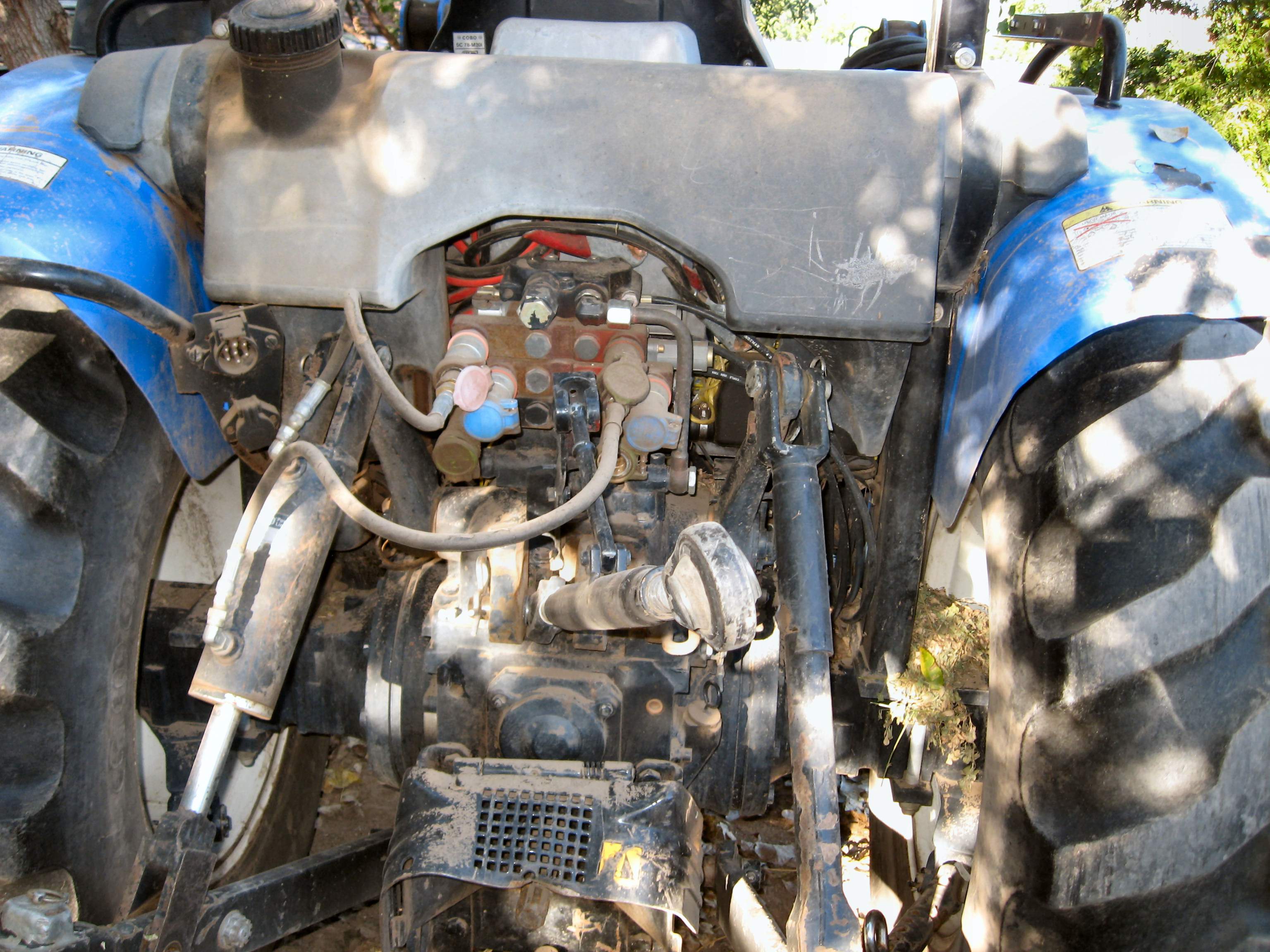

Hey Pappy. My rear remotes don't have any visible collar. They have a spring-loaded protective cover, but I don't see a collar like on a typical female quick connect. Is the NH unique, or am I totally missing something? Thanks,

Some of them are push/pull breakaway connectors. Perhaps yours are that way?

Yes you have push-pull couplers. For disconnecting, you push in and then pull out all in one quick motion. For connecting, just push the male end in. No outer sleeves to fool with. If you forget to disconnect from an implement, the hoses will disconnect on their own and no damage should be done to either end.

So, one more question. I've heard that some of the rear remotes have a float position/option. How would I know if I have that, and which one of the remotes would have it? I assume it's a mechanical valve and would be different from the others? I guess I need a description of what 'Float' does for me too. Take care,

The control lever will act just as your loader joystick acts, push the lever forward and then just as the loader lever sort of goes just a bit further and locks in place, that is the same as the rear remote with the float function will act. In any other position it will simply spring back to the center in the closed position.
A std control valve will have 3 separate positions, A control valve with the float function will have 4 separate positions, typically the float position is all the way forward in the detent position.
As far as what you would use it for, I need to write a book about the uses,:rolleyes: but a couple would be for use with the top & tilt cylinders. Don't be surprised if you do not have the feature,:( but then again with New Holland it would be no surprise if you had 1 or more with the float feature. :cool:
