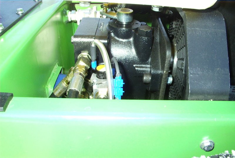

On my 2001 model with the kohler, there's a gap between the VVP and the engine. The VVP is mounted to the fan side of the engine as shown in this picture...

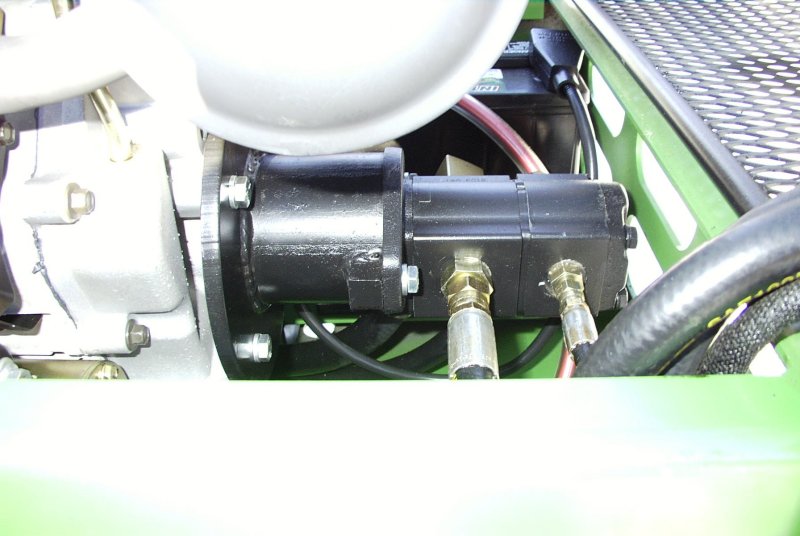

The PTO pumps are mounted to the "normal" output shaft behind the engine as shown in this picture...
I believe almost all of the units made since 2003 or so have all three pumps mounted to the output shaft side of the engine, with the VVP first, then the PTO pumps piggybacked onto the VVP. So there is NO gap on that mount from the output shaft to the VVP.
Take a look at the fan side and see if you can see anything in there. If the fan is plastic or flimsy, don't bother as you may damage it. But it you can stick a bar in there, with the plugs out, you may be able to spin it easily with a flat bladed screwdriver from the rear of the tractor.
