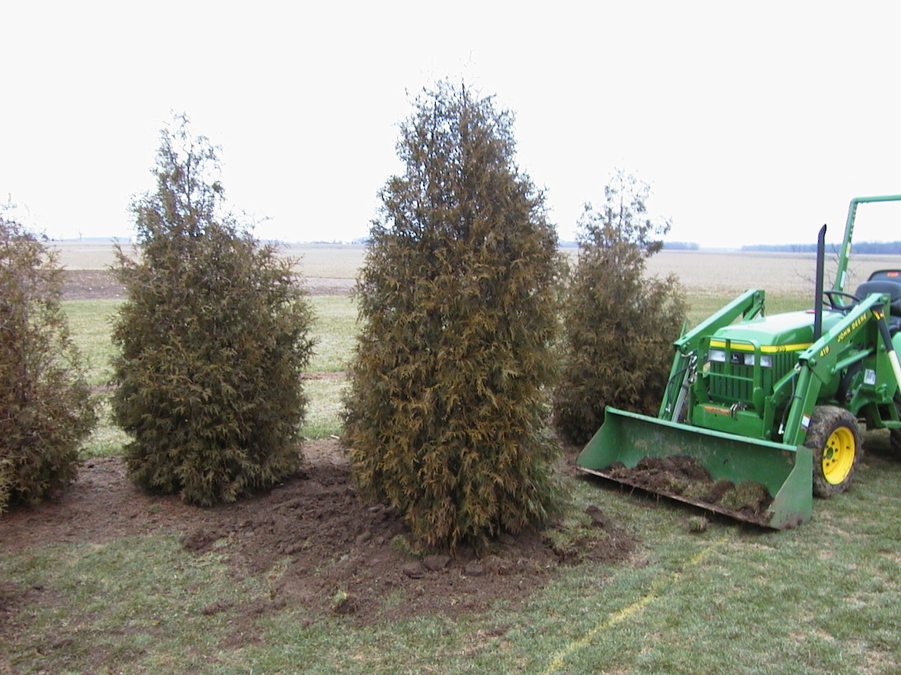

A lot of good advice here. We have lived in windy areas for 30 years--first on a flat bare windy space in Maine and second on a high, flat open part of central Ohio. Either one would blow your hat off on a daily basis. Along the way we've learned some things.
First, I would strengthen the house to withstand, the best it can, the wind. Trees take time to grow.
Second I would plant rows of trees around the house in the three-layer way stated earlier. Norway spruce or other rapid grower against the house line, something else next row and a big bushy row in front of that. Buy seedlings mail order cheap. That will work.
We planted Norway spruce on a 10 ft center, 10-12 ft between rows. While 20 ft is better, I plan to sell every other tree in 15 years for some spending cash for tractor stuff.
In some places around house my first row is northern white cedar (American Arborvitae) because it can grow a 2 - 3 bushy ft per year. Spaced @ 4 ft and sell in 15 years when the other trees get going. These have provided an excellent windbreak and I have 300 around the house. I mail order bare root 4-3 year 3 ft plants from PA nurseries for $2.25 each.
The Norway spruce can grow 3 ft per year in OH so that works. I also planted rows of White spruce and Austrian pine to hedge against a bug disaster. Have 300 total of these
For hardwoods, maple grow fast and sugar maple is a great long-term tree. I mixed a very rapid gowing Silver maple in as a temp tree but will cut down in 15 years because of invasive roots and poor crown.
In short, plant lots of small seedlings, water and fertilize and plant a variety and abundance of things so you can have more rapid overall growth. Thin later. Water is the key the first summer and I have found just better to pot and keep in a 12" pot the first summer and transplant in the fall.
This is what has worked for me. It will take 6 to 8 years to start to see an impact.
As a plus, in 6 or so years you will need a small backhoe to move trees to better places than first thought. You can be busy in the spring for two weeks and have fun while justifying the small TLB.

As a part of my above post, this is a 5 year old transplant Amer Arborvitae from a 4-3 seedling that I just moved with my backhoe.
