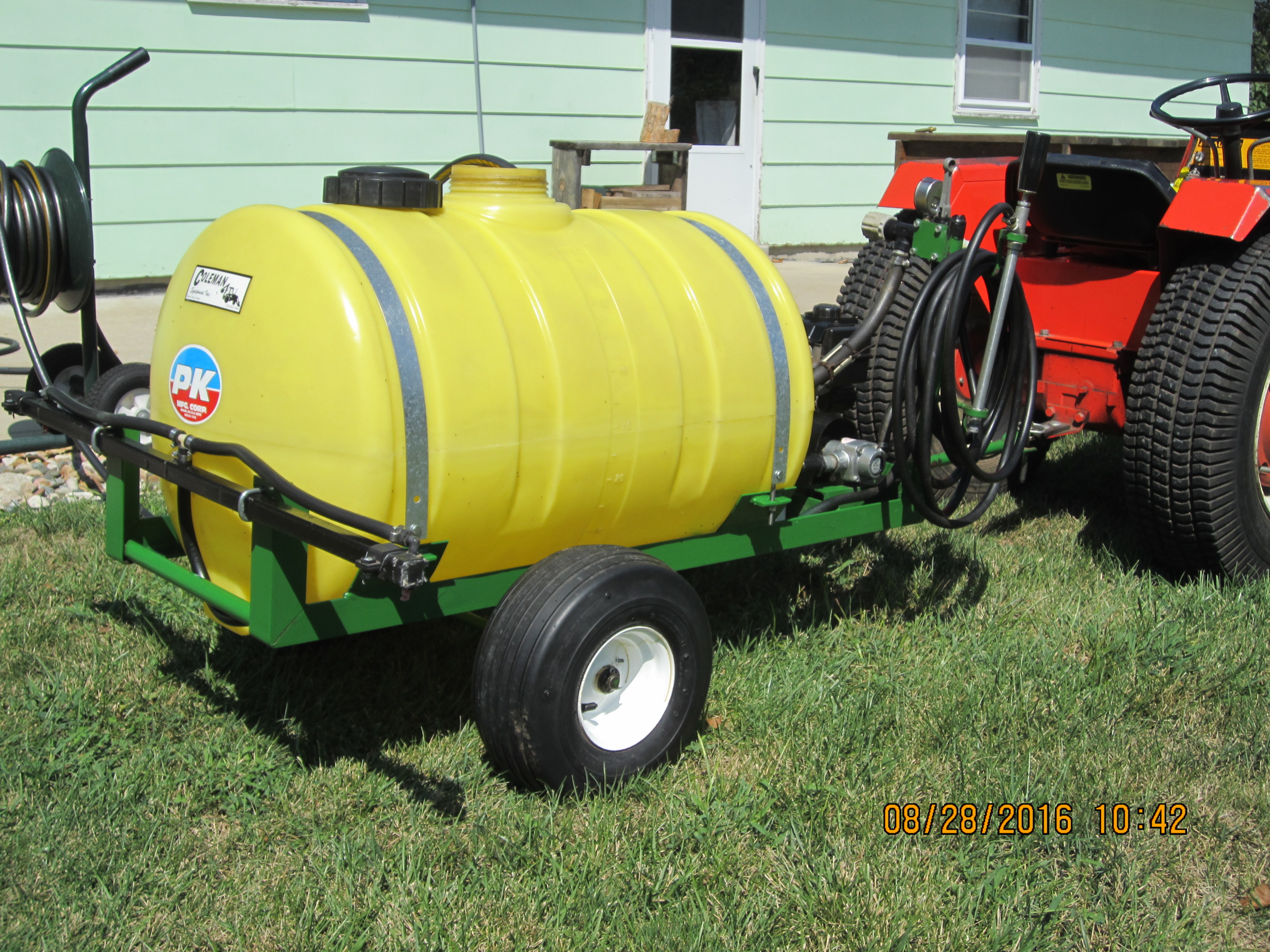

I've been at it for years and keep learning more about it and still trying different approaches. I have found that Trimec and Trimec 899 work real well in my 50 gallon, gasoline powered spray unit. I also note that various weeds do return after a season or two. Often times I use Ortho "Weed B Gone" for spot spraying (two gallon sprayer) over my 3 acres. But, "hey", I'm retired with not a whole lot else to do....sometimes. 005.JPG
Those clover patches are okay and will often return in the same place when sprayed and apparently "dead". A little clover doesn't bother me that much anymore. I do use a lawn fertilizer around the house and sometimes on the rest of the place when I'm flush with cash.:rolleyes:
I generally seed with a broad blade fescue like K-31 or some of the more expensive varieties. Even retired I get out of sync with things when other projects come up. Unlike some of the other posters, I keep the yard looking the best right around the house. ... The open fields I'm not that picky about.
