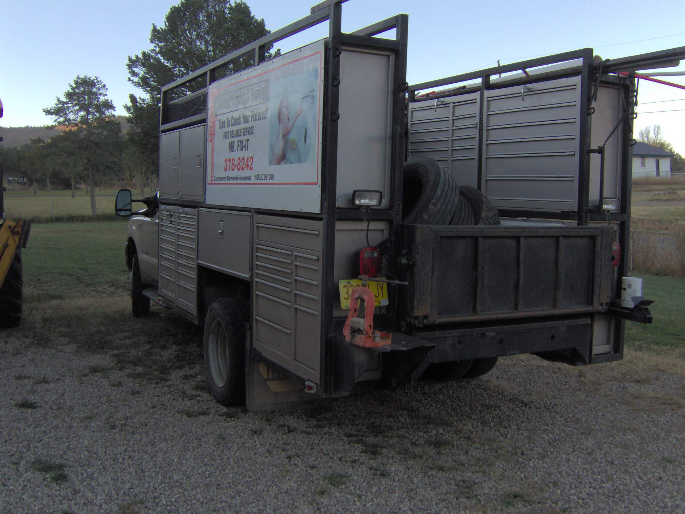

Hope your oven is big enough, that would be my first question. I built the truck body pictured below (tan truck)in late 1998 when Ford came out with the new 4x4 550 trucks. I design built the rear custom body and painted it with good quality automotive stuff. By 2003 I was tired of fighting the frame and had it powdercoated, barely fit in the oven they had but that was 10 years ago and no problems with rust and flaking paint since then. When I built the smaller bed for the 350 (red truck) I sent it to powdercoat before it had a chance to rust.
