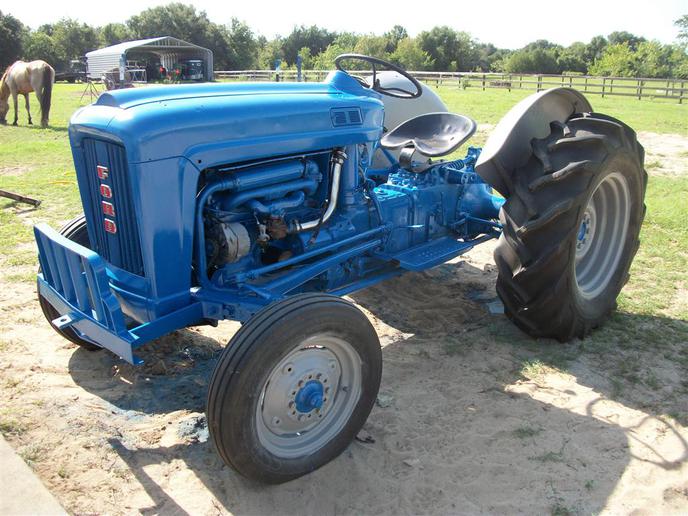

I drove this thing about 12 miles back to my house down some back country dirt roads. It did really good. The only thing I did notice is I had it in high gear (4th) and it would pull up to speed and then the governor would cut it out for a sec, then back up to speed, and over and over. So I guess maybe a new governor is in order? But when she was pulling up a hill it wouldn't cut out just went right on up it. Overall I am extremely pleased with it. There are a few things I need to do, replace wiring, find the right size battery, and go through it from front to back.
sometimes a fuel blockage will cause hunting..

They look just alike!! but color great old tractor
close.. but not exactly.
the 63/64 2000 ( and 4000 ) front sheet metal does not have the round 'cyclops' badge the 53-62 models did.
here's the front shot of my 2000.
soundguy
