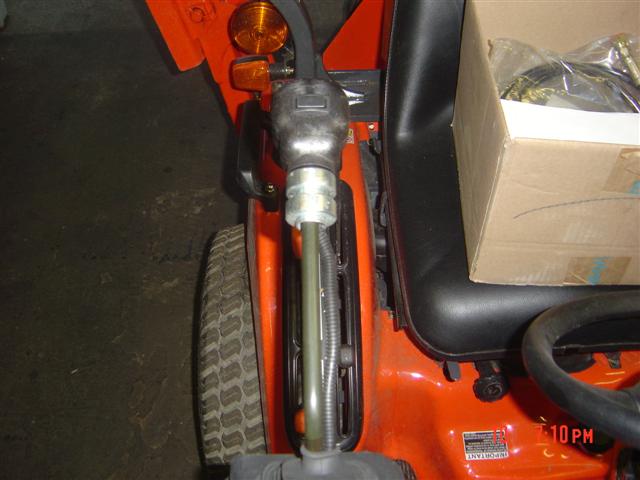

This a shot of the joy stick mounted switch. I like it on top as that is the natural postion of my fingures when using the loader.

nasdaqsam, Looking very good. It appears from the pictures that the diverter valve is stays on the tractor when the loader comes off. That would require a third set of QD's. Is that correct? On the setup I recieved the valve is mounted on the loader arm and the wires are disconnected when removing the loader.
Al

Al,
Yes the valve stays on the tractor, no electrical to unhook.
There are only two sets of QD's. One that connects the grapple to the bucket for removing the grapple from the bucket and one that connects those to the valve.
So in essence, if I leave the grapple hooked to the bucket and just remove the FEL all together there is just one set of QD's to unhook.
