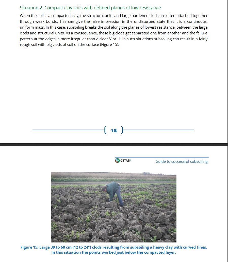

I'm the OP on this and here a couple more pictures of chunks pulled up at 12" to 14". Most of these chunks are 1/4 to 1/2 or a little less than the size of a five gallon bucket. Lets see your sweet corn try to grow through that ground. I still find it hard to believe the compaction that forms in clay ground when I think not much is occurring
Classic example of dense clay subsoiling with parabolic (curved) shank. Dense clay breaking along predetermined paths.
Pages 22-23 fig 15 - in the article.

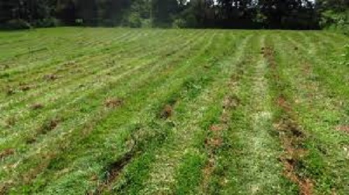

Different parts of the country I'm sure call things different. Around here we would call that ripping or chisel plowing. I got this picture from the sleasynet but this is what we would call subsoiling.
Around 20" deep with very little disturbance to the top of the soil hence the term subsoiling. Yes like you said it's usually done when dry and that cracks the ground better underneath. Tillage or no till, whatever anybody uses, is done afterward.
